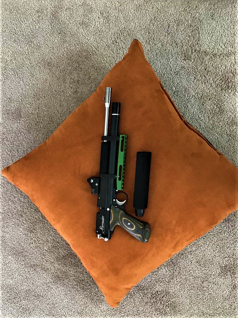

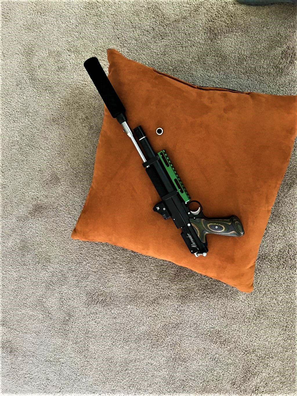

Danke, sir!
With the 1701P/1700 tube, it feels much better and more balanced.

I dunno but a sleeved LDC looks cooler and protects it from bangs.
It also seems more hushed but probably I am just imagining things, lol!
Well, it may indeed be lesser in noise with the sleeve installed because foam is a sound-deadening material 😬

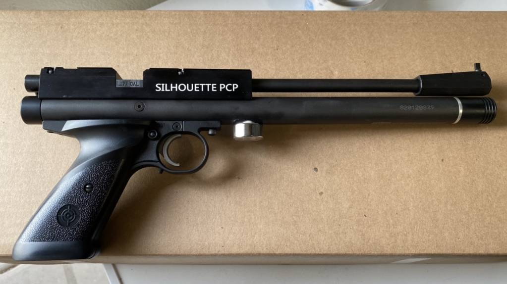

Does the 1701p front sight just knock off with a wood block? Got one used coming, so just starting this process. Wanting to use a thinner slip on moderator like the TKO, or one from Geo, his can be removed and reinstalled without damage, no barbs. Going to try & make some grips, ha, we'll see.
Blast it with a heat gun or hair blower first it you can’t twist it.

It’s held in place with a grub screw. Slips right off.
