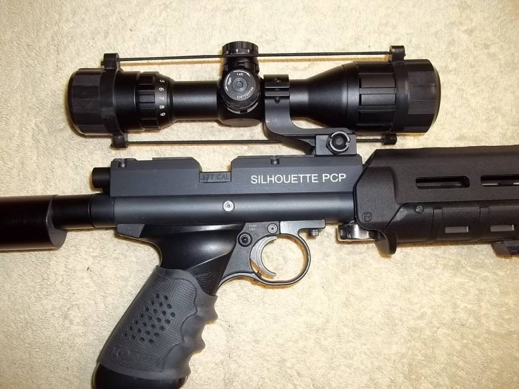

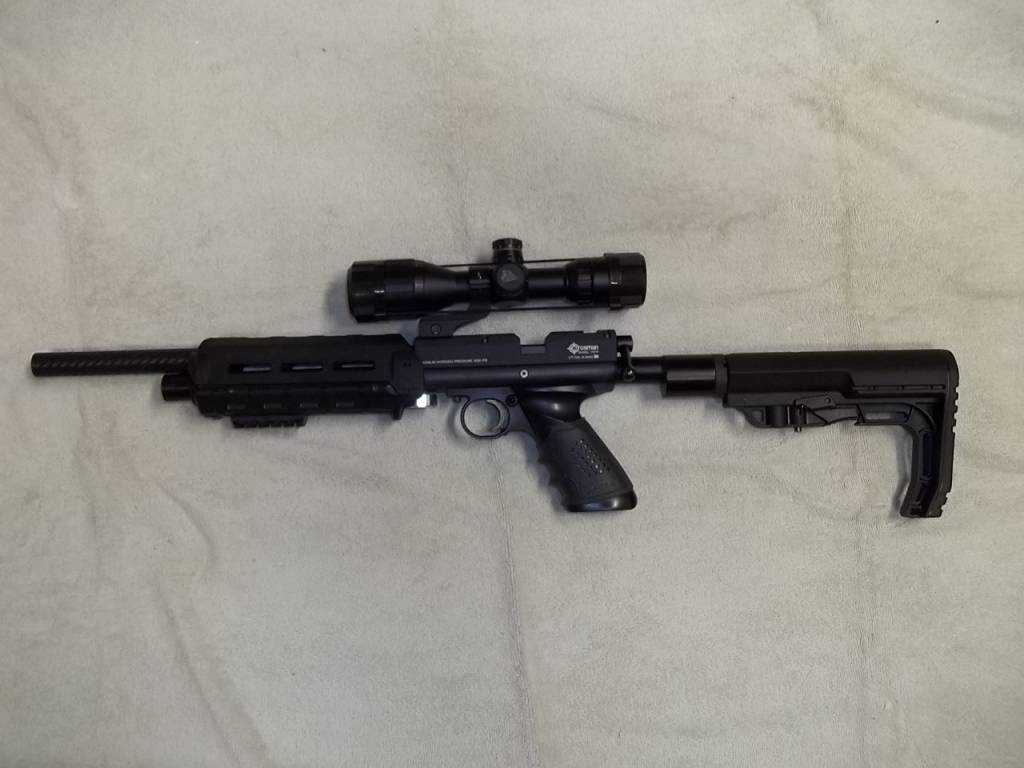

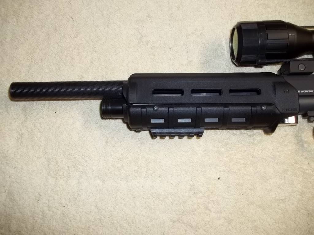

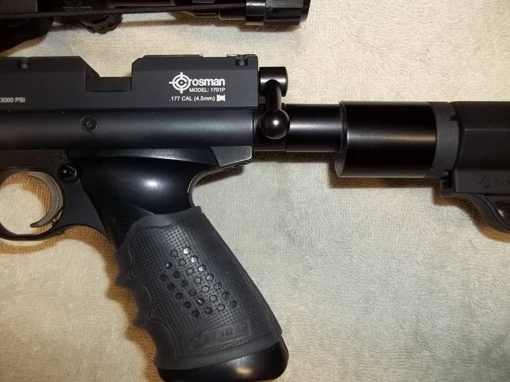

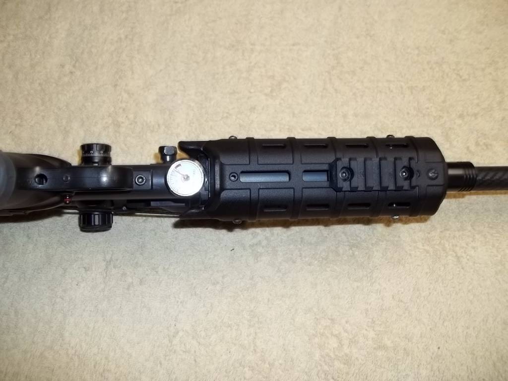

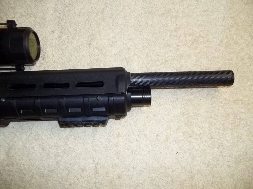

Got into my Crosman and other parts and decided to put this carbine together.
TP has been drilled out .079 other items added and installed
Air Gun Universe moderator (really quiets it down)
Magpul MOE forend
UTG 3-9 X32 mil dot scope
Boom stick slip on finger groove hand grip
AR Stock adapter
MFT adjustable butt stock
This is the result of a little effort
Works great for me and I still have another 1701P as a pistol
