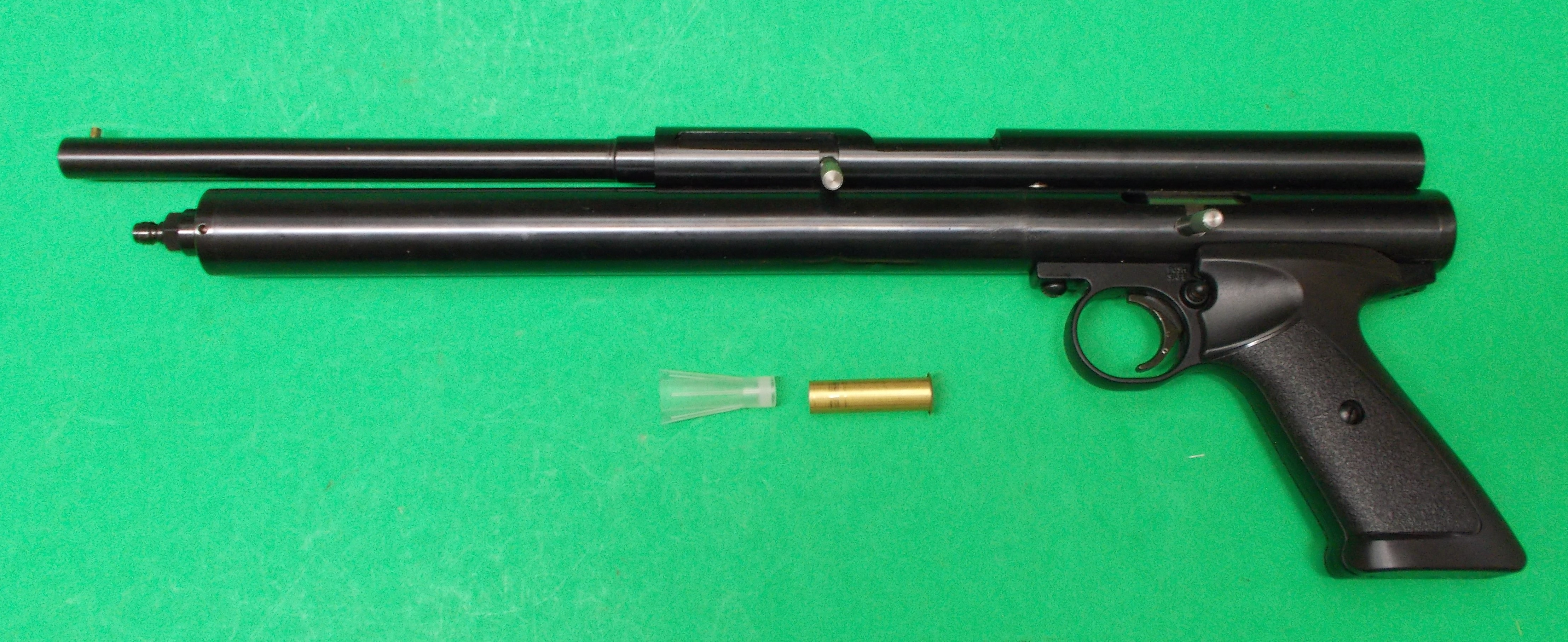

I am going to be in possession of this Quackenbush 410 pistol and wondering if anyone has a how to, tips and tricks on how to load the shells?

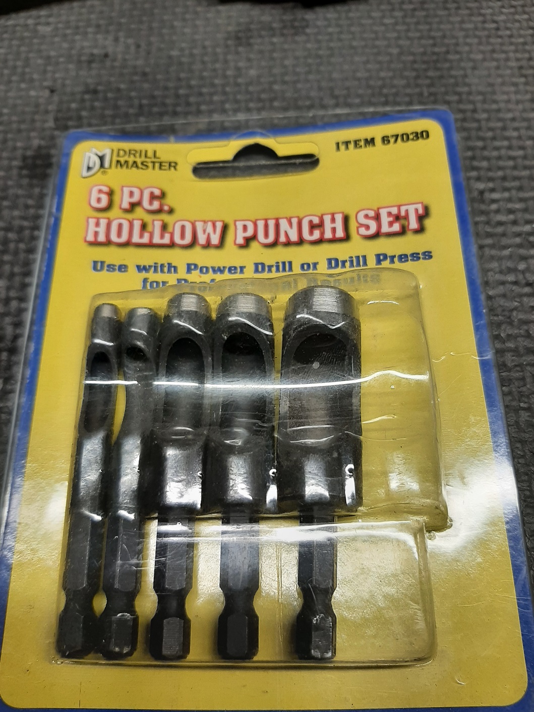

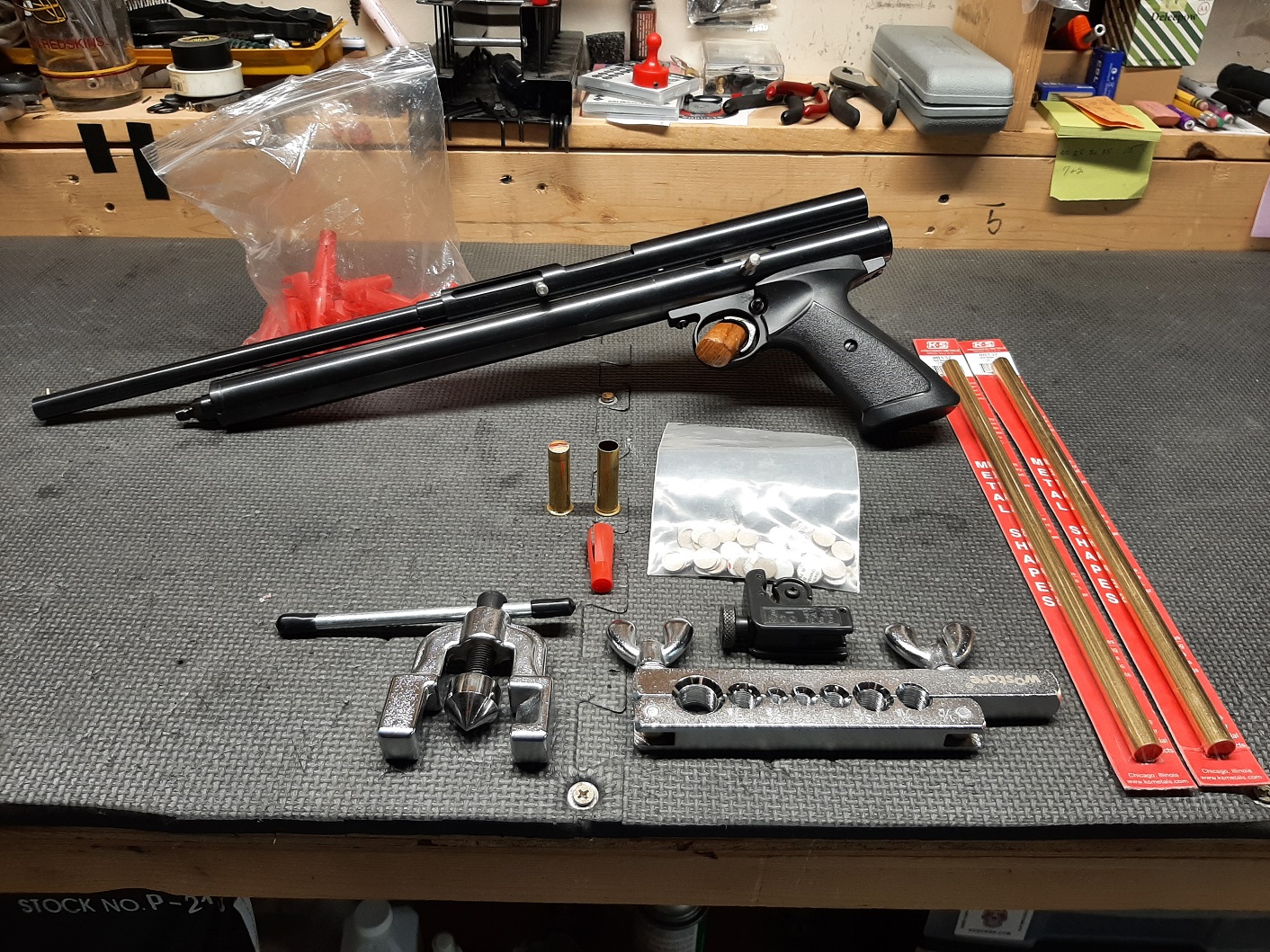

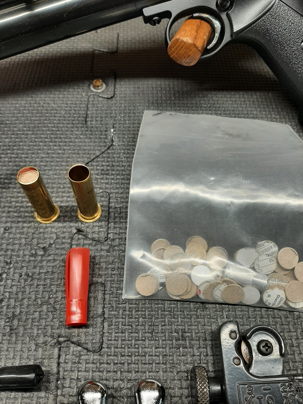

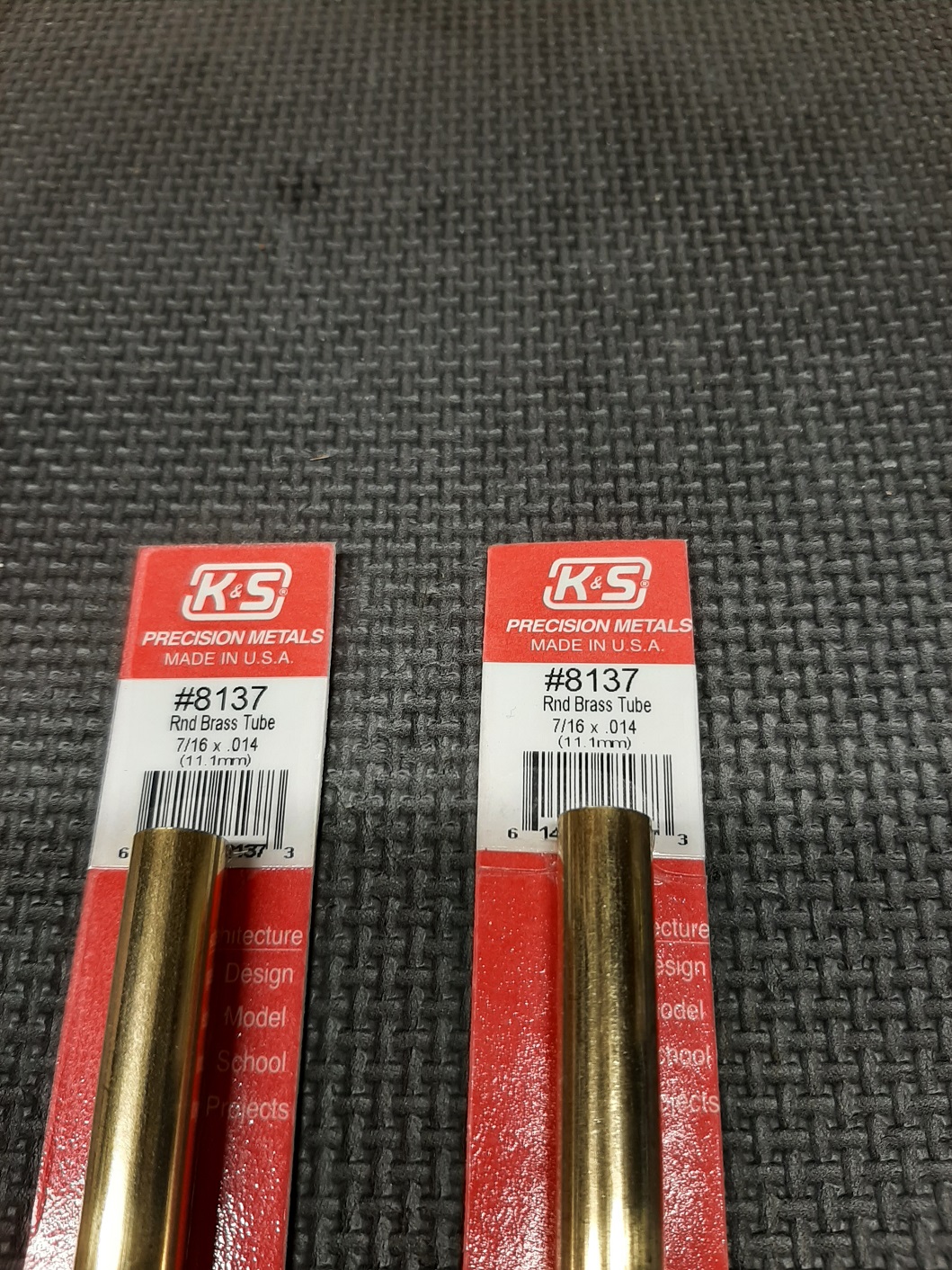

Hey everyone finally had time to get things together for the Quackenbush 410 pistol here's a picture my pistol and everything needed to make your own shotshells. The brass tube are the size needed to make the shotshell hull from Ace Hardware I measured the length of hull and added a little for the base put it in the tubing flaring tool and flared the end to match Dennis's hull. The bag with the white discs are made from a cereal box for the overshot wad using the hole cutting tool in the package from Habor Freight the way I did it was put the proper size cutter in my drill put the card board on a 1x4 board and cut them out. If you have any questions PM me your phone number and I can explain it a little better maybe.

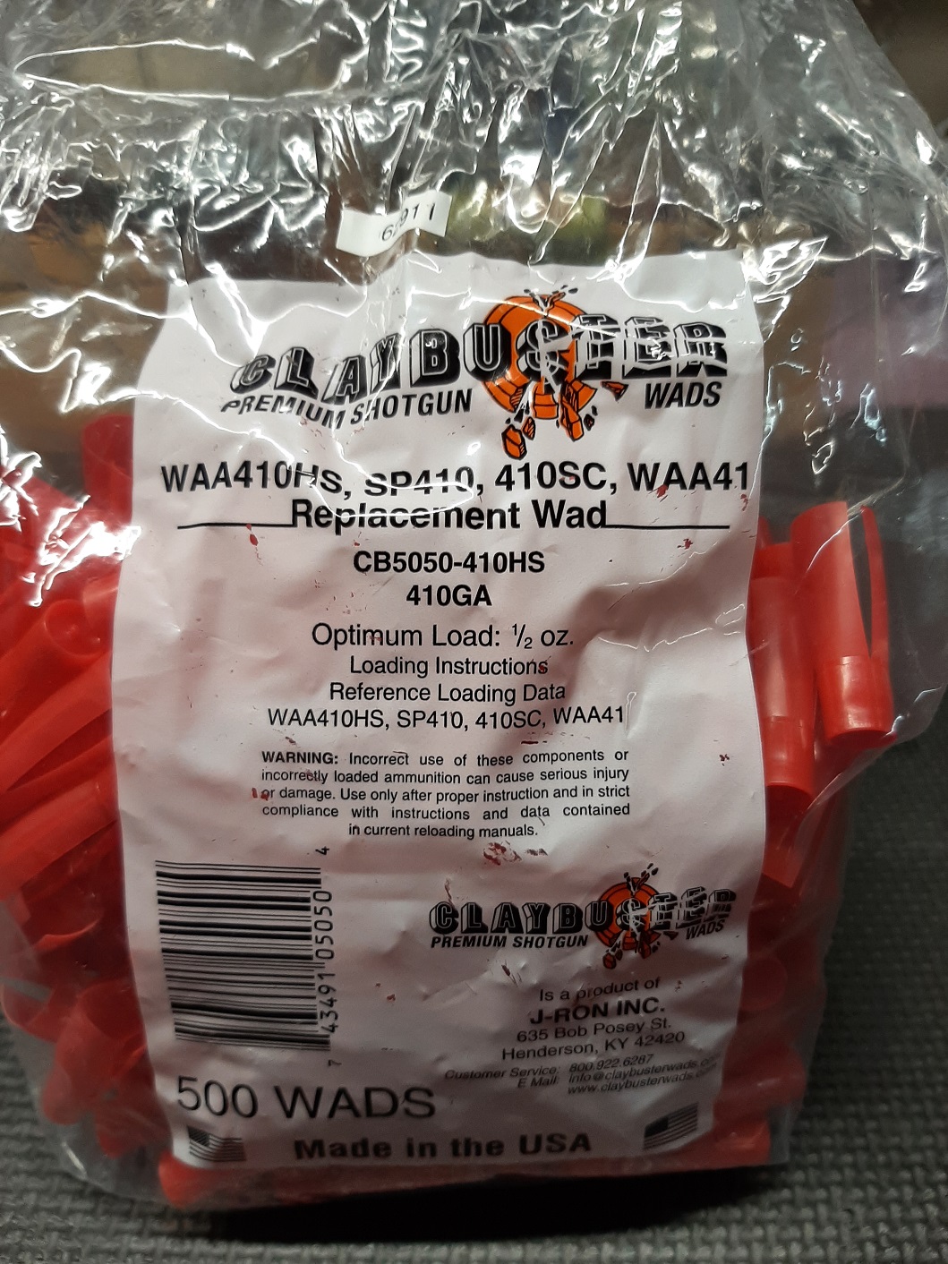

The wads I'm using are from Schells best price I found here's a pic.
