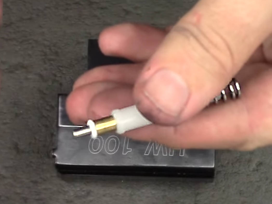

From the second video above it looks like the valve stem o-ring is Teflon. You can see the white O-ring that gets put on to the stem on the left side of the valve. Here's a screenshot I took from the video. If this is indeed the factory condition, then it has been determined that Teflon is best for this particular part and application. Kind of makes sense as the valve stem moves and rubs with each shot and reducing friction here would help shot consistency.
