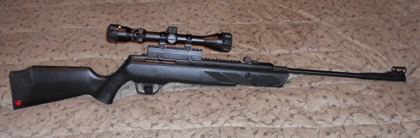

I ended up buying a Ruger Air Hawk Elite II at the local Wally World. $106 out the door.
Fired 2 rounds through it and 22 rifle cracking and smoke. Going to tear her down and see what's she is made of.
Will post up a complete review (already found some stuff). Hopefully it will be at least entertaining to see this thing inside.

I always get a bad one it seems. Was willing to give this Ruger Airhawk Elite II a chance but what a bad example. It had so much china mystery grease it was awful. Umm.. I will come clean.. I did tear her down. And inside was a TORN piston seal. In addition to that were some very horrible sharp edges (more than likely what sliced the piston seal on assembly). I thought there was hope but put the piston and seal back in carefully and it was indeed leaking down. When I pushed the piston down while sealing up the front air port the air just SWISHED out from the piston area. No bounce back up at all. re-assembled it and boxed her back up. Piston was crude also with pits. The nitro tube looked rather cheap made also, being very light compared to the Crosman I have(which won't shoot well). Compression tube itself was okay-ish. It did look like the little piece up front that engages the detent ball was cock-eyed a little also. It wasn't square.
So this one looked nice from the outside but inside nothing was good at all. I'm not real sure how that plastic sight rail would have worked out anyway. It is not attached to anything but the stock really and just slides over the compression tube/receiver.
Do I feel bad about taking it apart and now going to return it to Wally World?? H- NO. I rarely return anything but in this case it is a definite yes.
If the piston seal would have been okay and not leaked down I'd have kept it. I tried another piston seal in it but soon found out it was too small.
By the way,
The inside diameter of this one was 1.010" The seal on the air rifle was .994 and that did not count the torn lip that obliterated the lip edge causing the seal problem.Barrel rifling looked good, crown looked good. Trigger was iffy but might could have been worked on.

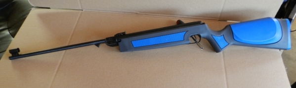

Check out the CZ/Slavia 634. It's no powerhouse, does about 725 fps with JSB 8.4s. It has some quirks but the accuracy is there. Comes in a butt-ugly black and blue plastic stock, has really nice metal open sights. It has a barrel latch for a more positive lock up. Trigger is not bad IF you pull it with safety on, then release safety and take your shot. I got mine for $109 shipped from Hinterland Outfitters in Texas. It has a very boingy shot cycle, but I'm finding it easy to shoot accurately.
