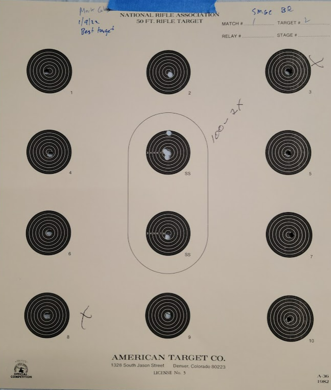

So I owned this rifle a little over a year....shot one 25yard indoor BR match with it at Sherwood Airgunners. It shot three 250 cards for a 750 total score. I'd say it's pretty accurate 😉

Just shot this yesterday with mine using unsorted pellets. Of course I had to blow one shot.
Nice. Seeing that target makes me miss the HFT, and the cold weather gives me the itch to get back in the BR game. My best target, indoor at 50 ft...so close to 5x with Eley Tenex (love the clean holes). Did just as well the the JSB 8.44's.

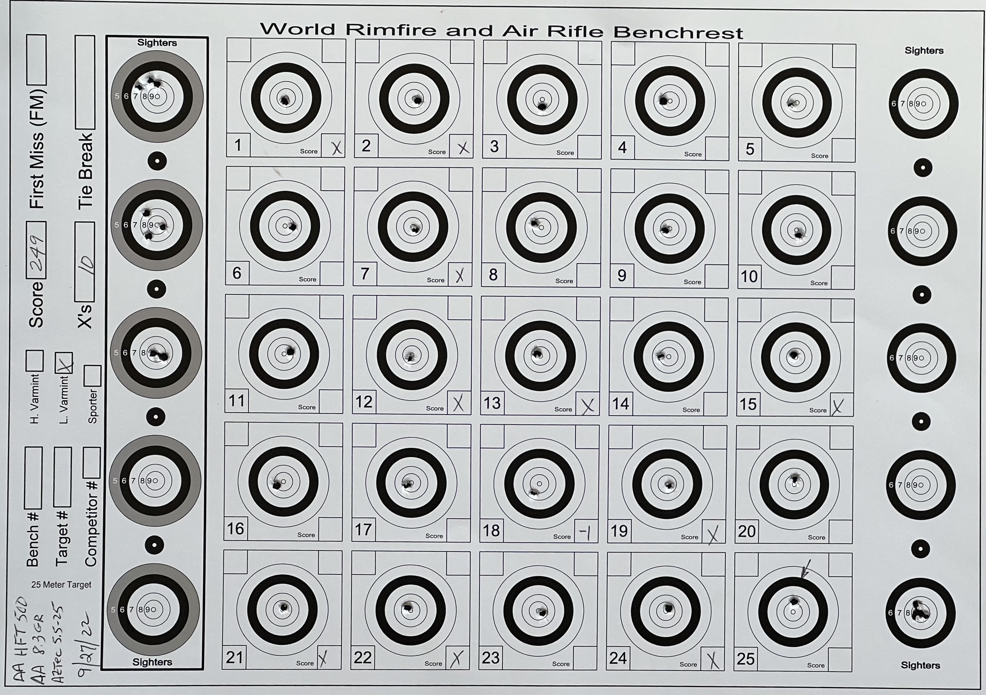

I am looking for the most accurate .177 caliber PCP rifle for benchrest target shooting at 25 and 50 yards. My FX Crown MK II .177 shooting MRD 13.43gr will shoot MOA at both 25 and 50 yards. I am wondering if there is a rifle that will shoot a lighter pellet as well as the Crown.
Tell me what you have that meets these specifications:
1) You must now own the rifle
2) Shoots 10.5 gr pellets or lighter
3) Able to shoot 10 out of 10 shots MOA at either 25 yards or 50 yards ( see attached target )
4) The rifle must have a mechanical trigger and can be fired from the shoulder ( no electric triggers )
5) Is it factory stock with just regular adjustable tuning
6) If it has been modified please explain
If you have a rifle that meets all of the above I would appreciate you sharing the information and any photos.
