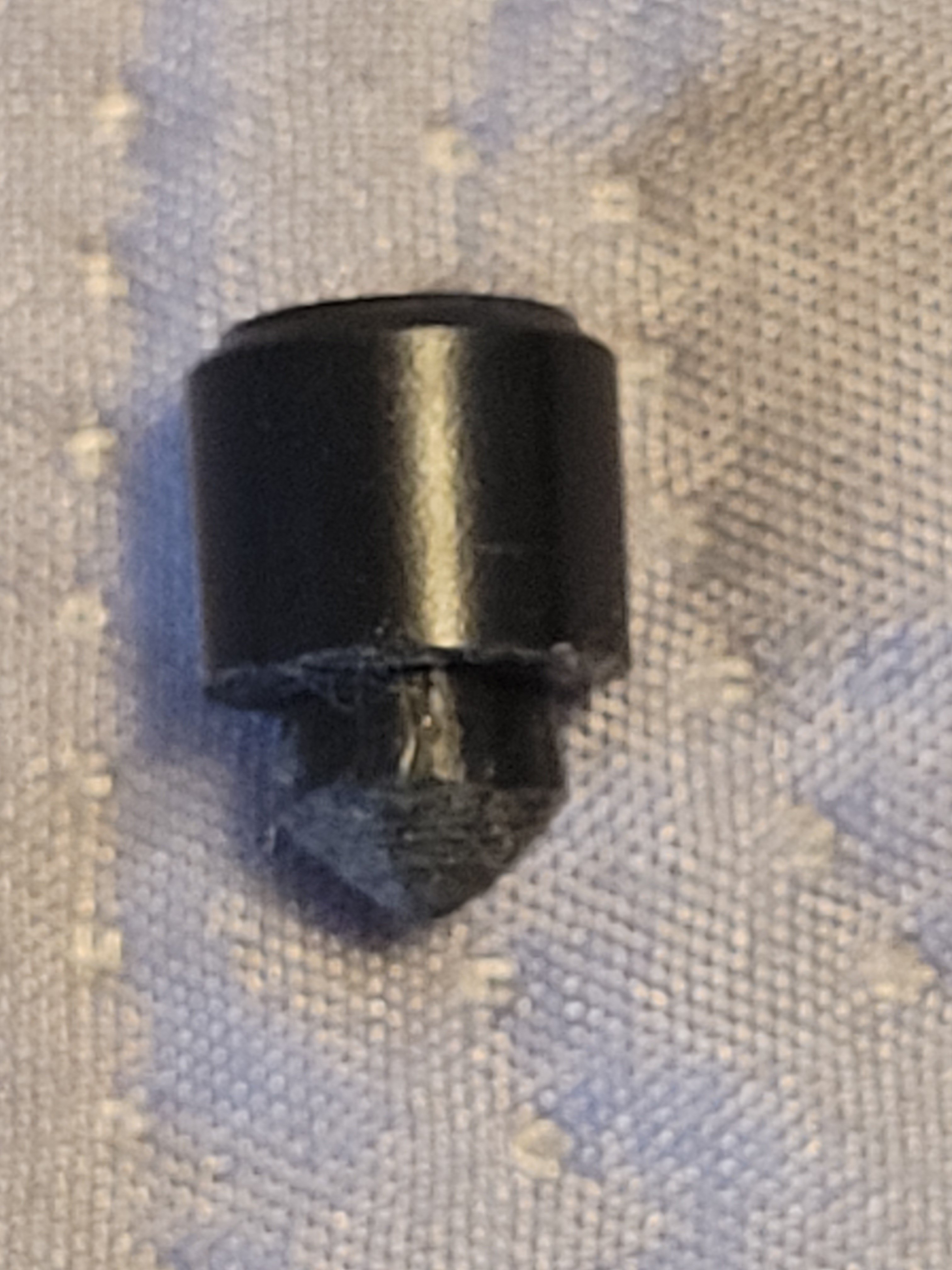

This could be your problem. Call Air fforce for replacement
"I pumped it back up again, but without releasing that pressure valve at the back up the pump, I am unable to disconnect the tank from the pump, either at the quick disconnect coupling, or by unscrewing the Air force Adaptor from the tank itself."

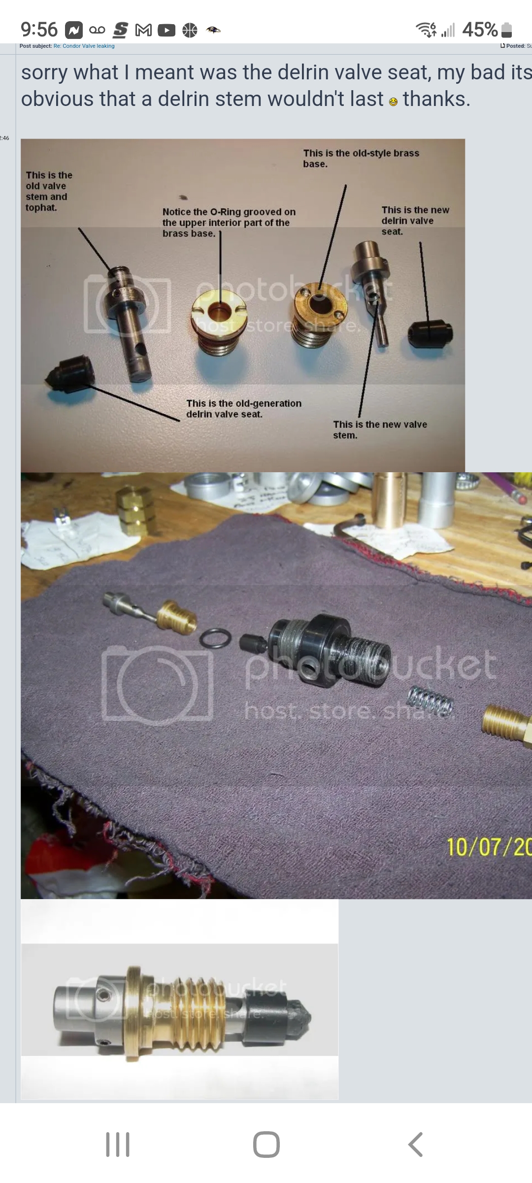

Good! Do NOT even try unhooking any pcp under pressure, so many bad things that can happen.
For what ever reason your valve is stuck open, BLEED & remove. Might ( umm , how old?) be just crud in there and cleaning would fix it right up. Maybe abit more likely the valve-stem- is shot and you need a new one.
As you have an older model do be certain to get the correct valve.
