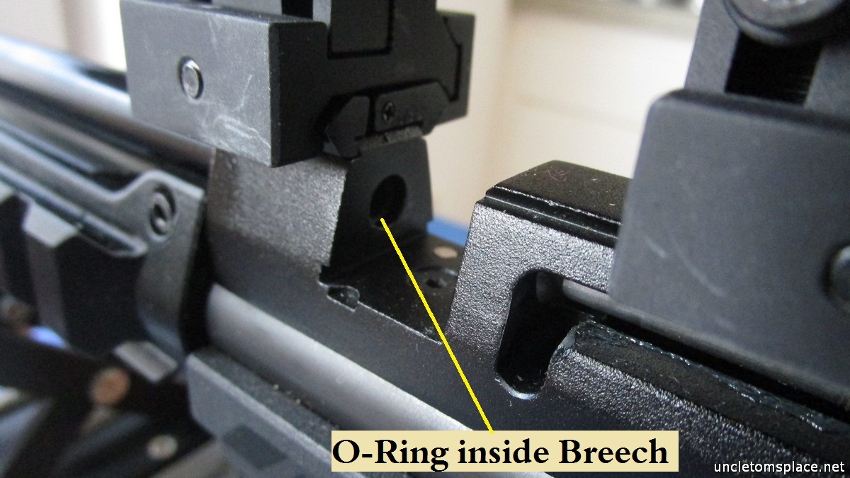

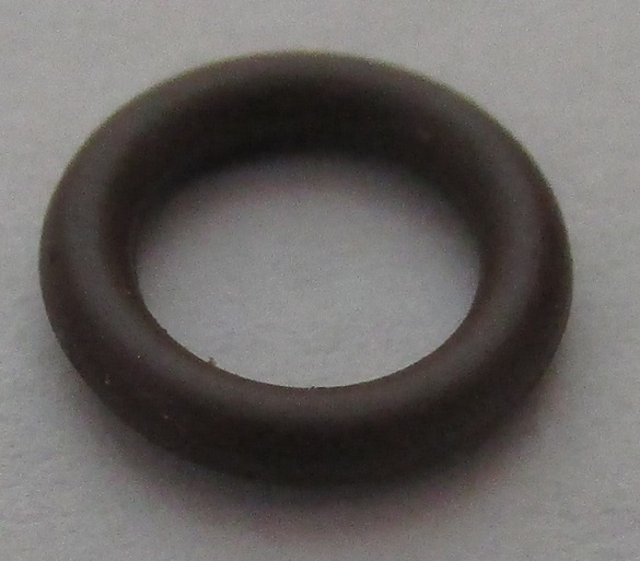

This is the O-Ring that fits in the Breech End of the Barrel that the Probe pushes the pellet into the Barrel. The color is NOT black but more of a Brown-ish color. See photo of one out of my Pistol.

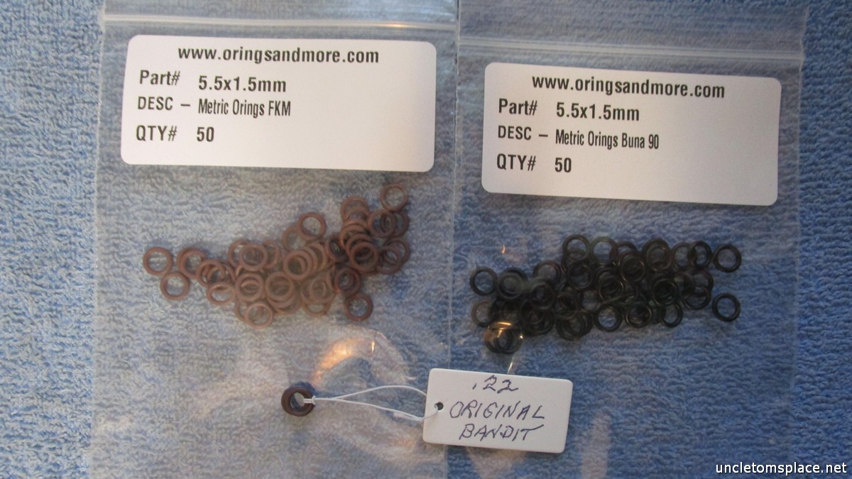

The closest that I can find on ORings and More is:
FKM Heat Resistant O-rings
5.5mm ID x 8.5mm OD x 1.5mm C/S
Also known as JIS S6
75 Durometer Rubber FKM O-rings
A general purpose FKM (Fluorocarbon Elastomer) compound suitable for applications requiring resistance to high temperatures and compression set. Outstanding resistance to blended aromatic fuels and straight aromatics as well as halogenated hydrocarbons. Good resistance to strong acids and steam. Temperature range -20° to 400°F (-29° to 204°C).
Color Brown
