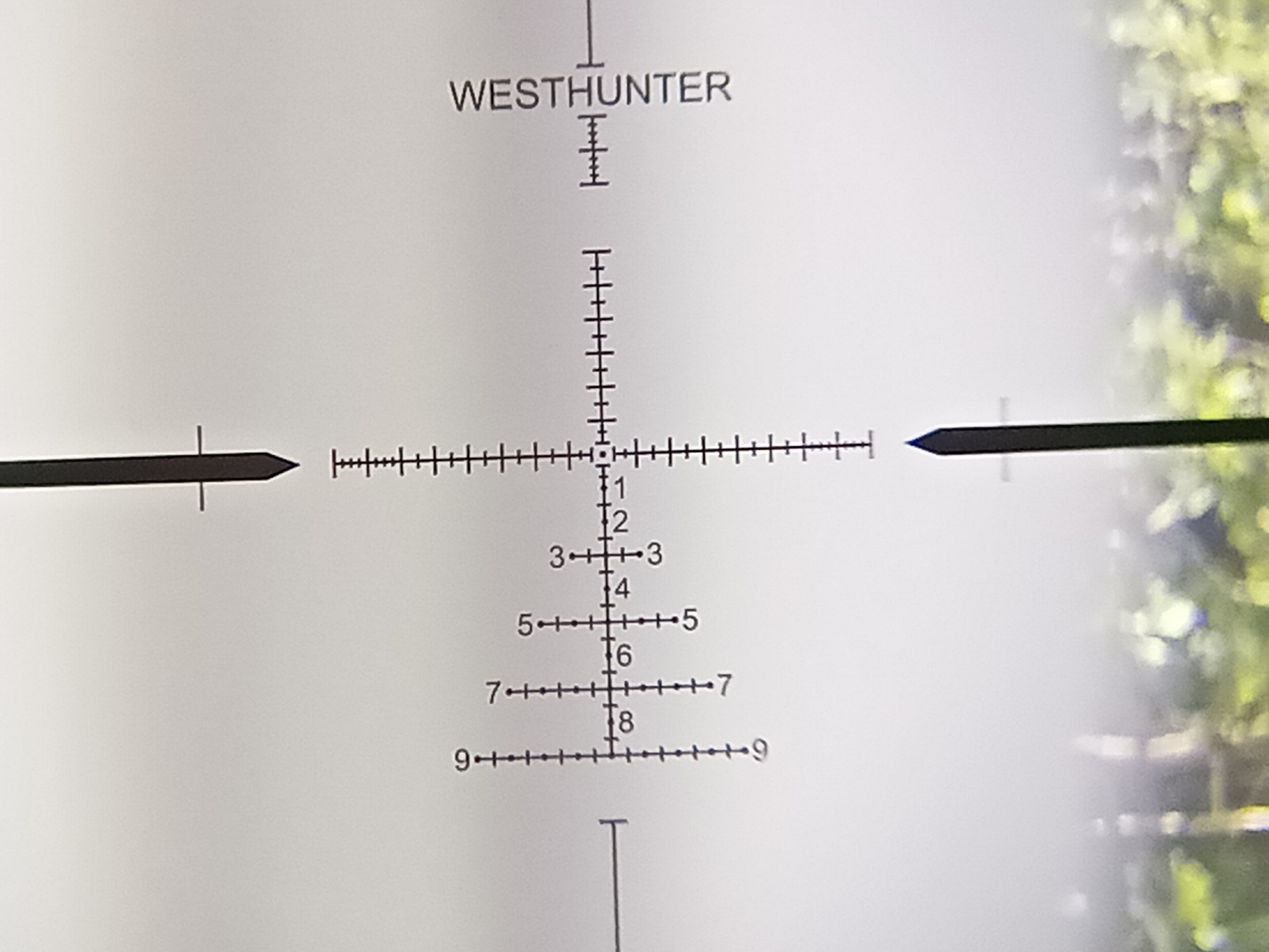

I spent a ton of time from about age 8 to 18 looking through 4x Tasco Pronghorn scopes with a simple duplex reticle on a Marlin rimfire. Even what is a relatively "clean" reticle by today's standards feels pretty busy to me after the simple scopes of my youth. The really serious Christmas Tree reticles that I've looked through made me feel like I was only getting half a scope, since 50% of everything is obscured by all the junk.
I can see the reason for all the windage lines, just not my cup of tea. I've made some awfully long shots on pdogs with low fpe guns and holdover, without the trash in my field of view. I'm not sure I could even see some of the pdogs hiding behind all the lines if I went to a true Christmas tree reticle scope.

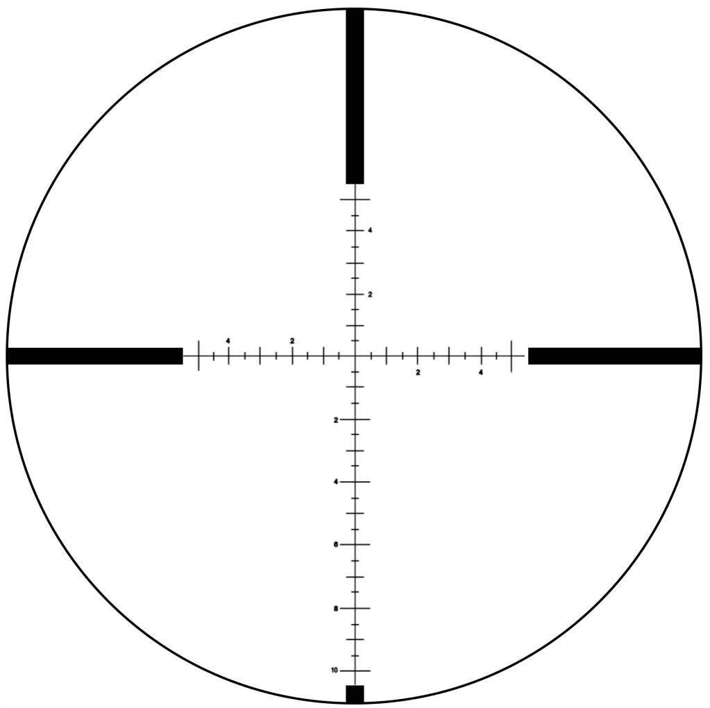

I usually prefer dialing my turrets, it's a tad slower, and two tads more precise.
And I video my shots through the scope, so I'd prefer to have a reticle a little less cluttered.
The one below (Falcon 3-18x50 FFP) is my favorite.

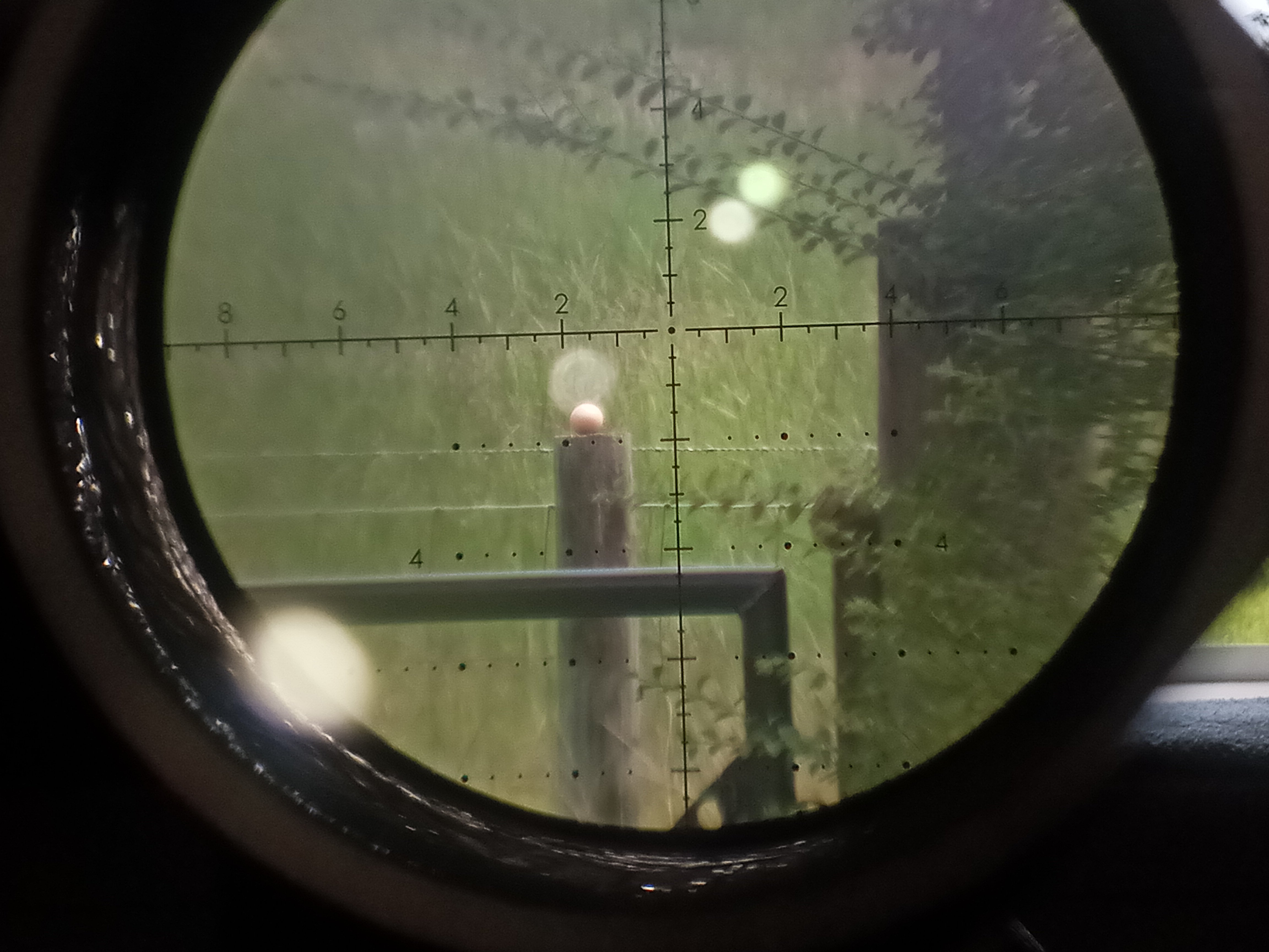

im pretty new to them but from what ive seen depends on the scope .. in a lower power scope with smaller objective the clutter can obscure target aquisition ... these are crappy photos but you can see how the more spread out reticle is much 'finer' and will obscure a small target less on the 24x 50obj than the 12x 40obj ..

I understand(and have used) the "small" dirty reticles like the Aztec in @L.Leon's post(or the 3 or 4 holdover lines on a Hawk AMX reticle), but the larger Christmas tree style reticles(that go down to 10 mils or so) just seem like clutter.
I guess my point is that if shooting conditions(wind, distance, etc...) are such that you have to use THAT MUCH hold over and hold off away from center, the shot will probably be "just a poke" and maybe shouldn't be taken. And, if you ARE just taking a "poke" shot or trying to "walk" your shots, the dirty reticle may obscure your view of the impacts that you need to make adjustments. Plus that fact that most of these type shots would be taken at longer distance requiring higher power magnification that most of the dirty reticle would be out of the field of view(if using a FFP scope). Also, the part of the dirty reticle that IS in the FOV at high magnification could mainly be used just for bracketing(dots too far apart to provide useful aimpoints). Both of which are demonstrated in the 1st pic in @dizzum's post.
