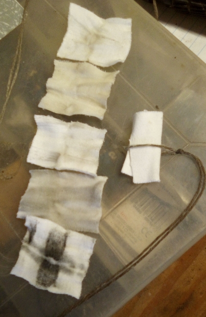

For .177 i just use a strong nylon harness / sail thread and make my own " patch worm"
With that i can use brass wool, scotch Brite pad, patches .. thing is use strong cord, or thread.. you DONT want thins to snap 1/2 way in the barrel ( believe it! )
