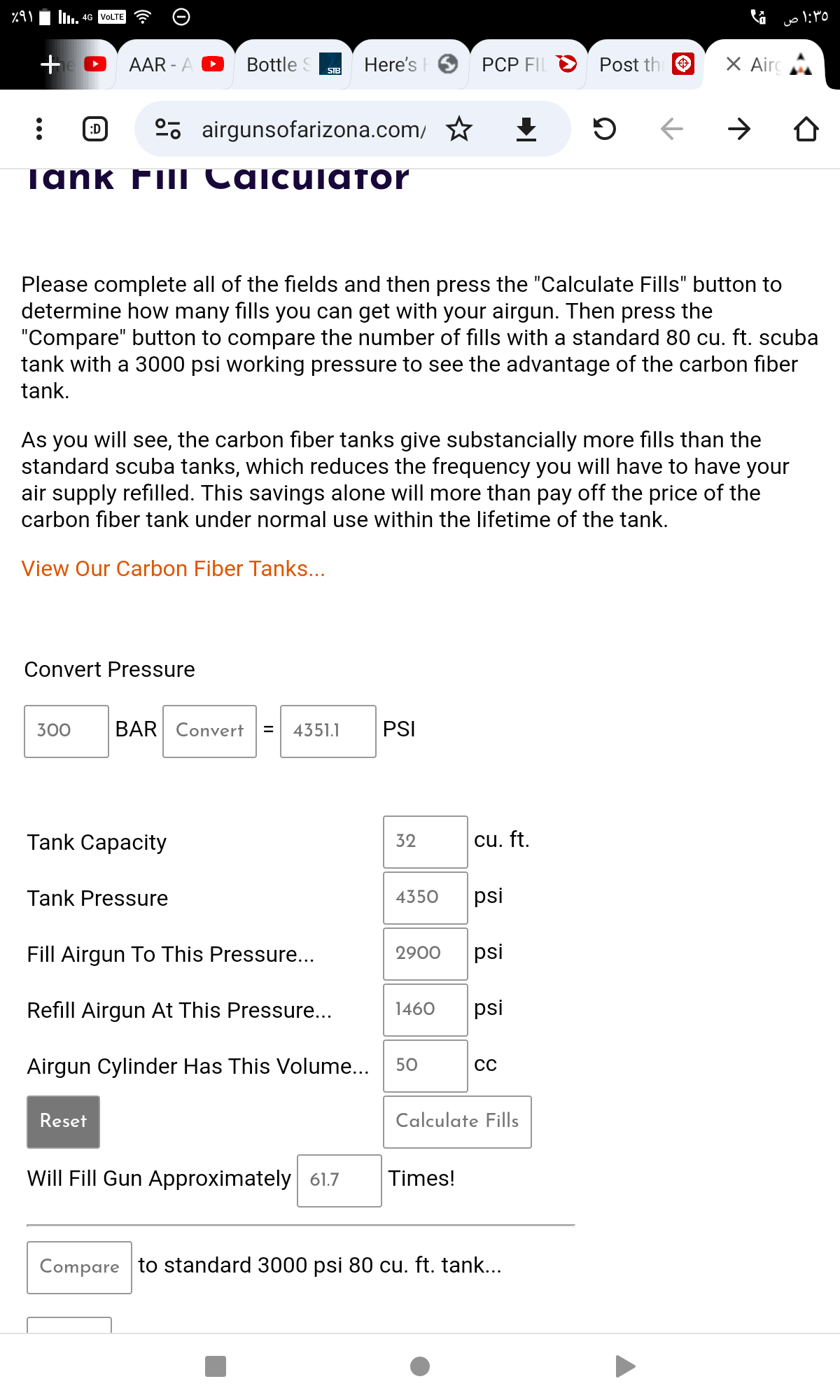

I am asking because I found this website for tank fill calculator
As equation I found in other forum to convert the cu.ft to liter
(Multiply the litres you want by 4351 by 0.03666 then divide by 14.7)
So in my case let say I want 3 liter scuba tank
[3*4351*0.03666/14.7 ]= 32cu.ft
So the results is 61 fill times from 3 liter300bar scuba tank !! Is this right or there's something missing??

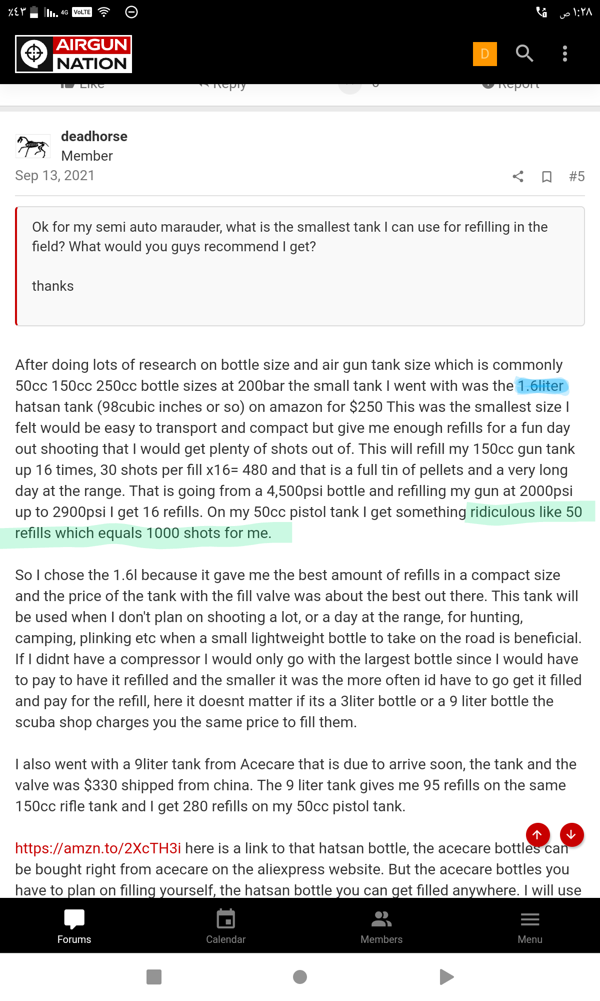

This guy has 1.6 L tank fill from 2000-3000 psi 50 refills !!! So that make sense to 3 L tank fill from 1450 to 3000psi 60 refills what you think about that

He got 16 fills for his 150cc gun, which would translate/extrapolate to 48~ on his 50cc, as he said "something like 50" which sounds like he rounded.
Nonetheless, yes that seems about right, 50~ fills for a 50cc from 2000-3000 from a 1.6L filled to 4500.
Using AoA's fill calculator they say around 80 fills for a 45CF tank going from 1450 to 3000 with 4500 tank pressure. My personal calculator I built says closer to 72.

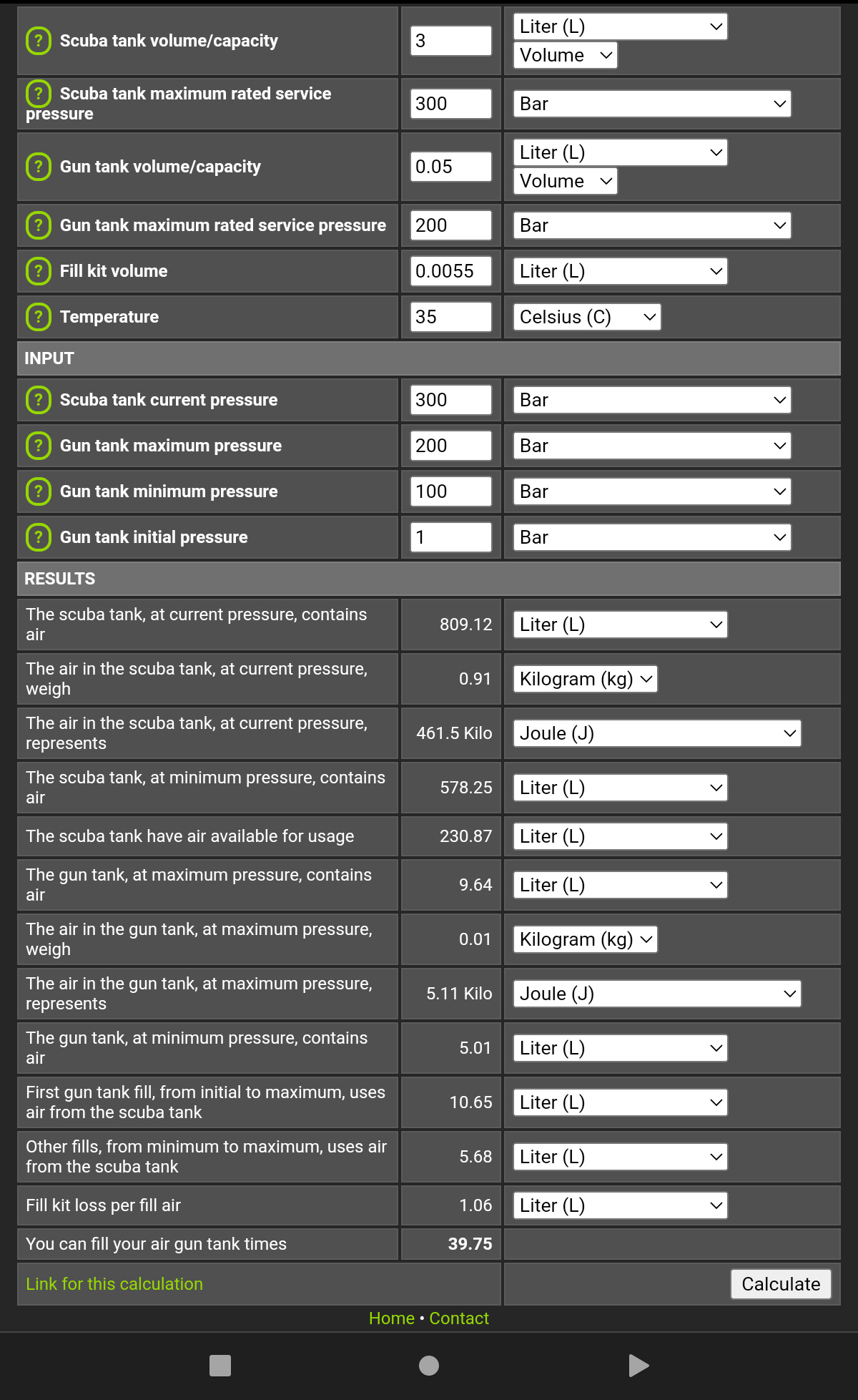

Hello sir yes I saw this calculator earlier today surprised the inventor himself reply my topic that is pleasure 🙂🙂
Yeah that's my inputs to your calculator
I like the idea of adding air loose during bleed the air (am I right?) I assumed the air loose during bleed %10 which is 5cc (0.005L) of tank capacity 50cc(0.05L) and fill my gun from 100bar ( before yellow line) to the end of green (200bar)
So this is my result for 3L scuba tank about 40 fills!!! That's very impressive
