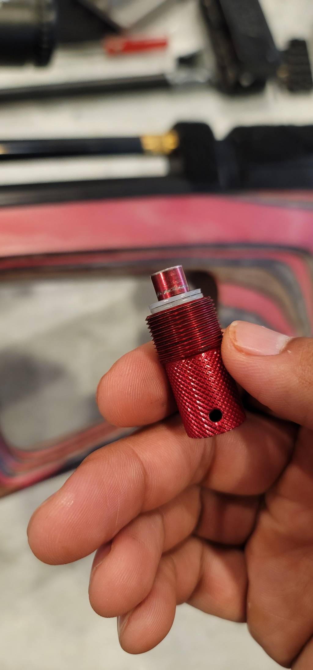

Yep, I broke valve after valve using heavier hammer springs (or just higher reg pressure). I started making "indestructible" valve systems thereafter and I've never broken another since.
Gino, you're likely stomping on that fpe gas pedal harder than anybody running the Vets. Your input here was the nail in the coffin for my already hesitant thoughts about going to the heavy hammer spring. I've seen your various posts here and on Insta about machining Vet valve systems and I suspected they were necessary for upped regs and heavier hammer springs.
