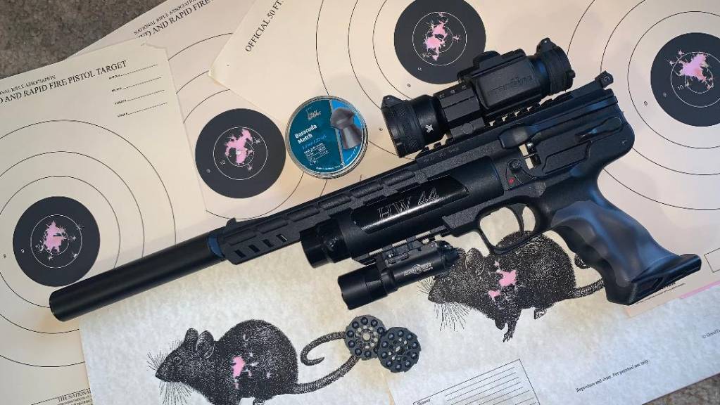

5 shots at 25 yards with red dot scope

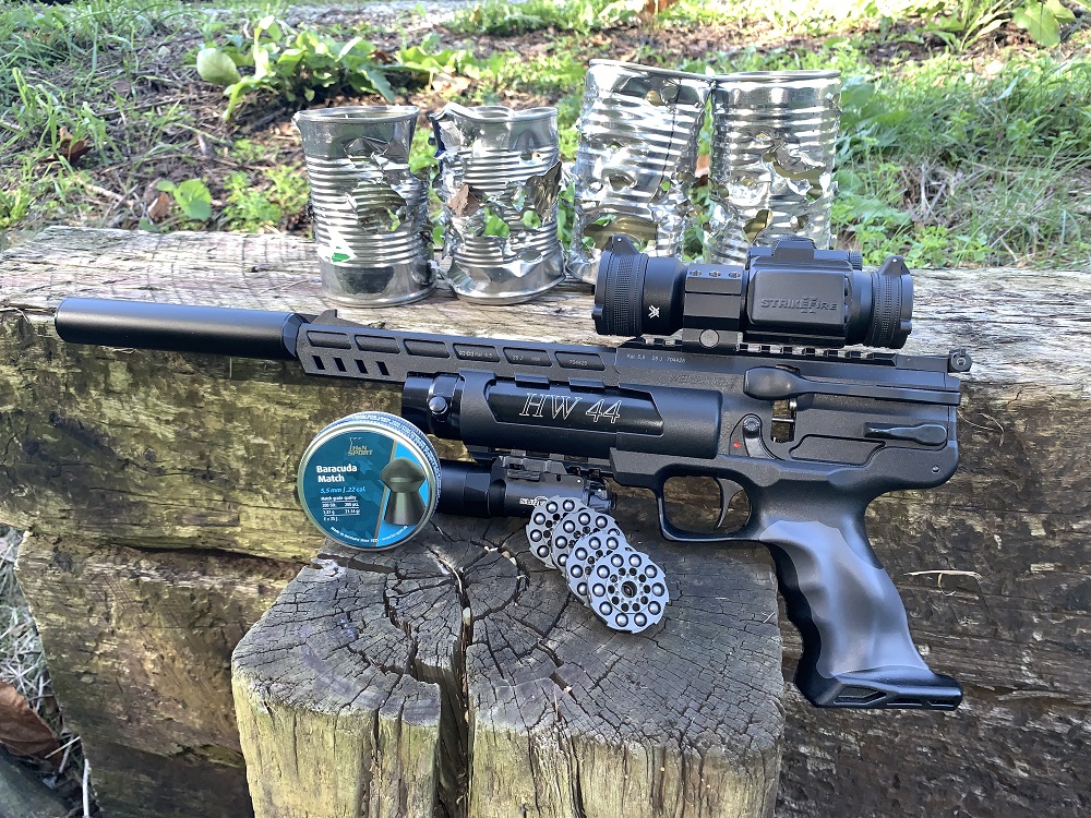

At 50 yards, I have to aim the pistol about 6 inches high. These soup cans were perforated with ease from the bench at 50 yards.

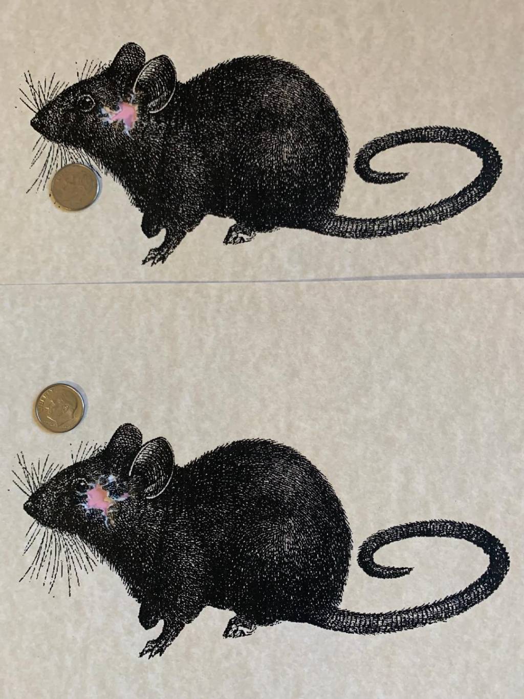

These targets were shot at 10 yards. The upper target was shot with the first 20 rounds and the bottom target with the last 20 rounds on a single charge.

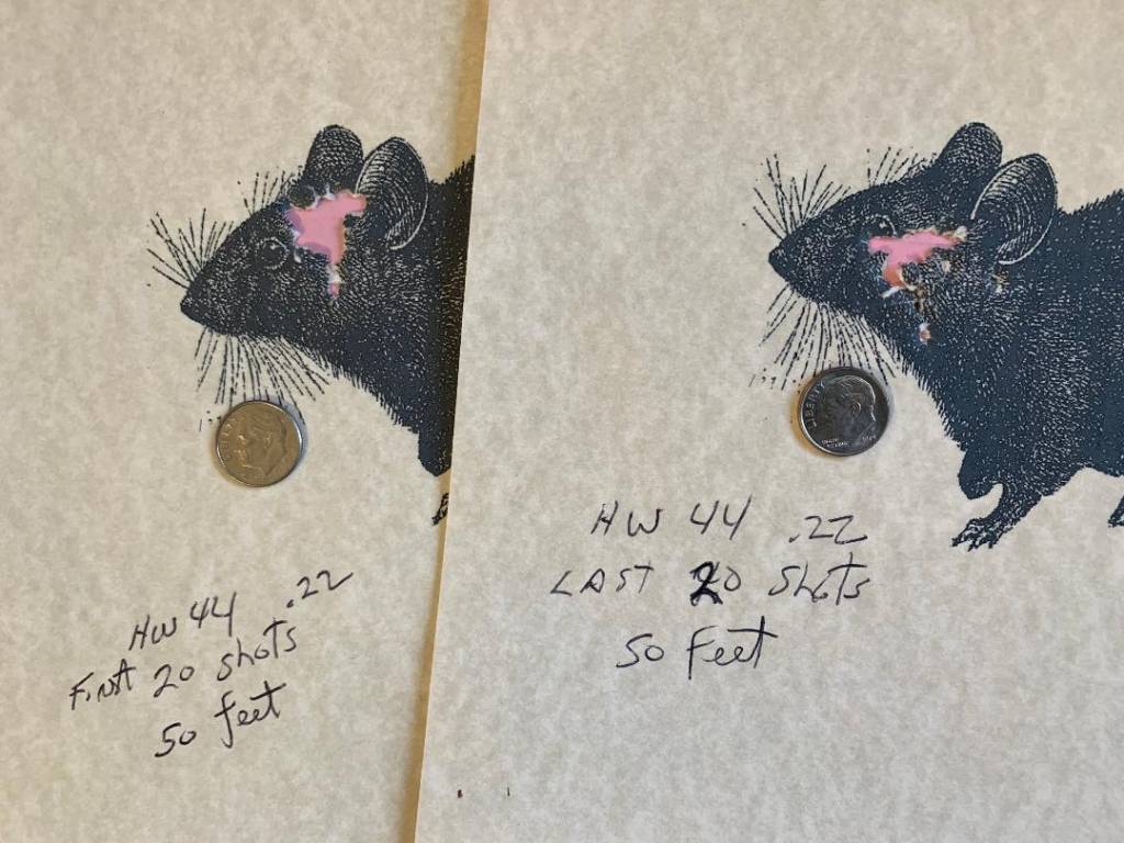

These two targets were shot at 50 feet (16.7 yards) with 40 shots on a single charge. For the left target, my point of aim was center of the rat's head. So you can see that the pellet, is indeed, impacting .3 inches high. I lowered my point of impact on the right target so that the bottom edge of the 4 MOA dot was aligned with the bottom of the rat's chin.
