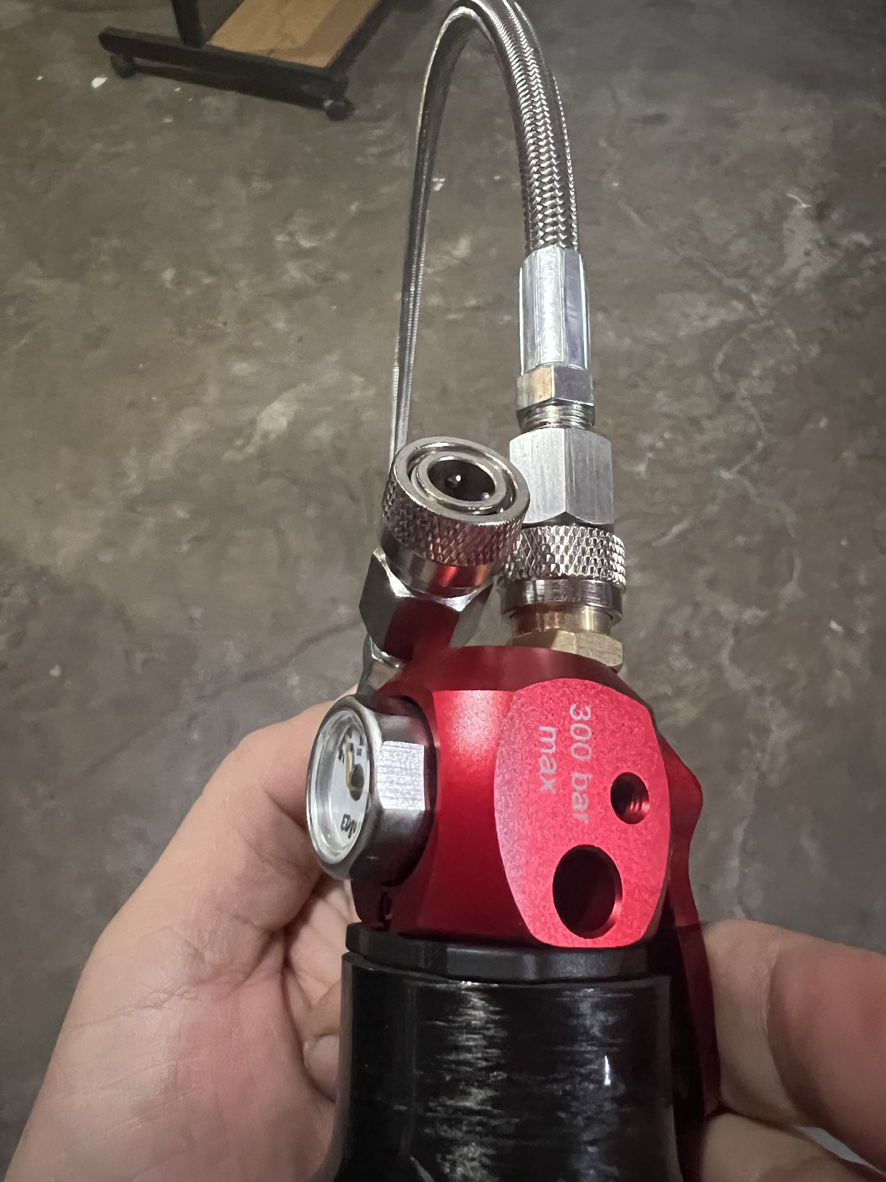

Why can't you just use a male-to-male foster from Peazy to a fill hose?
There was a video online when it first came out saying to connect it directly and not use a hose. I’m guessing the Peazy valve was t designed to hold that pressure so kind of defeats the purpose. Also the guy that sold me the package said the Peazy and hose cannot be used together.
I believe it's because the fill line does not have a bleed valve. My guess is that the pressure will release when you release the foster adapter. I will try it with mine and let you know.
Reactions: Scouty
Worked fine.
