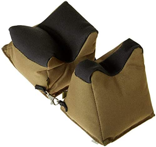

Back to my original question, which maybe wasn't super clear. I'd like to shoot (non-kneeling or standing lanes) using the deadman position ("indian style", "criss-cross-applesauce"), balancing something like one of these on top of my forward knee to support the rifle's forend (bag is 3-4" tall):
Scotchmo says it is legal. Do other concur?
Todd

In the free position lanes, I use the “deadman” position in both Hunter and Open Divisions. When needed, I’ll use my 2” thick pad between my knee and rifle, or between my knee and leg. I’ve been doing it for years. In Open Division, there is no 2” thick limitation, so you are good to go with your 3-4” tall pad.
