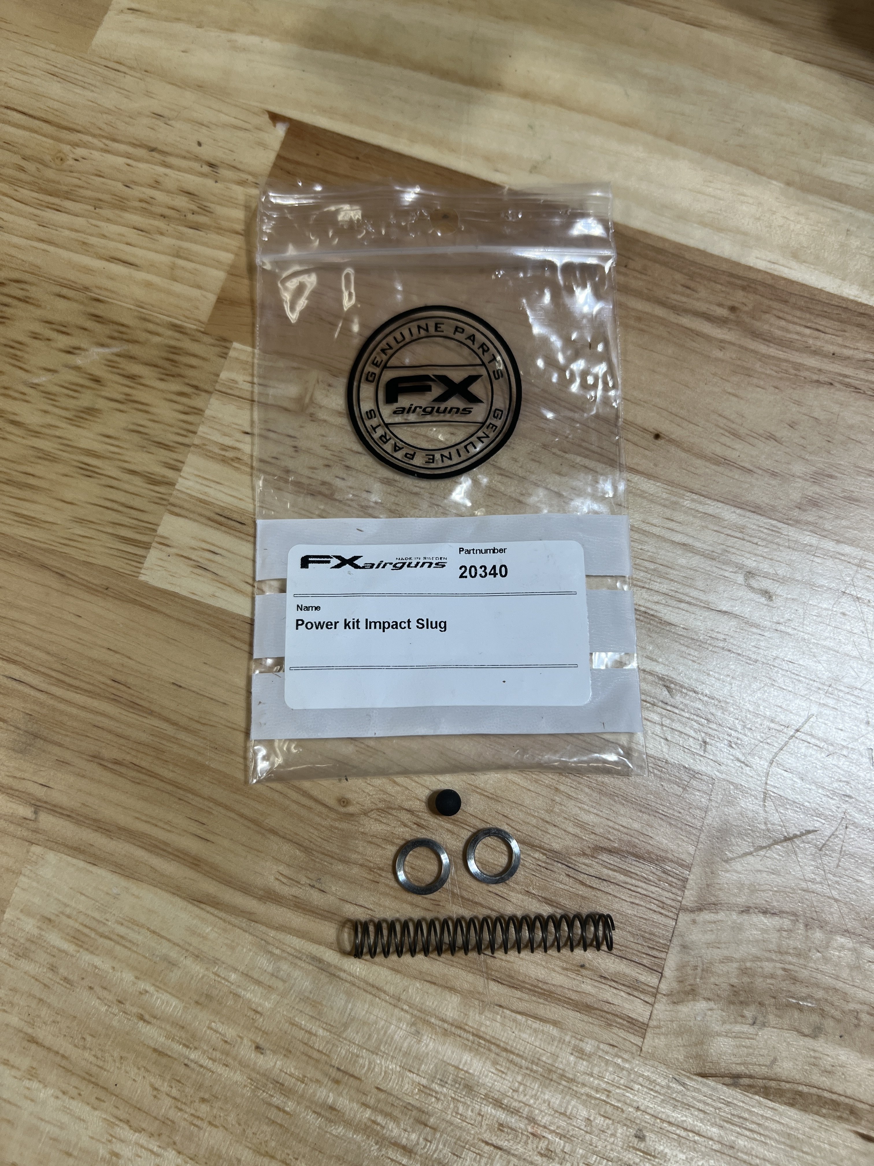

I ordered a 1/16 twist slug liner with a carbon fiber sleeve and the slug power kit. I’m trying to get better accuracy with Nielsen 33.6 grain slugs…the stock liner is just not accurate enough with them. I’m not trying to get any crazy speed , I’m just after better accuracy.
My question is , should I install the slug kit or try it with just the different liner? I’ve read several posts about not needing the slug power kit. I’m thinking just install the new probe with the liner…????

Thanks for the replies.....Got the new liner etc. this evening. I installed the liner and carbon fiber sleeve, did not bond it, there was a red mark on the end of the liner and I installed it at 12.00 position. I did install the new pin probe but didn't install the hammer parts and spring as I wanted to try it without it. I used my same tune I had with the stock liner, shot it through the chronograph and it's shooting the 25 cal. 33.6 Nielsen slugs at 985 fps. with the second reg at 120 bar, I deleted the first reg awhile back , it's a 700 mm. liner. It was almost dark by the time I got it back together, I set up a target with a light at 50 yards on my range, took 5 shots and dialed in the scope. I then shot two mags. 50 shots at a 1" target dot......here's a pic of the target I shot with it. .....this new liner with the new probe definitely made a difference with these slugs...:)

Looks like you already have this sorted, but for future reference the slug kit hammer weight is way too heavy. For most people using normal-high reg settings the hammer weight is almost double what you actually need. I am running 150-155Bar on my Impact and only have a Huma hammer spring and slightly heavier hammer weight. The FX tungsten weight is more for people running like 170-190Bar.
Thanks for the info…..there must be different slug kits they are selling, this kit I got has Two small spacers that are put on the factory spring guide that stiffens the hammer spring and add a little extra weight along with a lighter valve spring and the adjustable pin probe, it didn’t have a new hammer weight. I only installed the new probe from the kit.
There has been several renditions of the slug kits. Some dont have the tungsten weight, some have steel weights etc.
That's what I thought as this kit didn't have a tungsten weight. I wasn't looking to get the max speed, I just wanted to get the slugs shooting accurate as the stock liner just would not shoot them accurate enough for me. The tune I had with the stock liner, I was getting average 960 fps after installing the new probe with the new liner I picked up 25 fps....I'm shooting it now with the exact same settings as I had before and it's doing 985 fps . I must have hit the FX Lottery with this new liner as it's Awesome accurate now....:)
