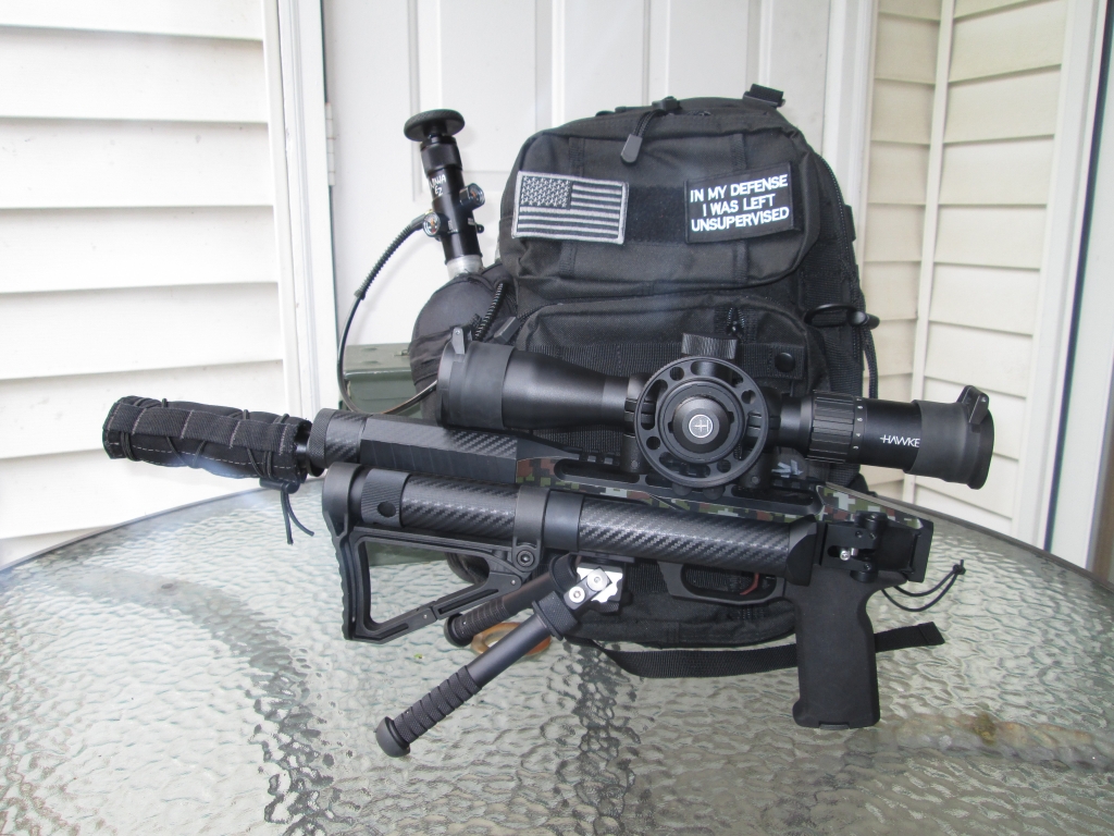

My 90ci 4500PSI Ninja tank fits in the 1 quart water container pocket on the side of my Allen Tactical Bag...
Same bottle and mine is still in the neoprene cover...
If you have a molle type backpack get a quart size water container holder, that should fit your bottle, I believe I seen even larger separate MOLLE type water container pockets too on amazon etc, mine is built into the bag...
just my .02
Ken
