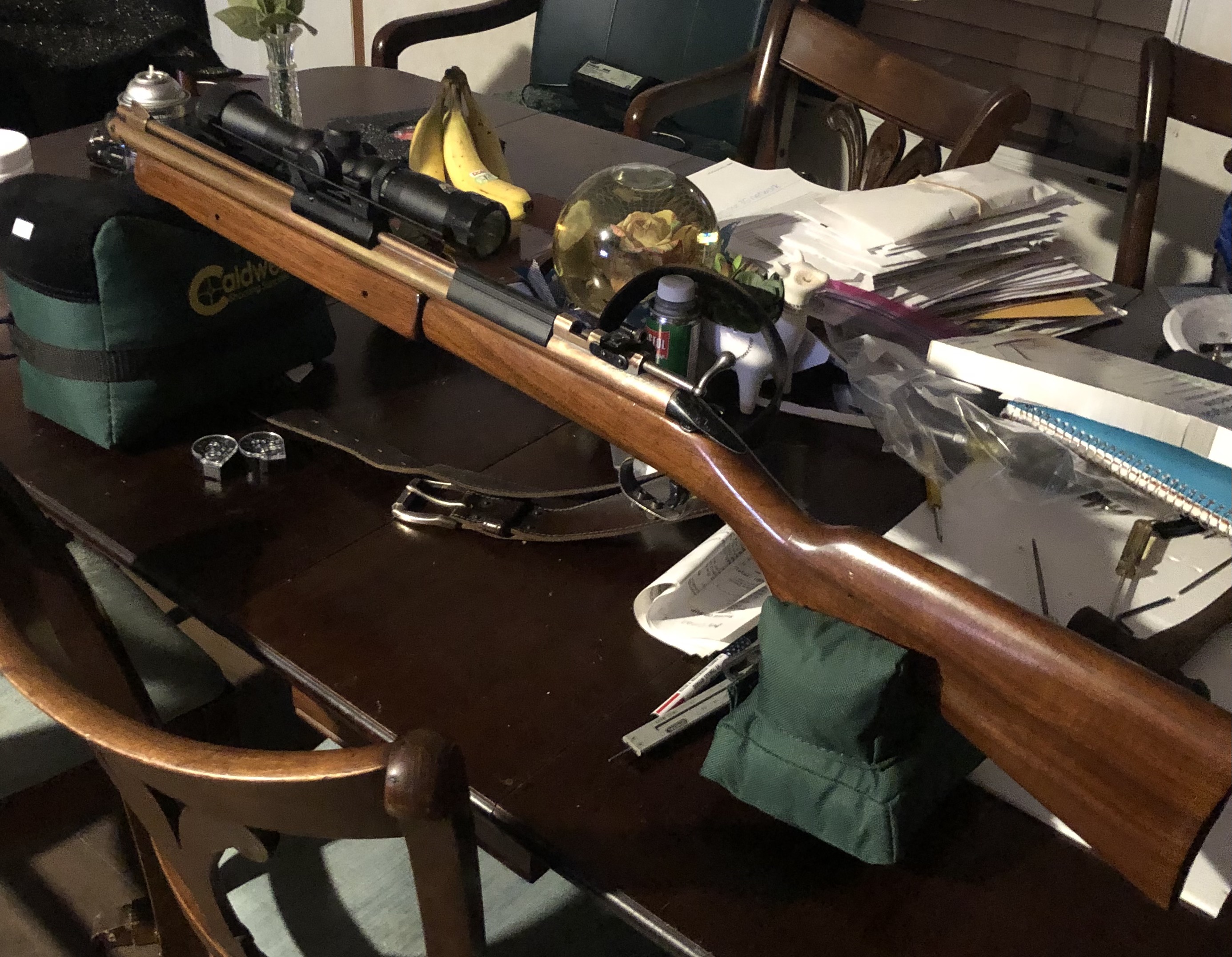

No, I don’t think it’s going to make I tougher, but it does wear well. I don’t remember the exact date, but I did this Sheridan some time in the early eighties. I had done an old Marlin before, and several others since. They all look great.
Keep in mind mine are shooters and not show peices, if that makes a difference.
