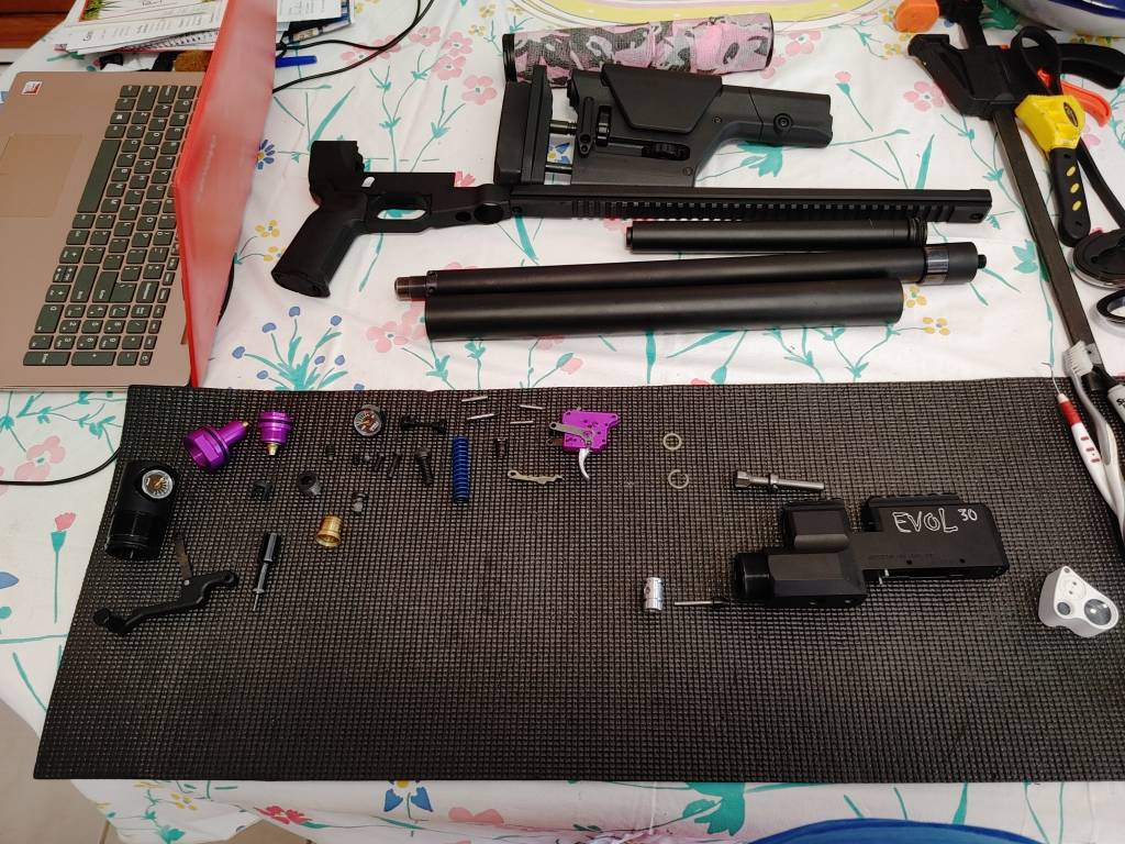

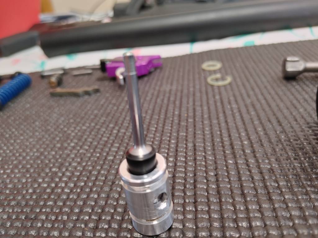

yes all do it you hearing the valve moving back and forth and the blue spring moving in bore . , there is not alot of info on these guns , I had a leaking valve in mine a week ago so I had to strip gun and repair it , well here what makes the evol tick , I like the gun but they have issues with leaks from various orings and valve . ALso Id like to say it is difficult to get any parts for them , When I stripped mine down I wanted to replace the valve and seat the seat was poorly machined I called aoa and tried to order one , welll they said we will call you back , they didnt I tried again no reply ugg reminds me of FX issues before they they moved to NC n Now FX support is A++.. My only gripe is for a expensive gun how about some better support .

Thanks. I also tore mine apart a month ago and changed all the o-rings. I didn’t see any wear on any components, but the o-rings were in horrible shape. Yesterday I noticed the orings on the regulator had already expanded and needed replacement again. I’ll try Tom’s recommendation to change to viton 90 orings and see if they last longer. I agree on the accuracy of the gun and even with these few issues I’m having, I still love it.

If I have to reseal a gun I generally clean up everything and I polish any parts so orings last longer , example like if a regulator oring leaks , alot of time it can be due to the roughness or edges where it sits , sometimes a little bit of polishing and lubing and cleaning can prevent same seal from leaking again , and I look at it this way , if it is my gun I spend time to make it perfect , but if it is sent to a shop they may just replace oring and not clean or polish , I hope you get it ,I sent out 2 guns under warranty like in 2015 and both were a nitemare , I would not relive this again , actually one gun was New I was told well you shot gun below 100 bar and the regulator orings wont seal and needs to be machined for $300 ,
