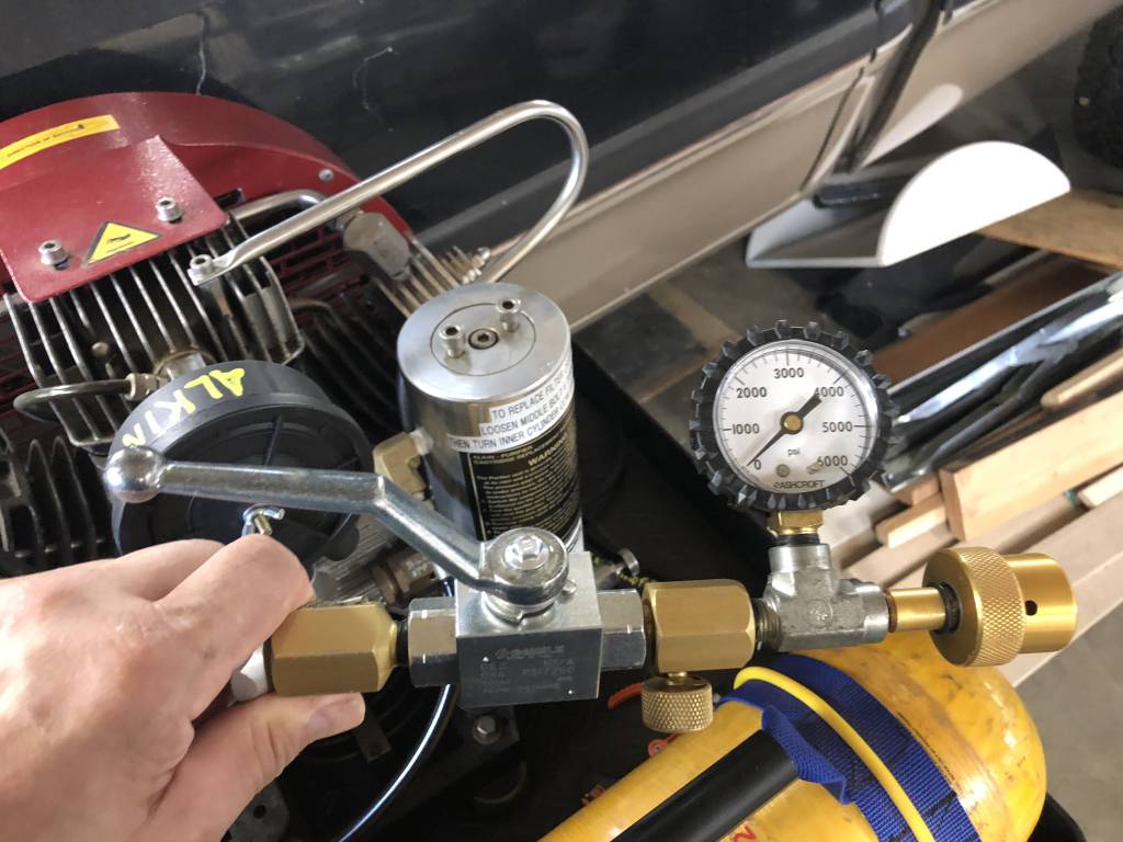

The lever is ONLY for shutting off the air supply while at the same time bleeding from whip to tank so you can remove it from the tank. The line stays pressurized between the toggle valve and the output canister to be ready for another fill without having to refill the entire assembly before each new tank is attached for filling. To bleed the line completely you have to open the output canister valve. Took me a couple of weeks to figure it out and several foster o'rings blown across the shop. I always turn off the compressor first before closing any tank valves and bleeding the system to prevent the safety valve from opening. Probably clear as mud right?

What's confusing new users is they don't realize the toggle lever merely drains pressure between the fill assembly and the tank. We don't realize there is a check valve above the toggle lever that holds pressure in the fill hose and filter housing. I see the benefit to a dive shop or power user filling multiple tanks in one session. I learned through trial and error. This fill whip is more complicated than fill hoses that are on most compressors. The confusion is that the owner' manual on this vital topic is as clear as mud, and the hose assembly is not user friendly. The pressure fittings used are unknown to me.

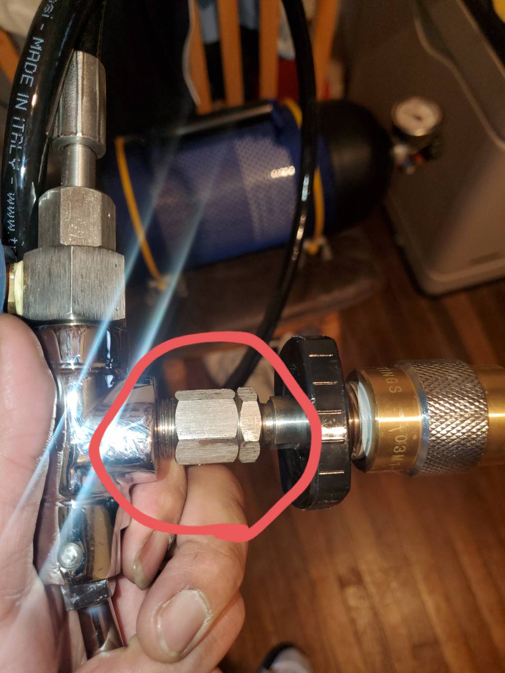

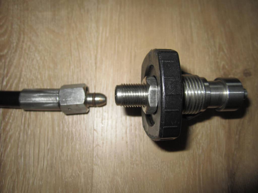

I need an adapter that will allow the W31 fill hose to directly attach to the Alkin DIN300 connector. I don't know what the fittings are.
Heres my set up. At start up all valves are shut, at both compressor and fill tank. When pressure equalizes I open up the fill tanks valve, and within those few minutes of filling I try to get two moisture bleeds at both filter tower and oil canister.
When fill tank tank is full I shut off both the fill tanks valve and that stainless lever on the fill hose. Disconnect from tank then do one more moisture bleed, then that brass round knob bleeds the entire system of air.
This is the method shown to me by whom I bought this compressor from.
