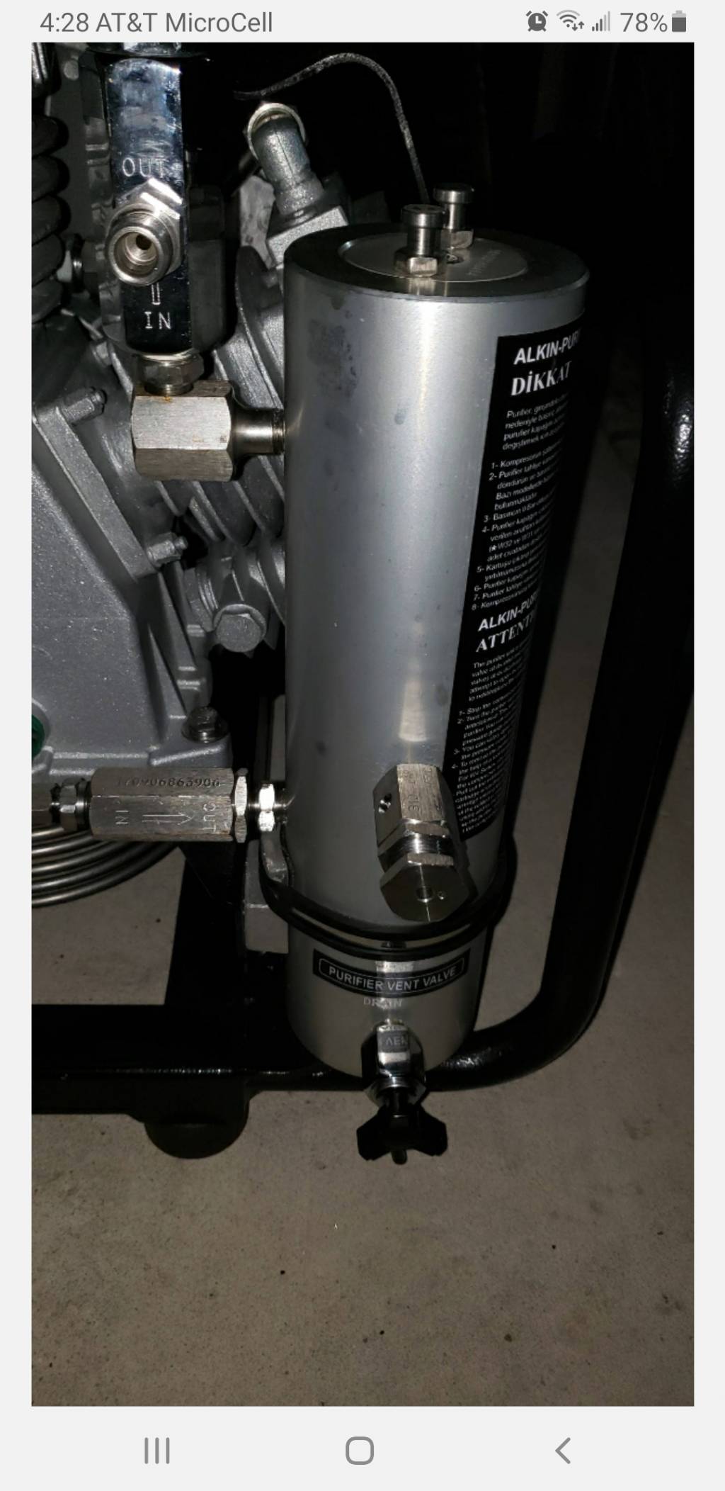

Since the pictures have been posted. What I want to do and my understanding is that Alkin can and will do for me is:
on the second picture at the upper left you can see the priority valve ( it says in and out on it) I want Alkin to mount the blue gauge (showing in the first picture ) mounted fixed to that priority valve or to the filter tank ( not clear on that but one or the other.) THEN coming off the gauge will be the quick connects showing in the last picture.
THUS eliminating the whip and the toggle lever valve.
My whip will come from the air tank to the compressor.
That’s about as clear as I can make it until it’s done
