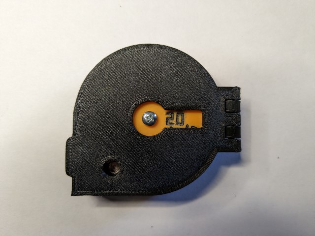

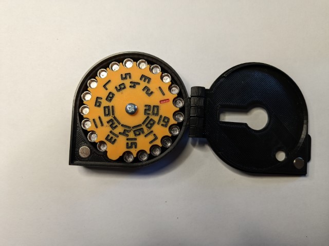

I wanted to be able to 3D print my own magazines, and ended up designing my own 20 round magazine. It works great for me, but I have a bullpup where it doesn't get in the way of the scope (scope is already raised as well as being forward of the magazine). Some people have asked about a version that could be used on a standard Avenger, but I don't know how tall it could be without needing taller rings (trying to figure out the maximum round count that would still fit).
My 20 round magazine is 58mm tall (~2.3"). By my calculations (for my design at least), here are the height and round counts possible:
15 round - 47mm (1.85")
14 round - 44.6mm (1.75")
13 round - 42.2mm (1.66")
12 round - 40.2mm (1.58")
