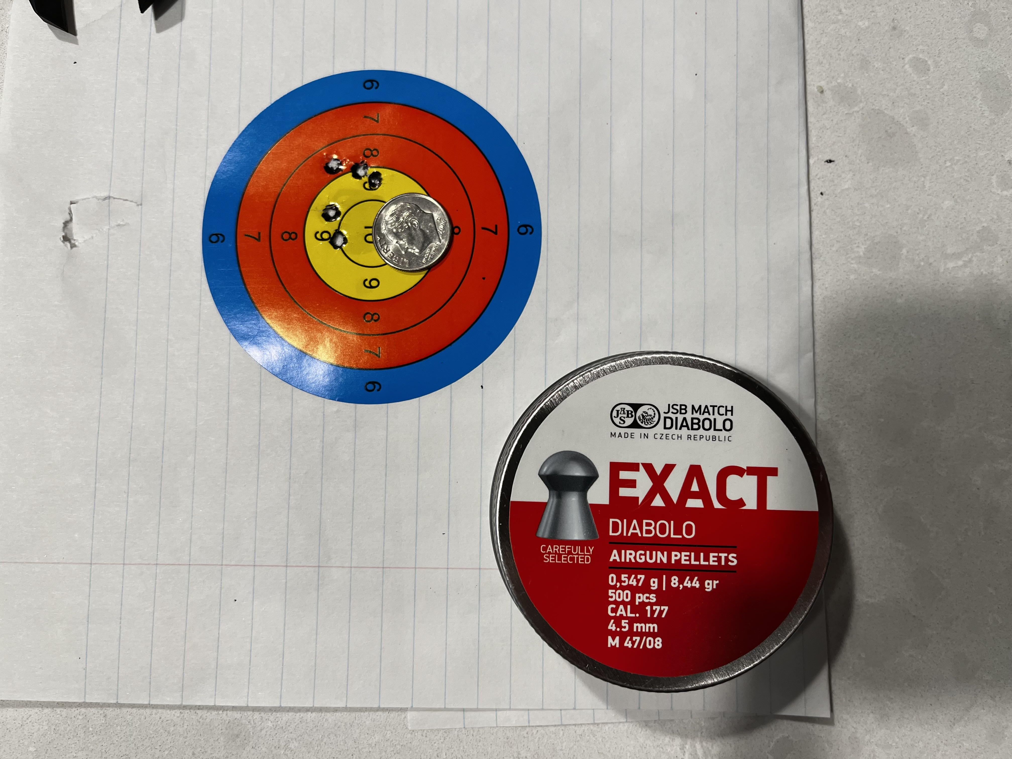

I’ve had an HW30, for over a year and have been really enjoying it. Last week I swapped my Hawke Vantage 3-7x40 for a AIRMAX 4-12x40. I don’t personally know any other HW30 owners. My questions are 1) how accurate can I expect this little rifle be at 50 yards? I’ve just started shooting this distance at a range and I’ll try and attach what I consider a good 5 shot group at 50y. Second question, 2) I’ve just ordered an HW97 and a Hawke 6-24x50 AIRMAX IR, can I expect better accuracy at 50 yards with this fixed barrel springer? 3) I know each gun may have its pellet preference, are there any you recommend that are outstanding at 50 yards? Thanks for any comments from shooters with these specific rifles!
The HW97 is likely to shoot better at 50 yards simple because it has more velocity and the pellet will be less affected by atmospheric conditions. It is also a much heavier rifle and will sit well into your bench bags and not move as much when shot. I have both the HW30s and the HW97k and I really enjoy both rifles. My Hw30s uses a Williams aperture rear sight so I have not shot it at 50 yards for groups so I can't help with that.

I have both a 177 97 and 3 177 30s the 97 is good for 1" groups at 50 regularly and my 30s about twice that. Now cherry picked best groups fro both rifles will be less than half that. I love my 30s more than any other rifles but a 97 is a better platform for shooting 50 yard groups. What caliber is your 97?
Both 177. Thanks so much for your valuable comments. It’s taken quite a while for me to catch on to Springer shooting from powder burning. Now I’m hooked, once a shooter finally discovers how to not impede the recoil significant improvements can be seen. Please tell me your favorite pellets for both guns for long range shooting. I bought the 30 to see if I’d enjoy pellet guns and now that I’m certain my research showed if I was to buy one more Springer the 97 was the one. I was amazed to be shooting 50 yards with the 30. As I said, I don’t know any other Springer shooters So my knowledge comes from this forum and YouTube. I will mainly Shoot at 50 yards for both guns.

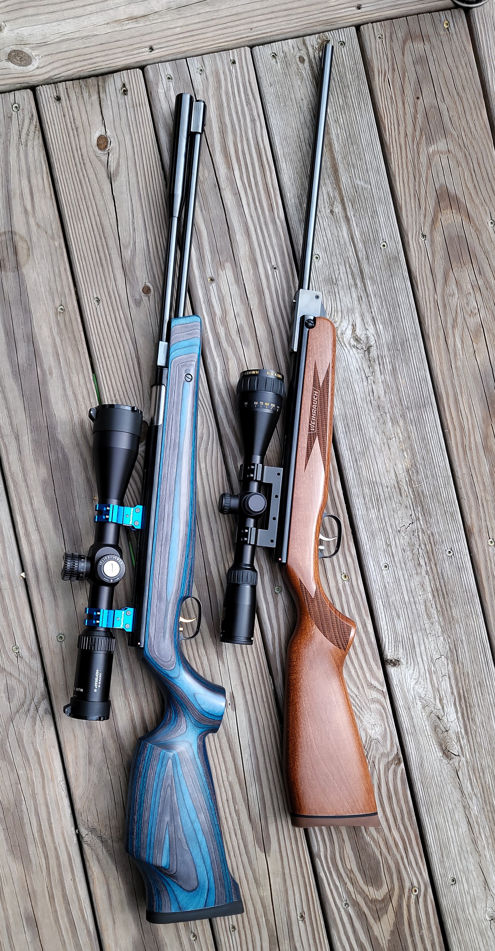

I have both of those and shoot them nearly daily. Mine are .20 cals though so?

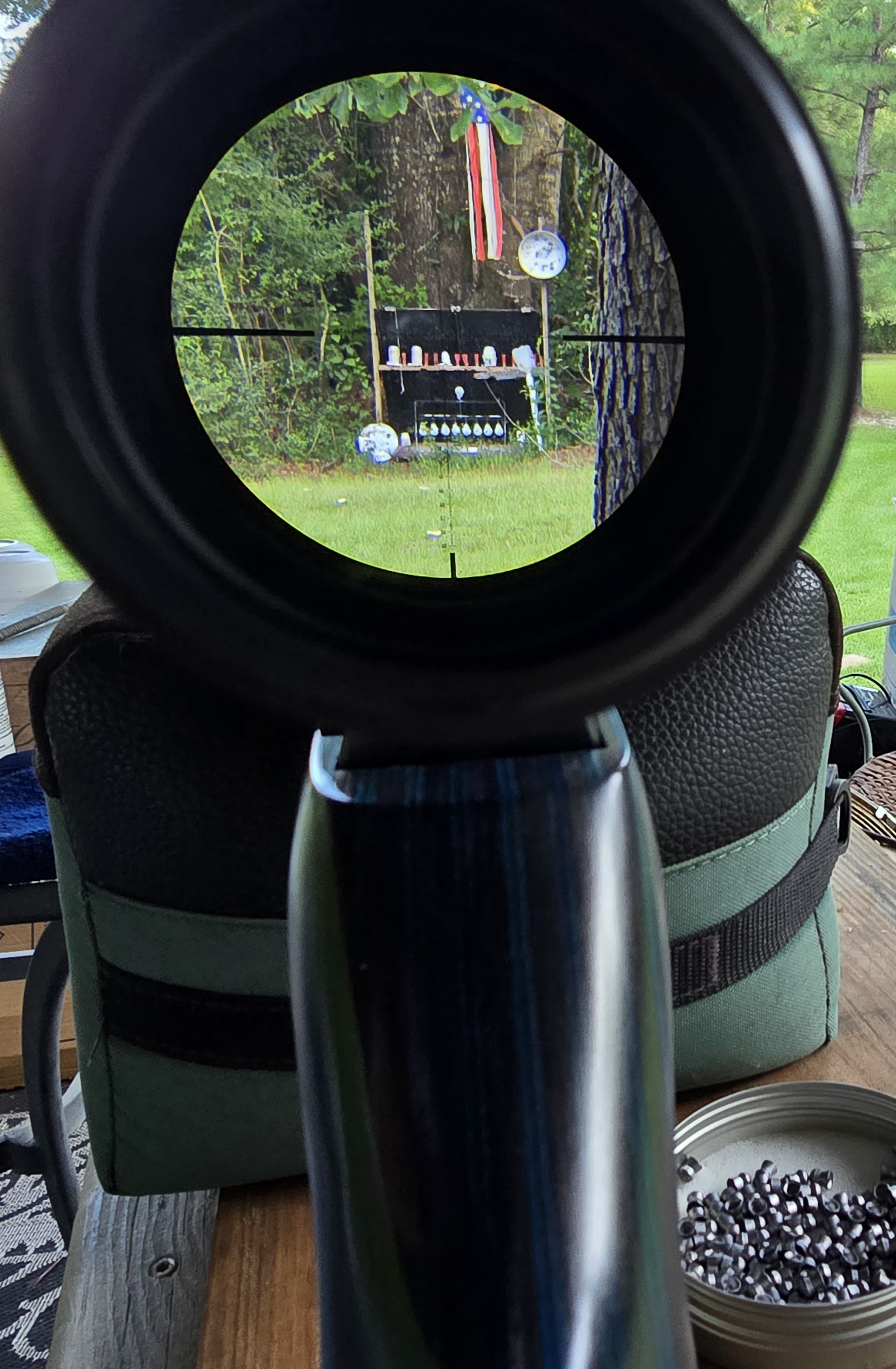

I shoot 30 and 75 yards, and at 75y the 97 is about twice as accurate as the 30, but the 97 has a 24X scope and with the 30 I have to use mill dots with the scope set at set at 4X+. That gives the 97 a big advantage.
I was looking through my videos and I came across one of the HW30 shooting shot shells and CO2 cartridges out at 75y. It pleases me that the 30 slams the paddles hard enough to lock them on my Crazy Eights at 75y. My .177 Webly Vulcan hits them, but doesn't lock them.

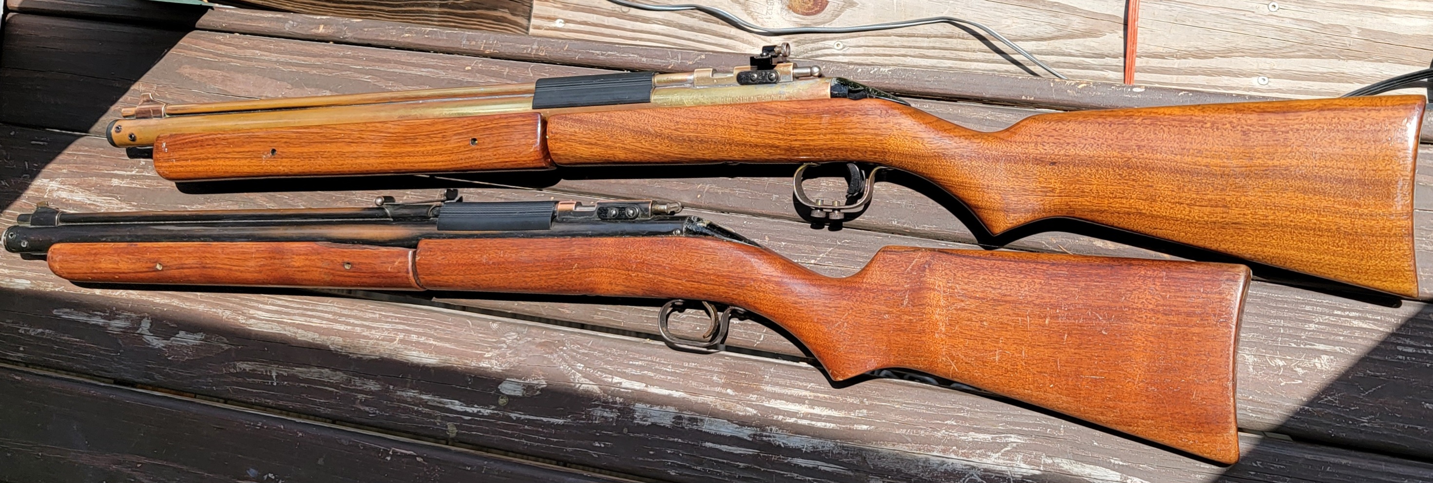

I started with .20cals when I bought my first Sheridan, which I still have and shoot.
My .20cal Weihrauch's are really nice transition guns. One cock instead of pumping, easy scope mounting, and like the Sheridan they're classics, and will be there for the long haul.
The HW30 shoots close to the power of the Sheridan at four strokes, (plinking load) and the HW97 eaquals the Sheridan's power at a full eight strokes (hunting load). With one cock!
The Sheridan is light and handy like pointing a finger though Lol

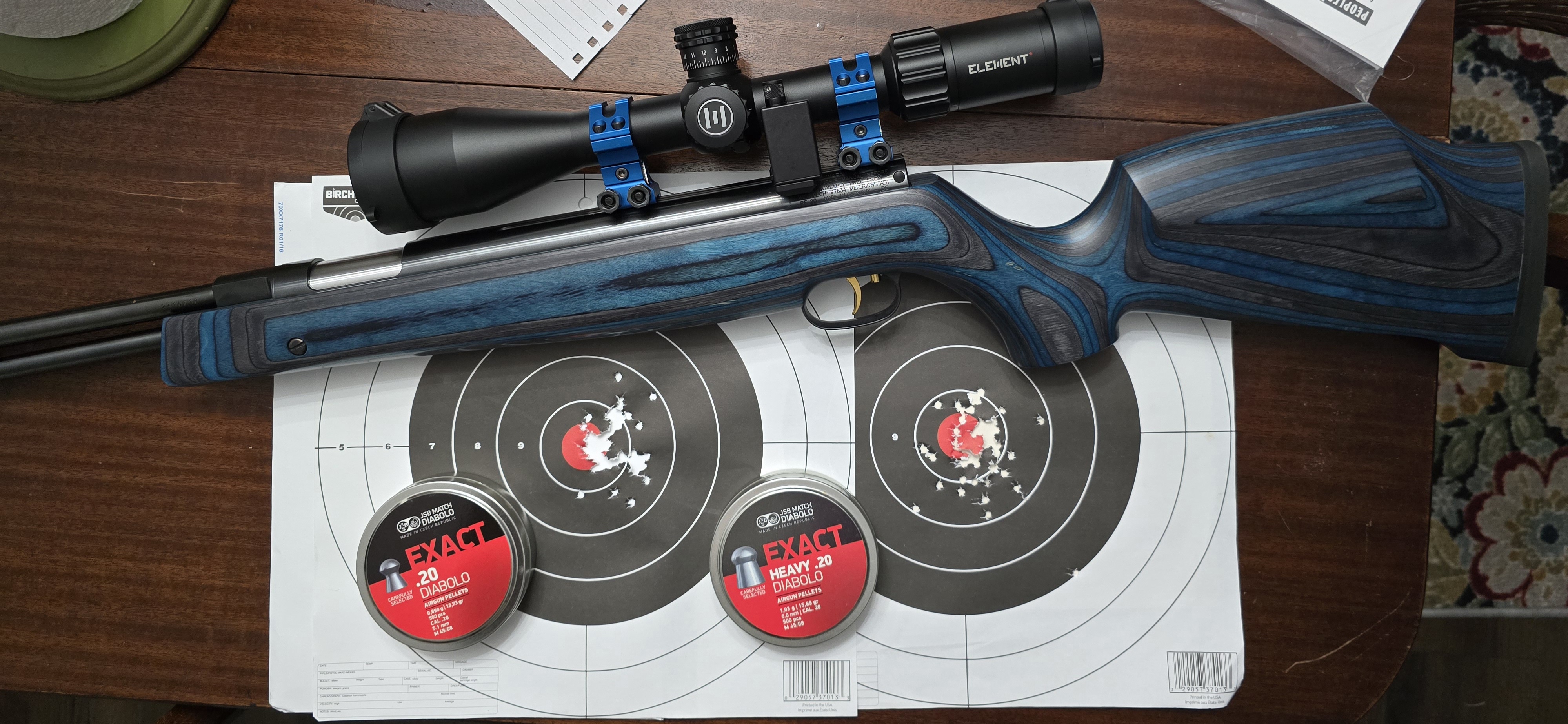

I generaly shoot plinking targets but had been having a bit more misses lately, so I started to experiment with different ammos, and finaly put up some paper.
I wound up having scope issues and hope to do better with the warranty replacement scope.
I had been shooting 9/9 on the Crazy Eight targets, but its been a month or so since I've been able to do that.
The Crazy Eight paddles are the same size as the ten ring on those targets. So it's easy to see why i was having trouble hitting them.
Seems to like the 13.73’s. Pretty impressive!
Yes they were better than the Heavy's. I gave it 2 clicks of left to center it and kept shooting until I realized that my scope was broke. The ocular eye piece was loose and when wiggled it moved the cross hairs about 10 moa. Element had a replacement delivered in less than a week.
