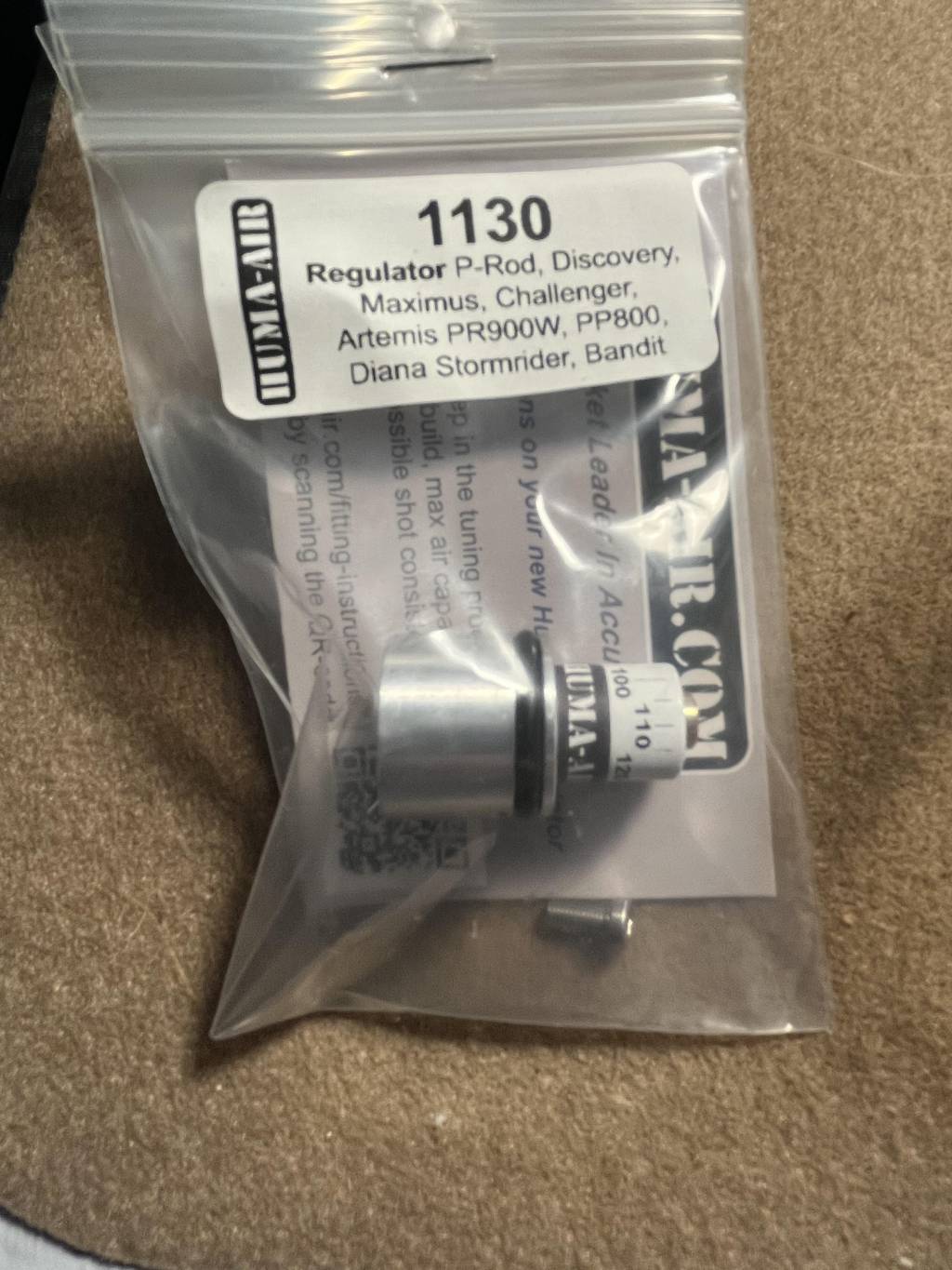

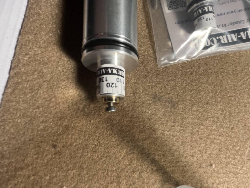

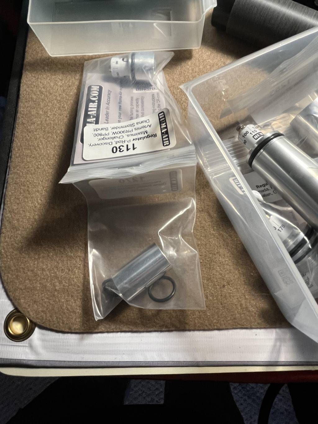

The very top of the regulator should have a hex head screw, it threads in fully and then is backed out one turn. Im guessing thats the screw. Pics help. Vent hole goes at 12 o’clock. Make sure you didn’t knick the o-ring when inserting into the tube, little 1000 grit paper may help smooth off a burr or sharp edge up by the fill adapter threads. Might also want to tie a long piece of fishing line around it before you screw it back in if you haven’t already, helps with pulling it back out. Without knowing chrony numbers, I would guess two things, the set point is too high and back off the hammer spring and throw, its a different gun now with a regulator. I find the stock hammer and valve springs are too much when regulated and get better results with a lighter set, even a lighter hammer and striker. Check out Tim Hill’s parts, a #7 valve spring and a 42 hammer spring is what I like with the stock valve and hammer/striker for a regulated p-rod. https://hillairgun.com/ The headspace in a P-rod tube is small to begin with so adding a reg really depends on what your goals are. P-rods are so versatile. Btw, all my huma reg’s were off by 3-5 bar, some high, some low. Regardless, i suggest to make a mark or measure the height of a couple settings, the sticker can move or slip once silicone hits it. Chrony numbers will be key to really help you out though.
Hope this helps with the missing screw. Heres a couple of pic of a new Huma reg for P-rod and another of the screw installed on a reg. Also should have 2-orings for the plenum. In terms of tuning, all i know is what works for me, which i learned from the seasoned obi-wan types here and and on older forums. Knowing shot curves of a tuned stock marauder helped me learn what part of the curve i was trying to tune to when using a regulator, i.e. the knee. Understanding that curve concept helped me with regulators more than anything. Hard Air Magazine has a fantastic technical series about pcp’s, starting with this article. Really comes down to what you are doing with it…shot count, power, es, plinking, competition. Marauders can be beasts or teddy bears and tuned to a pretty wide range of power or shot count. Also, a couple of good links that helped me learn about about marauders in general. Hope it helps.
