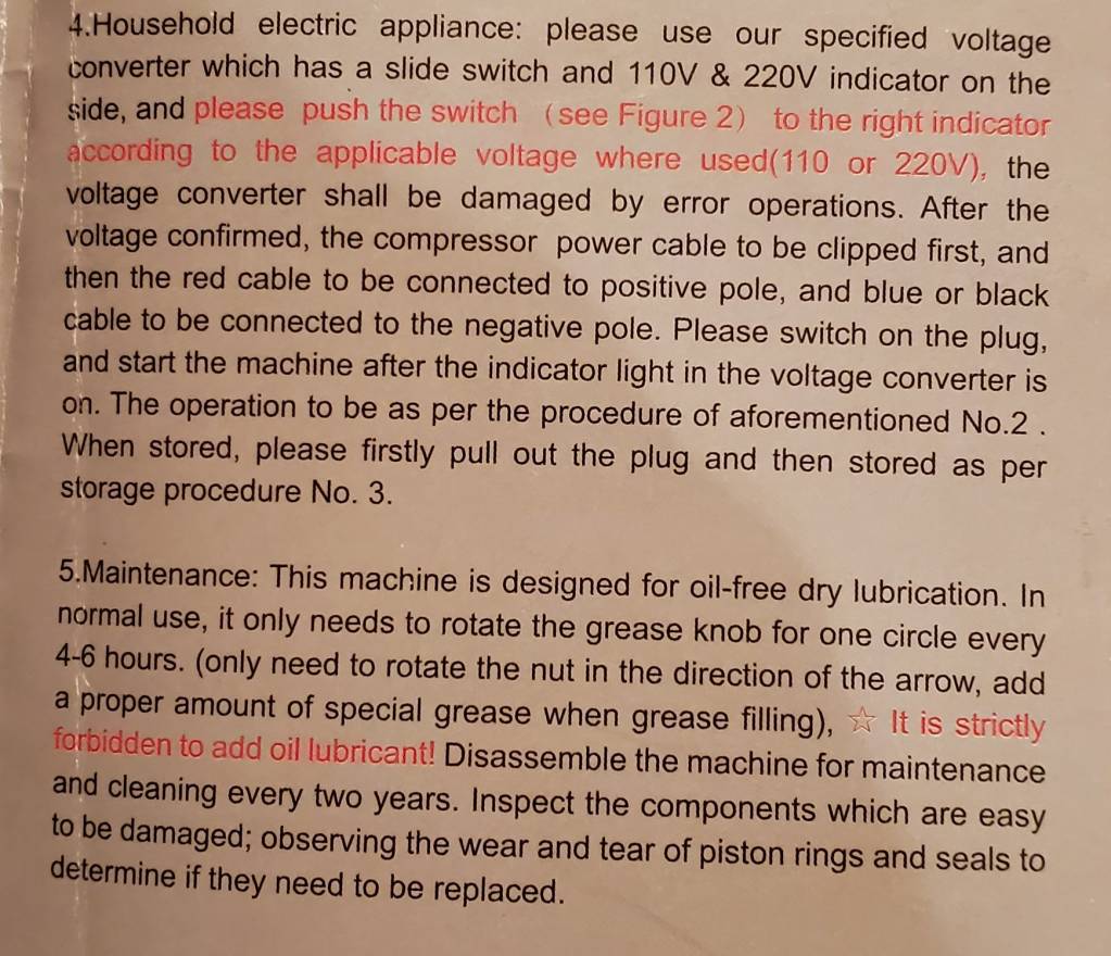

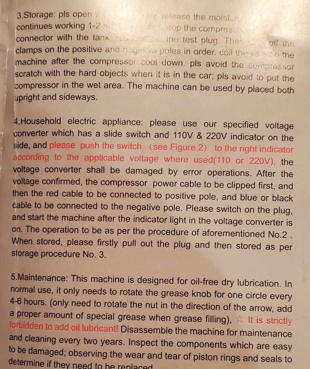

that is similar to what I am hearing. Also, the manuals does mention "A slight squeaking sound is normal.
Here is the manual:

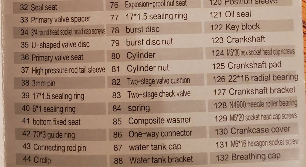

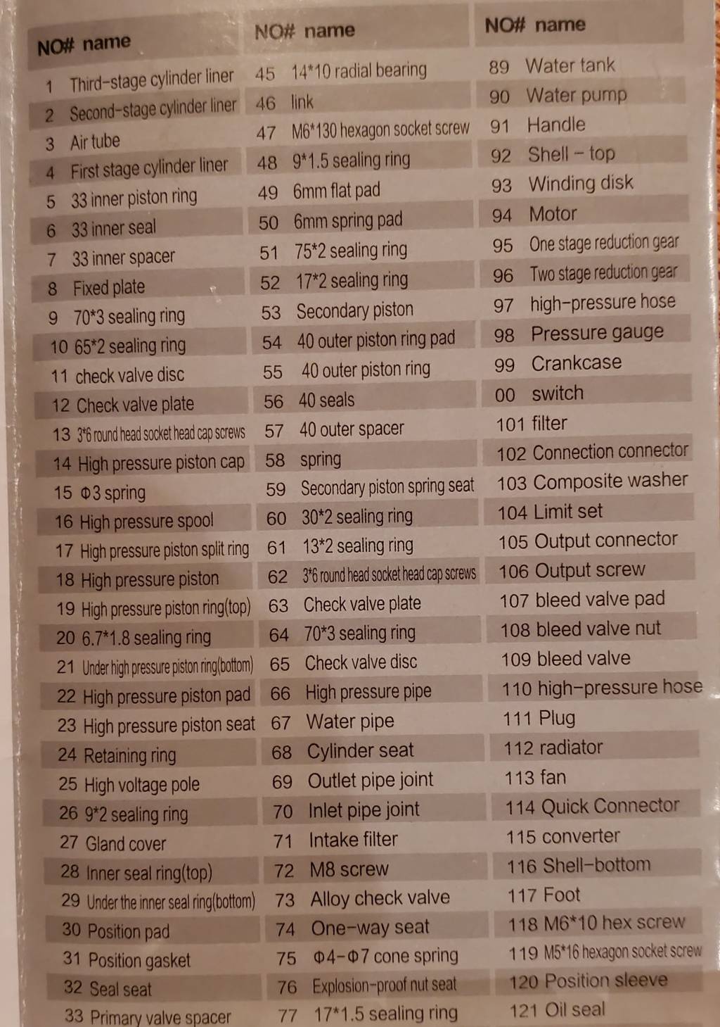

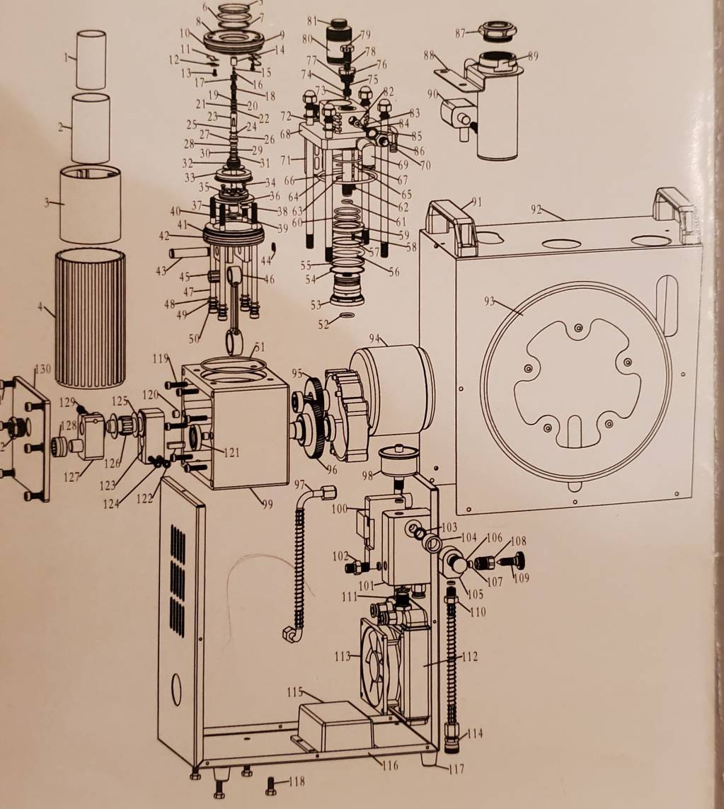

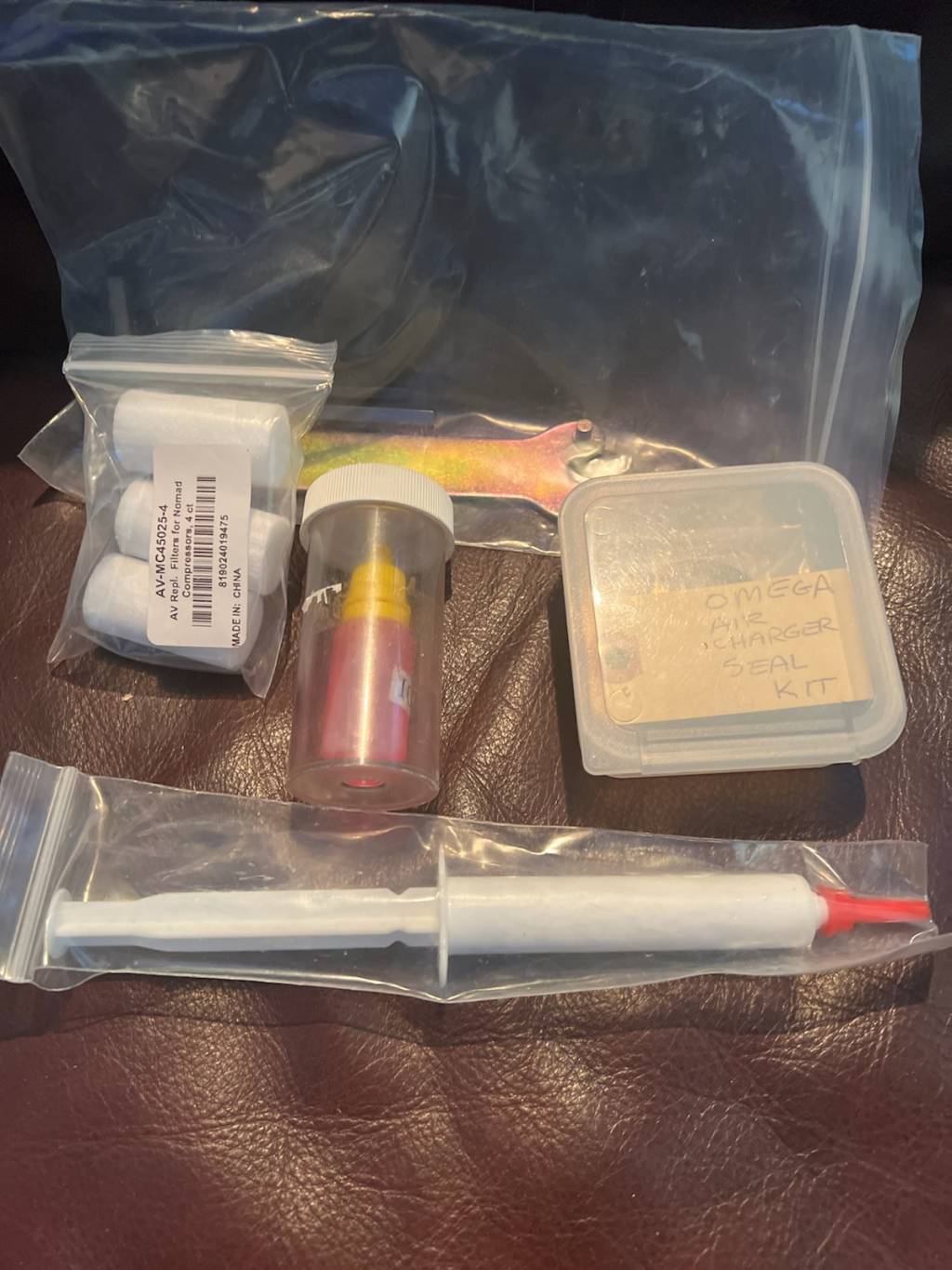

The grease pot looks like item 80 and 81. I don't see a black rubber concave disk in the diagram. Maybe it's a new part. Or maybe it is the reason for the squeaking? By the way, the creases were there when I got the compressor.

My bad, I had the AIR Charger not TRAIL Charger. But, looking at exploded view, the grease cup is the same, and yeah they don’t show the frisbee looking part.
Also, I’m not sure you have easy access to looking into air intake port without taking sheet metal cover off.
Can you post or PM me a pic of the frisbee looking part ? Maybe it will be obvious to me when I see it.
