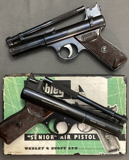

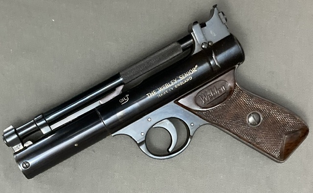

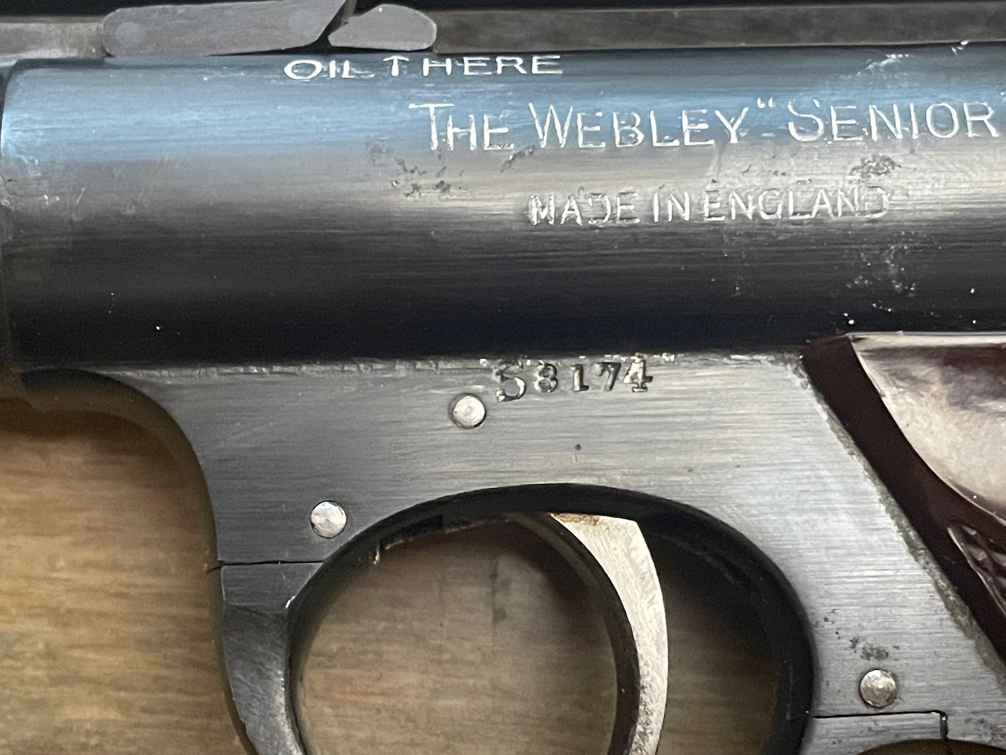

Webley Senior.....the best made and most powerful Webley. The piston ring allows a longer stroke than the other pistols allowing more power but let down by a tough trigger acting direct on the sear and no adjustment.
It was however, the peak of air pistol smithing and nothing that went before it, or after was better made and never will be again....You need to keep the piston ring lubricated. ...Constant attention...or it wears out.

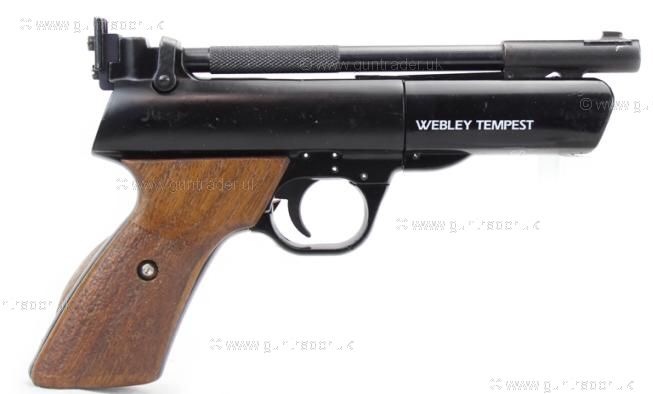

The Tempest...
This might just be the best looking and most purposeful pistol of all time. It is somehow better fed in appearance than the better made steel variants but never quite matched them without major tuning.
The trigger is adjustable but nowhere near as good as the Mk1 or Premier unless you follow the tuning advice on line. Then it can be..
The gun gets grip options to improve its looks and handling further. The Teflon pistol seal can be erratic to temperature but can be improved with feather edging...Again I toyed with Leather seal designs and modification of the piston to get a couple of these where I wanted them for close range ratting...

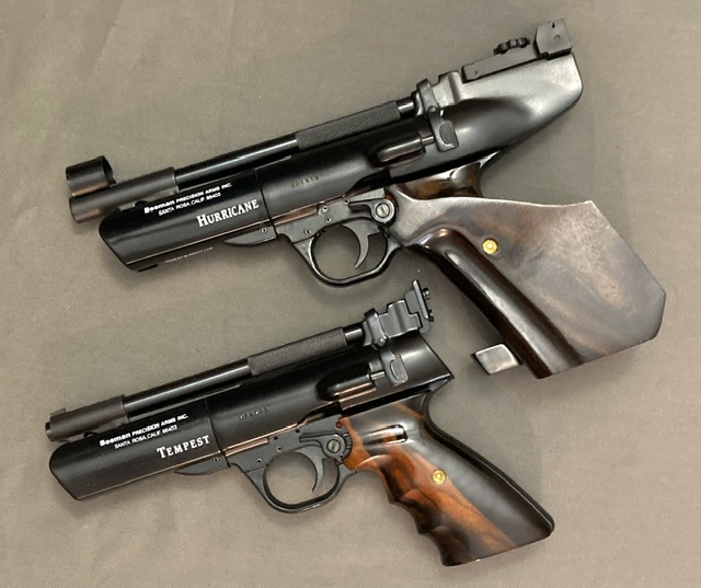

The Hurricane....Not really so much for me, as I feel something is lost by having the sight extension ...added length and bulk and longer barrel barrel with shroud but many will disagree with me for the longer sight base and more precise click adjust rearsight.
I once fitted the longer barrel of a Hurricane to a Tempest. Giving an improved sight radius without spoiling the looks and compactness of the rear sight mount..... A great compromise as it turned out....shown below.
