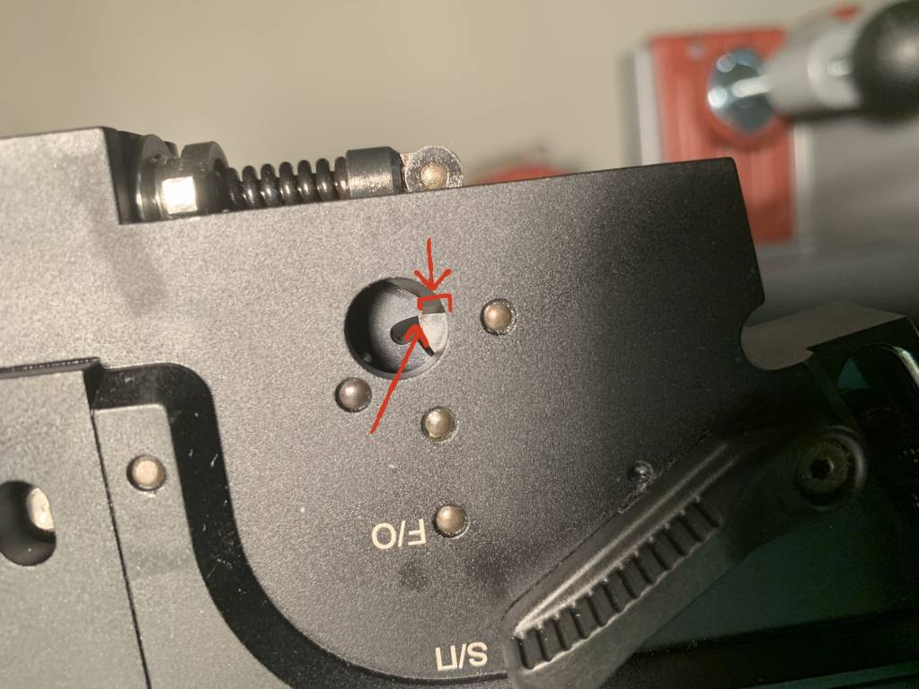

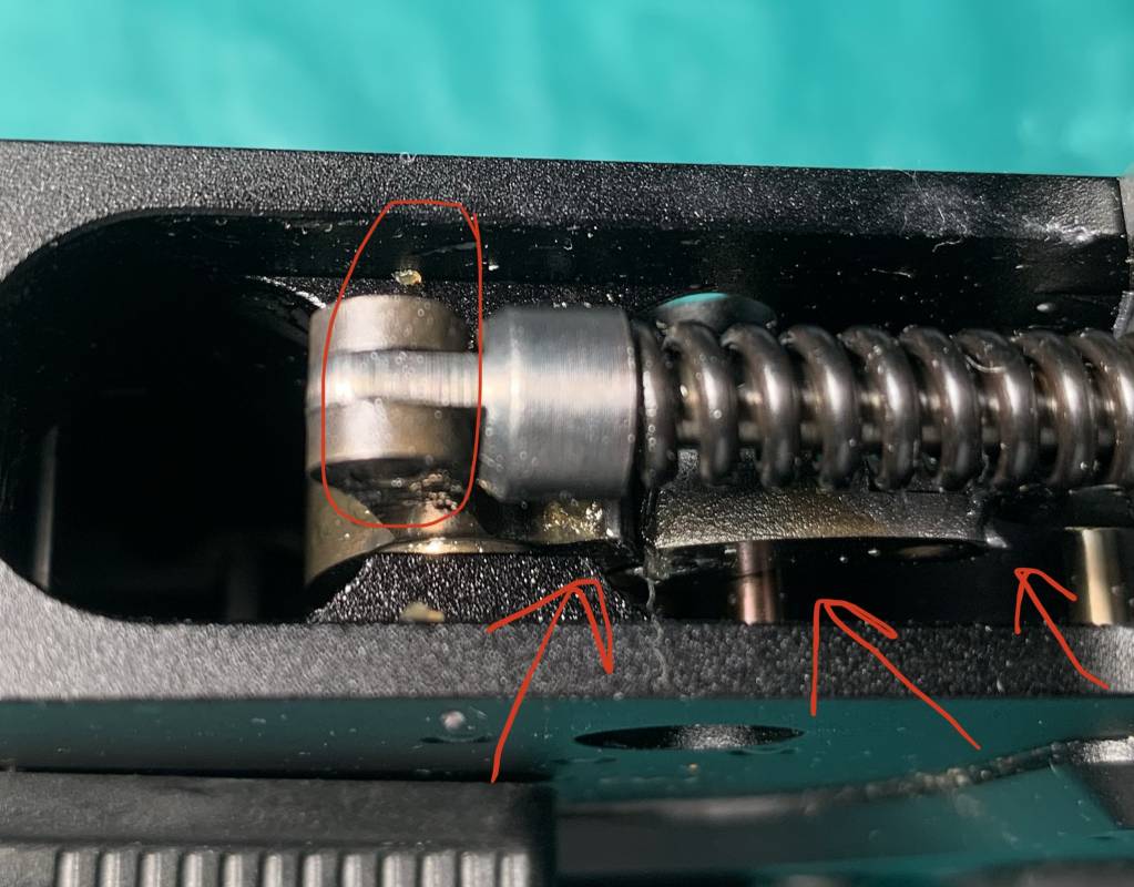

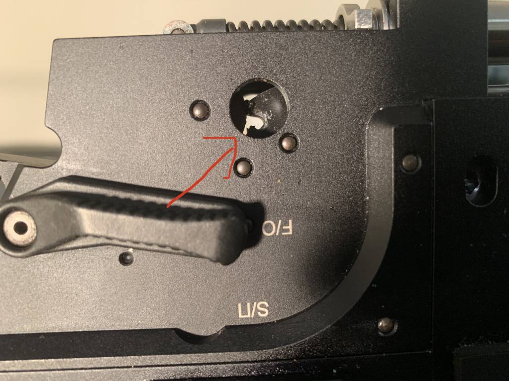

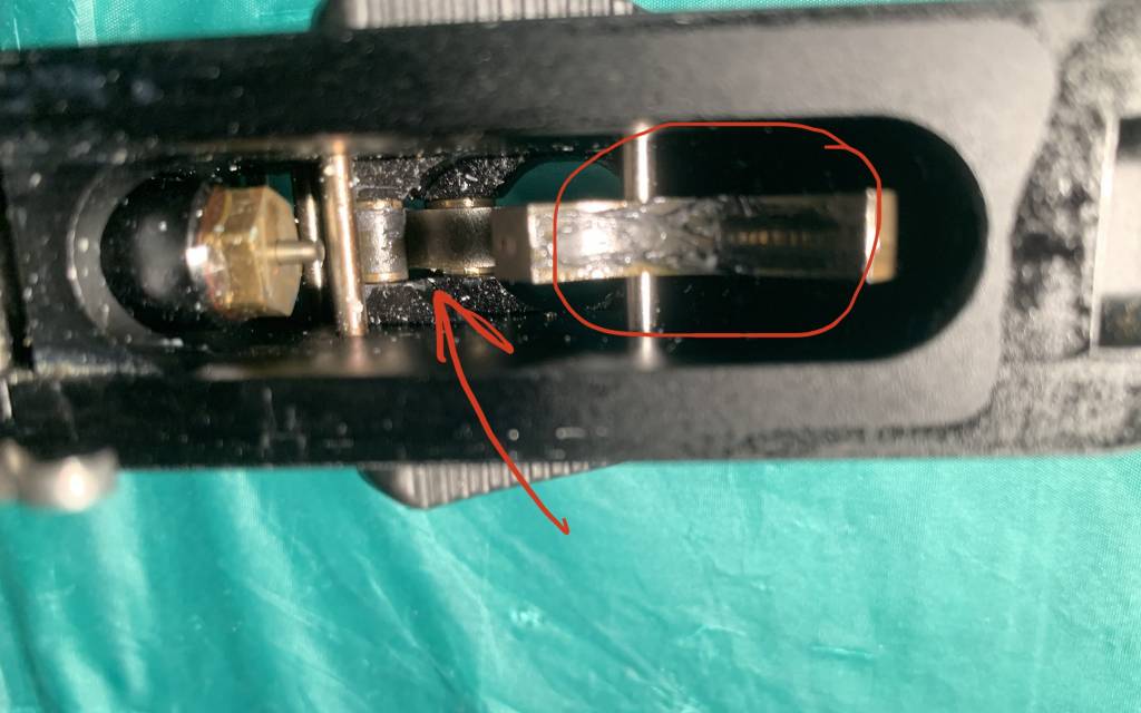

Took it apart again and captured these photos to better explain where I placed moly paste. Hopefully someone can provide advice as to where exactly I need to clean to remedy the issue of the carriage “slipping” forward sometimes (as if something is not consistently catching in order to engage the hammer) when pulling back the cocking lever all the way back.

Ok. After taking @jwrabbit123’s advice, I think I was able to solve the issue. The problem seems to have been moly paste on the edge of the sear that the hammer rests upon (the narrow edge resting upon the hammer above the tip of the longer arrow pointing upward in the photo below). I managed to clean off the edges and contact surface of the sear as well as the edges and surface of the hammer. To clean the hammer I pulled the cocking lever slowly and cleaned the surfaces as they passed. Then I used a lightly soaked q-tip swab to brush a light coat of Ballistol across the contact surface of the hammer (bracketed area with arrow above it in photo below).
After coating the hammer I cocked the rifle many times and pulled the trigger as I held the cocking lever (to prevent dry firing). I didn’t have an issues with the hammer not catching the sear - which was the reason the carriage would pop forward sometimes when attempting to cock the rifle. If the issue occurs again I’ll update the thread. Thank you Lou, @Lotte, MikeVV, for contributing to the thread. I also reached out to the manufacturer to see what they recommend for lubricating the rifle and which points around the rifle need lubricating. I hunt with this rifle in light rain, fog, high humidity, cold, etc. so I am concerned about keeping the rifle properly lubricated to keep it performing optimally. If I receive a response from the manufacturer outside of this thread I’ll post the response so we can have some sort of uniform resource to reference. Thanks again folks.
