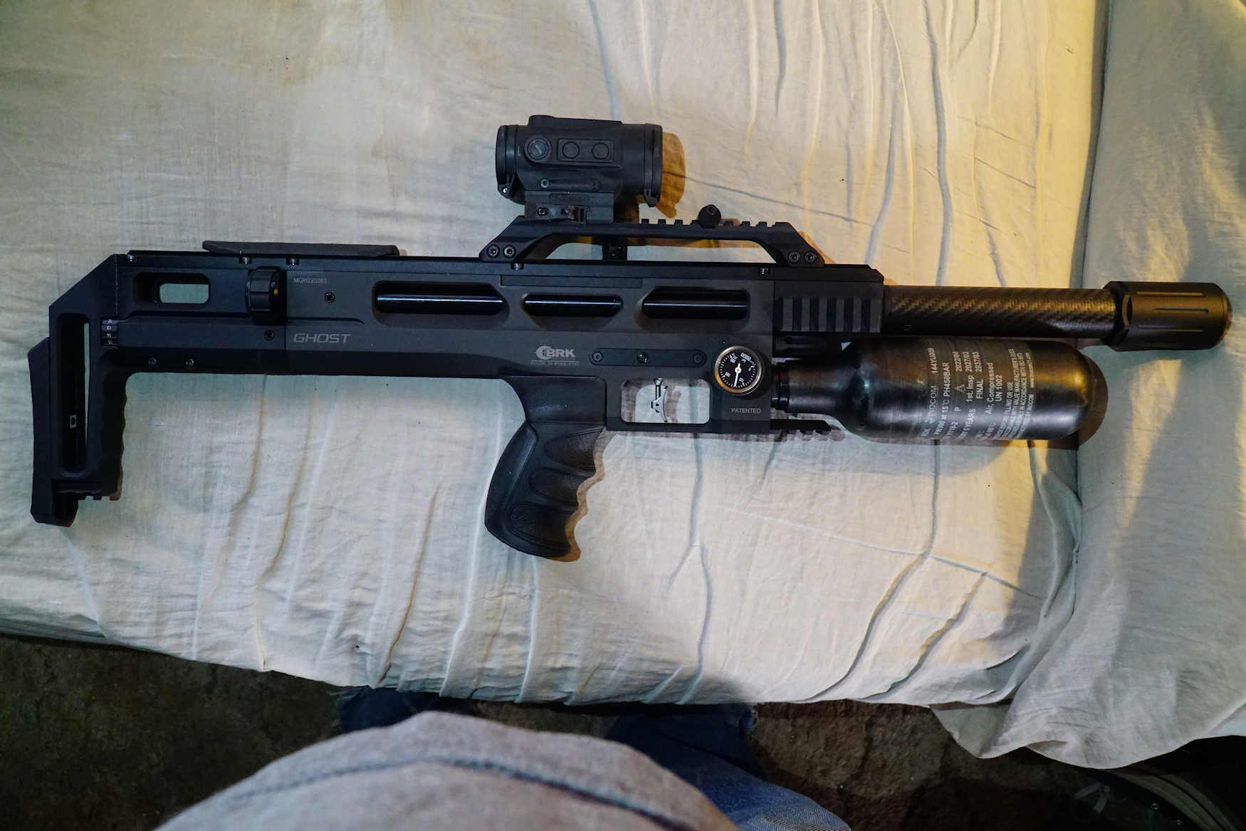

Received my Ghost Plus .22 today. Initial impression is it is very solid, well balanced. Replaced the stock grip with a Hogue AK47. Easy to adjust and setup the rifle with a few turns of some hex keys.
Tried a few pellets today, not a fan of H&N's. Will try JSB's tomorrow.
No moderator needed, rifle is set for 18 fpe.
Regulator is set for 100 BAR.
About a bajillion shots per fill. Shot for two hours and still had 150 BAR left.

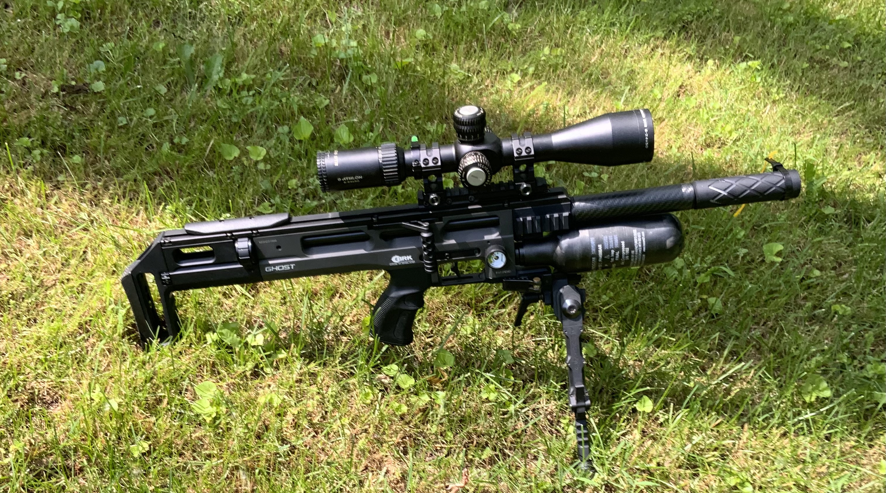

I recently purchased a new Ghost HP in .177, this is my back up for field target. The reg is at 100, the hammer spring is the light one. This combo gives me 910fps with a 10.34 gr pellet. As for quiet it is fine although I do have a zero db moderator on it. As for offhand it balances well although since I’m about to turn 71 in a couple weeks , my offhand shooting ain’t what it used to be. I also own several Daystate‘s which is the same company and for a non electronic rifle you would be hard pressed to find something better.

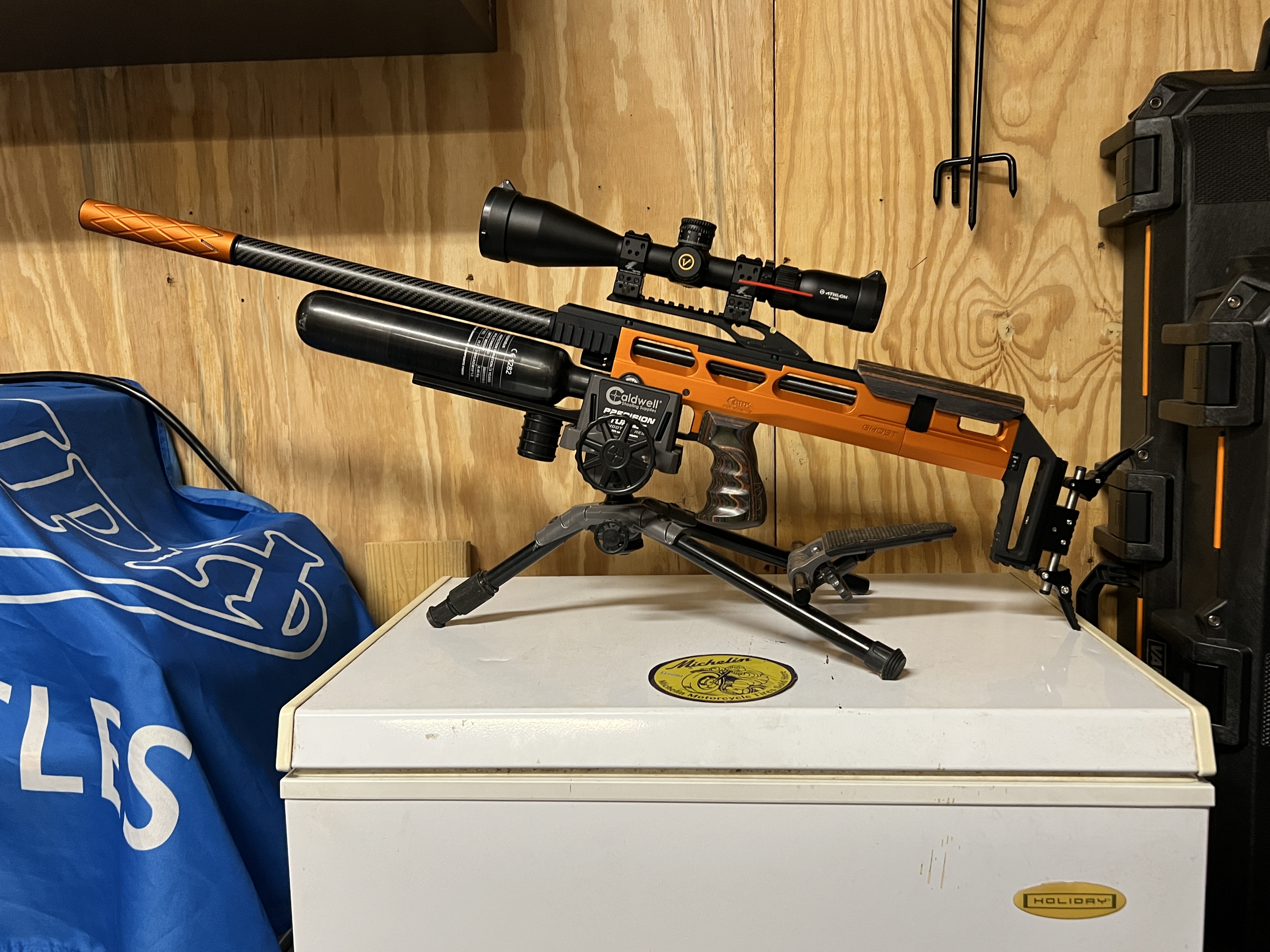

I have two Ghosts and all calibers of barrels including a.20. I use a 17” carbine in .177 for HFT. Although bullpups can be a challenge to get a good eyebox, the Ghosts work fine in conjunction with the 20 Moa rails. When adding some PRS accessories it just gets better. Very comfortable at shoulder In carbine configuration; I use a 300 cc bottle and still get 60 shots. When I want to shoot EFT it takes 10 minutes to convert to an .25 caliber and I’m ready to go even swapping to a 540 cc bottle. Of course when you switch back to a lower regulator pressure you do have to degass the gun. Very stable in the sticks for HFT but great for bench rest when using PRS accessories and a 28” barrel. Mine are tuned to conserve air and very quiet with a good moderator. Hope this helps. I started a thread called collective data for the ghosts… https://www.airgunnation.com/threads/ghost-collaborative-data-request.1316827/#post-1796273

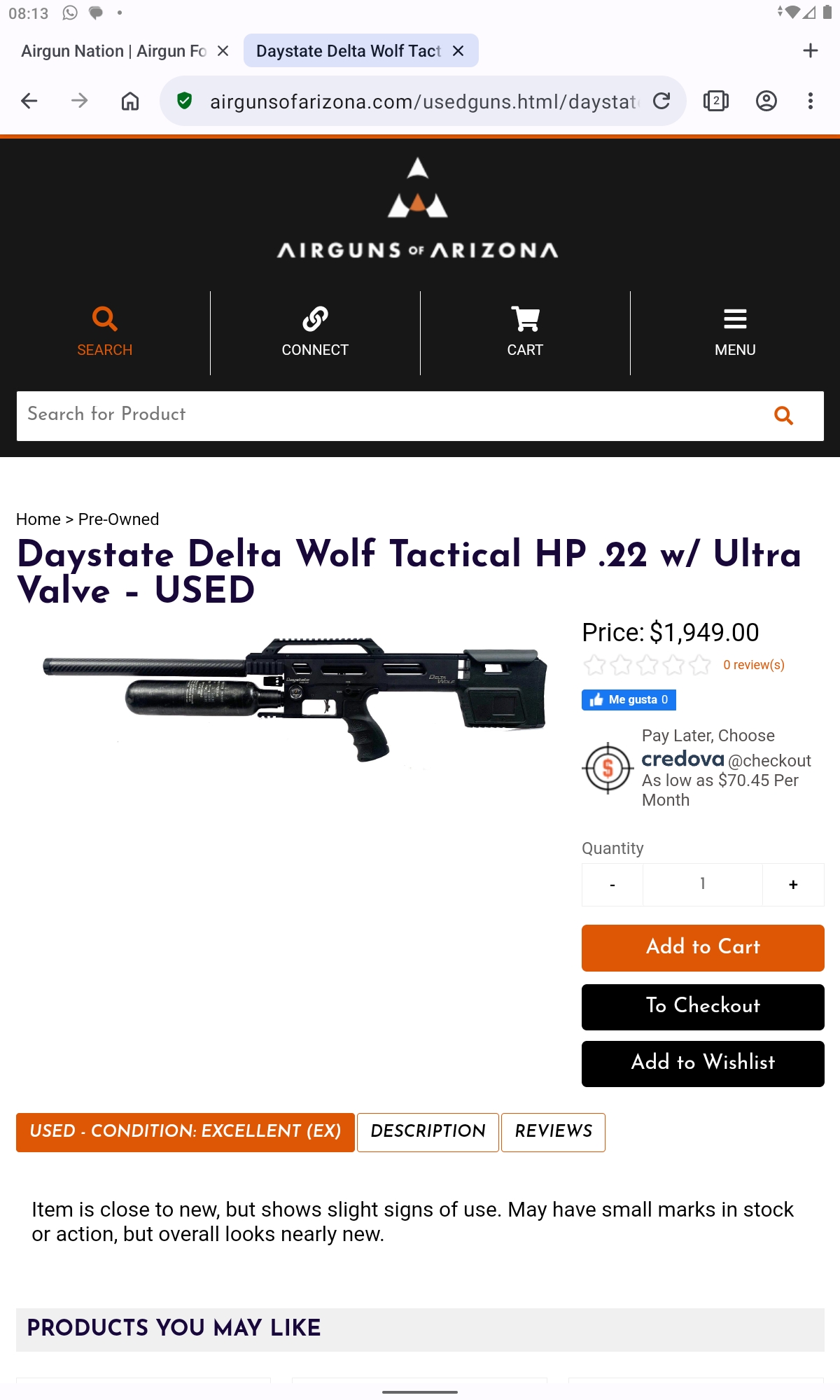

As my cousin kept the Ghost, then I bought a used Delta Wolf in .30 Cal and then bought the .25 Cal kit.... Delta feels a little bit heavier but better quality and the chrony on the barrel that is exceptionally usefully.
It you have the opportunity to buy a used Delta for the same price, then do not doubt it: GO FOR THE DELTA with ultra valve !!
