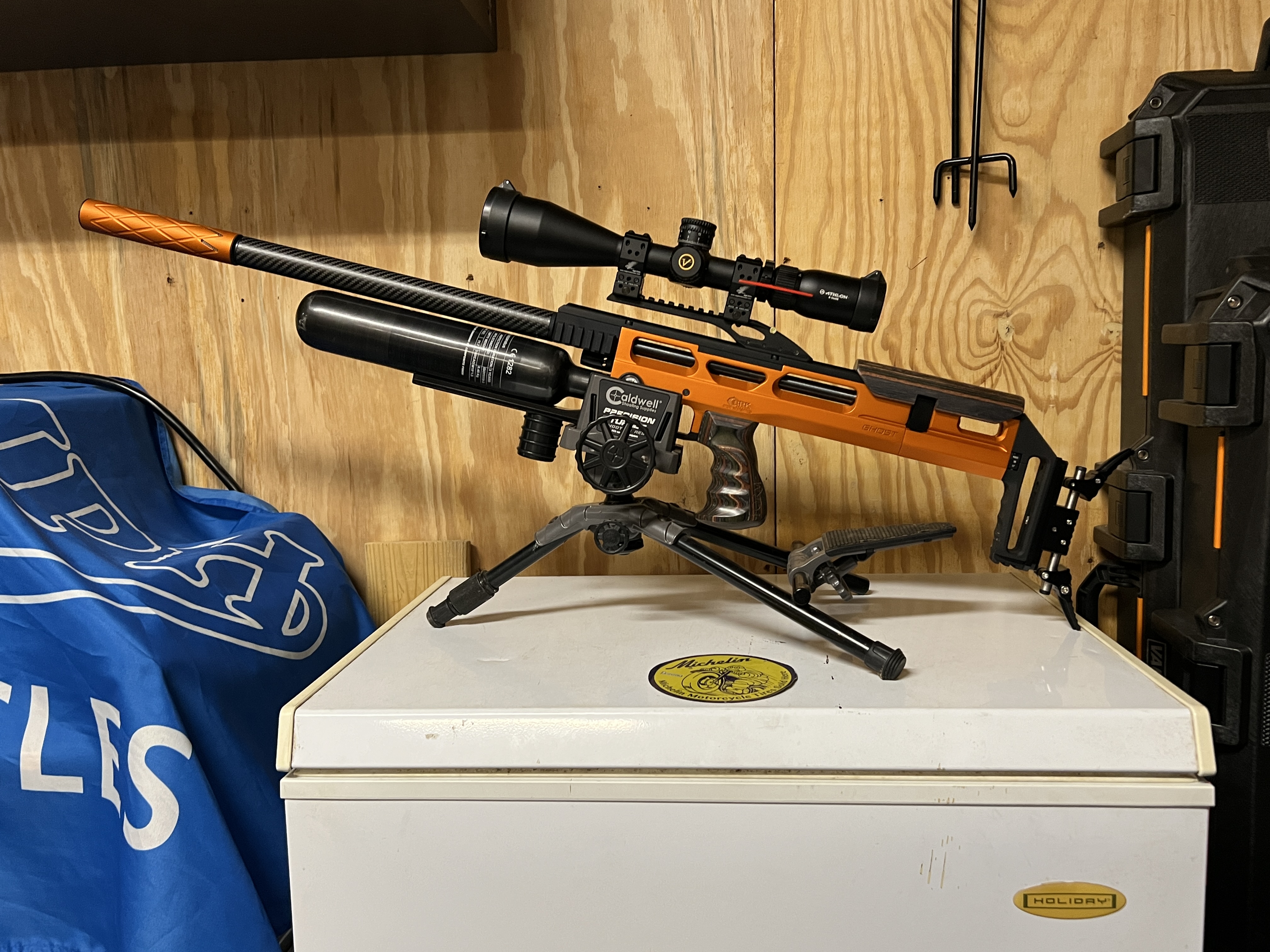

I own 2 ghosts. One is set up as my 17” carbine for HFT and it’s flawless. The other is my do all. I have every barrel available including a .20. I can easily swap to my 27” Fady K world record .22 bench rest set up in less than 10 minutes; and with my dope I am rezeroed within 5 shots for 25 or 50 meters.
Stellar shooters.
As of this weekend I received my FORM slip on stock. Beautiful piece in Forrest green with orange accents. It added just enough weight to the rear to help balance better at the shoulder when shooting offhand. No pics yet but coming. AOA in the U.S. provides excellent support if needed!
