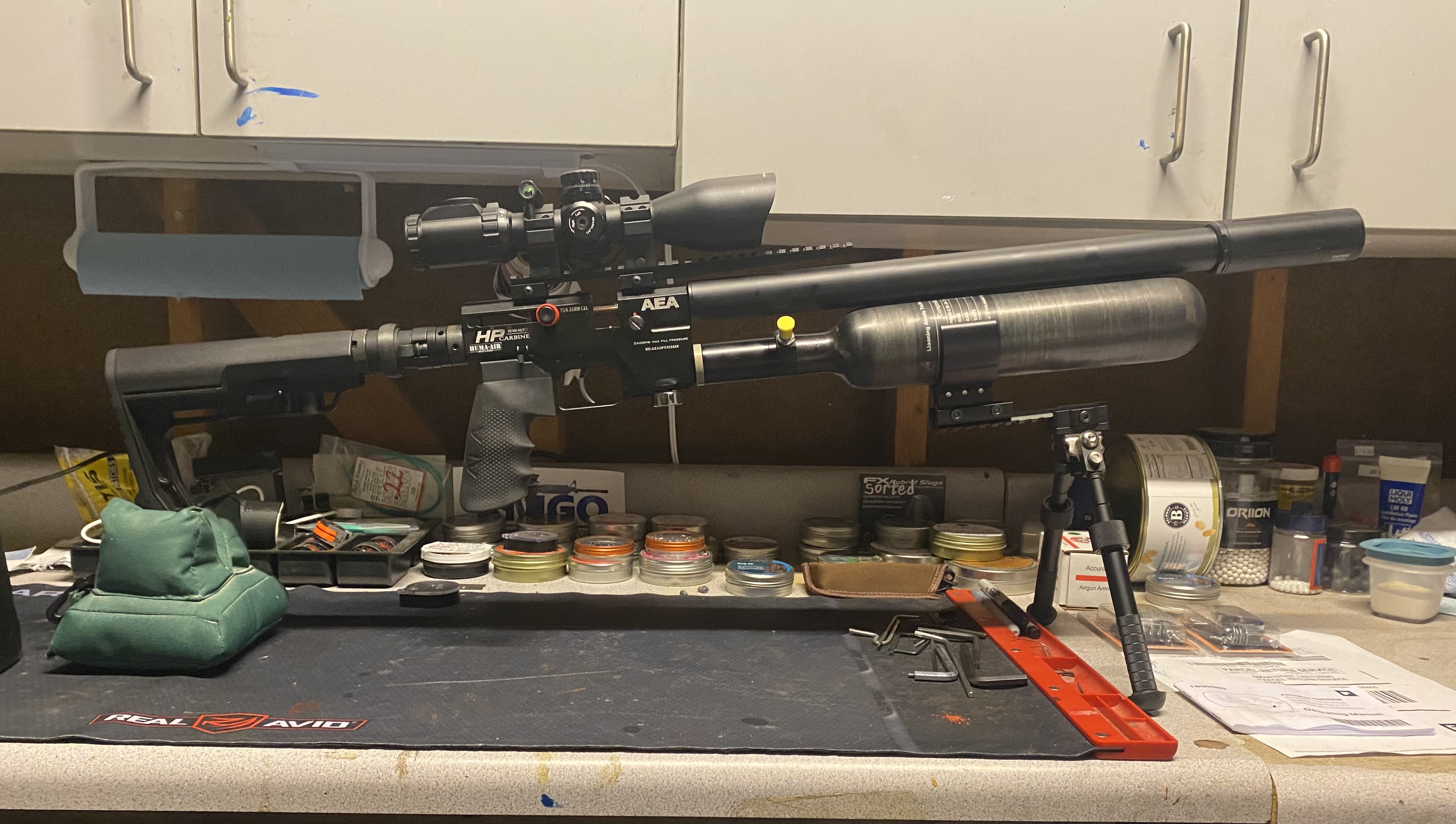

I have the HP SS Plus in .22. I get a max of 4 magazines of shots shooting the 18.1 JSB pellets. I fill to 3400 psi and usually stop after 2 magazines as the fps hasn't started to drop off yet. The fps is usually between 910 to 929 fps. I found a bottle adapter at Fox Air Power and now have an FX 480cc bottle installed. With the increase in volume I now get 3 magazines in the sweet spot for this airgun. I can shoot 5 magazines and it will still cycle but the fps has dropped down to 890's. The furthest I tested was 35 yards and had no trouble hitting the animal swinging target from Target Forge.

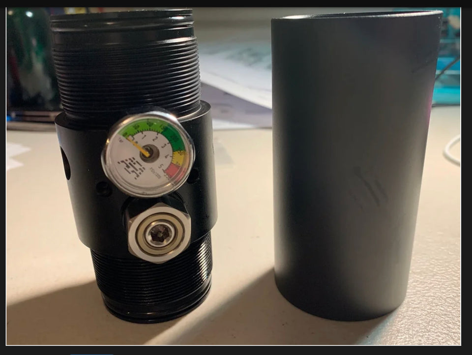

I tried this external regulator from "Fox Air Power" on my .22cal HP SS Plus.
It adds 80cc of volume but so far, won't cycle the simi-auto action. I adjusted it to 150 bar because that's about where my gun stops cycling 18.1gr pellets. Increased the pressure up to 170 bar. No go. Asked Ben @ "The Pellet Shop" about this. Ben's a nice guy. Always helpful. He was told by AEA that this kit won't reliably cycle my gun's action. Great! I got it because BinTac's videos indicated that it would work. Fox Air Power's listing only states what it is. There's nothing in the description about its compatibility with any particular AEA model.
Fox Air Power won't help because 1) They think I didn't do any homework before purchasing (even though I told them about BinTac's videos prior to the purchase). 2) I didn't ask them about it. 3) I installed it, therfore it's "unsellable".
Not happy.

I put a Huma bottle reg on my .25 HP Carbine and it works just fine (set at 165 bar). Now I get consistent shots from 250 bar (which I can now fill it to) down the reg pressure. With the 580 bottle I added I’m getting about 9 magazines of good shots. I only lost about 20 fps compared to when it wasn’t reg’ed (TP is wide open).

I was able to get my .22 HP SS Plus working in simi-auto with the Fox Air Power regulator/plenum set to 150 bar. Polished the bolt, hammer & its guide rod. Shortened the hammer spring & balanced it out by shortening the valve spring. Adjusted the bolt/piston return spring. Getting about six mags of JSB 18.1 @ 850 fps between 250-150 bar. Accuracy is pretty good. Fairly quiet with a 4-section Huma 30 Mod.
I'm finally happy with this gun.
