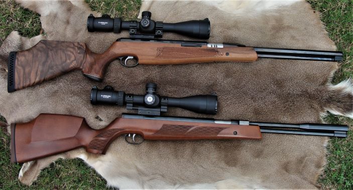

Could you elaborate on the reason why you would go with the hw97k? I don't have any experience with either and would like to have as much input/knowledge before making a choice...
The loading port on a 97 is much larger and easier to access. The 97 can be shot either left handed or right handed and easily loaded either way.
The POI on my 97s never seem to shift coming out of my vault after sitting for a few days, while the TX200s often take a click or two of adjustment.
There is no bear trap to contend with on the 97 and the cocking lever latches into a much better system than on the TX.
I find the 97s, when properly tuned, are much smoother to cock and are silent to cock, where you hear the bear trap ratchet in a TX unless you have slight pressure on the bear trap detention the entire stroke.
The 97 is less money, and the bluing is deep and great, but the TX generally has a nicer level of bluing and finish.
My 97s will generally shoot a 3/8” of less 10 shot group at 20 yards and inside of 1 1/2 at 50 consistently and without fail. My TX200s are “nearly” as good but just not quite.
Again, I love having both of them in my airgun Arsenal - both are really high quality, but if I could only have one, and dependability, accuracy, and consistency were the only criteria (not looks), the 97s easily win I my opinion.

I see... should probably just go with the 97k then!!!
