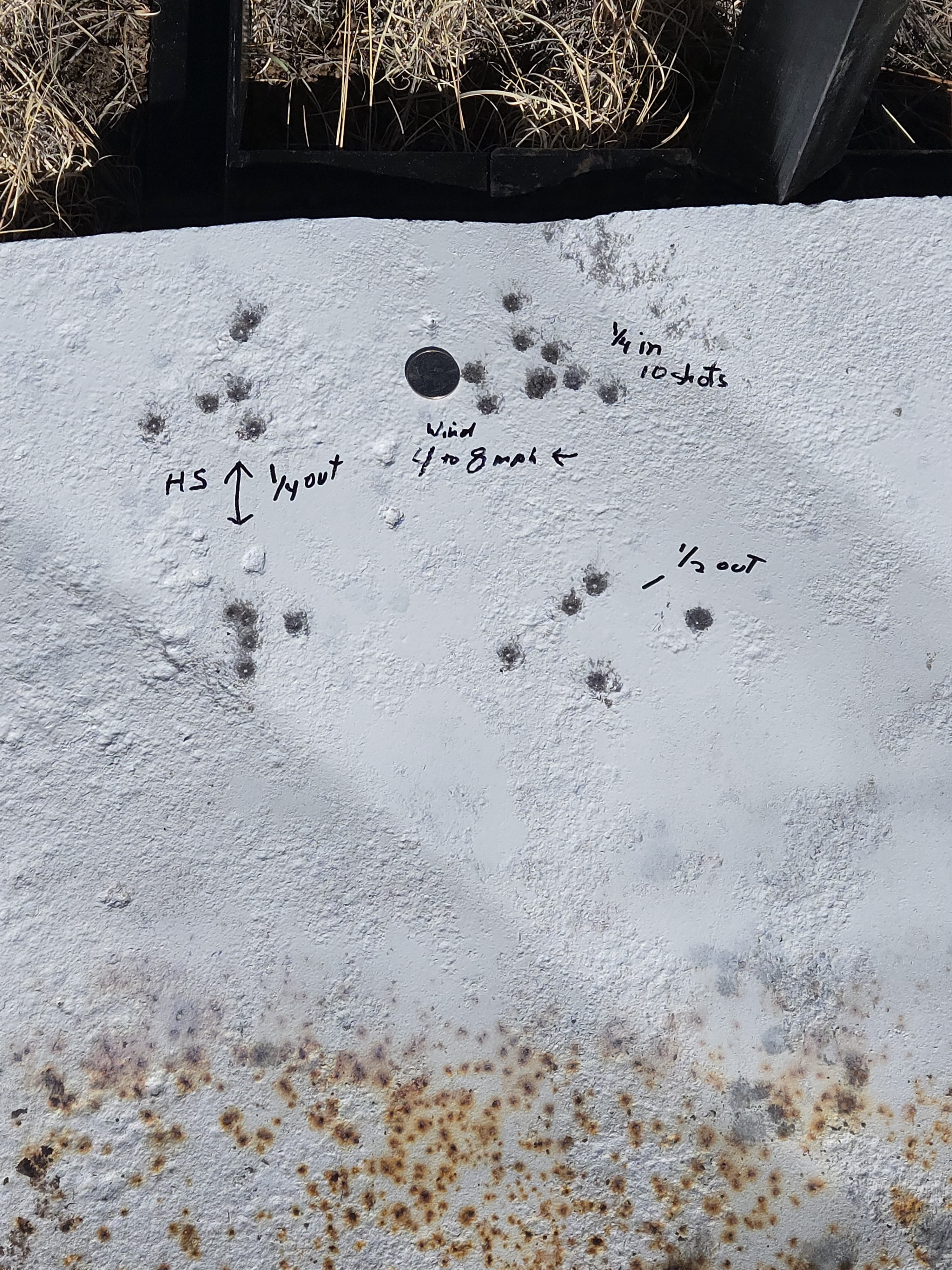

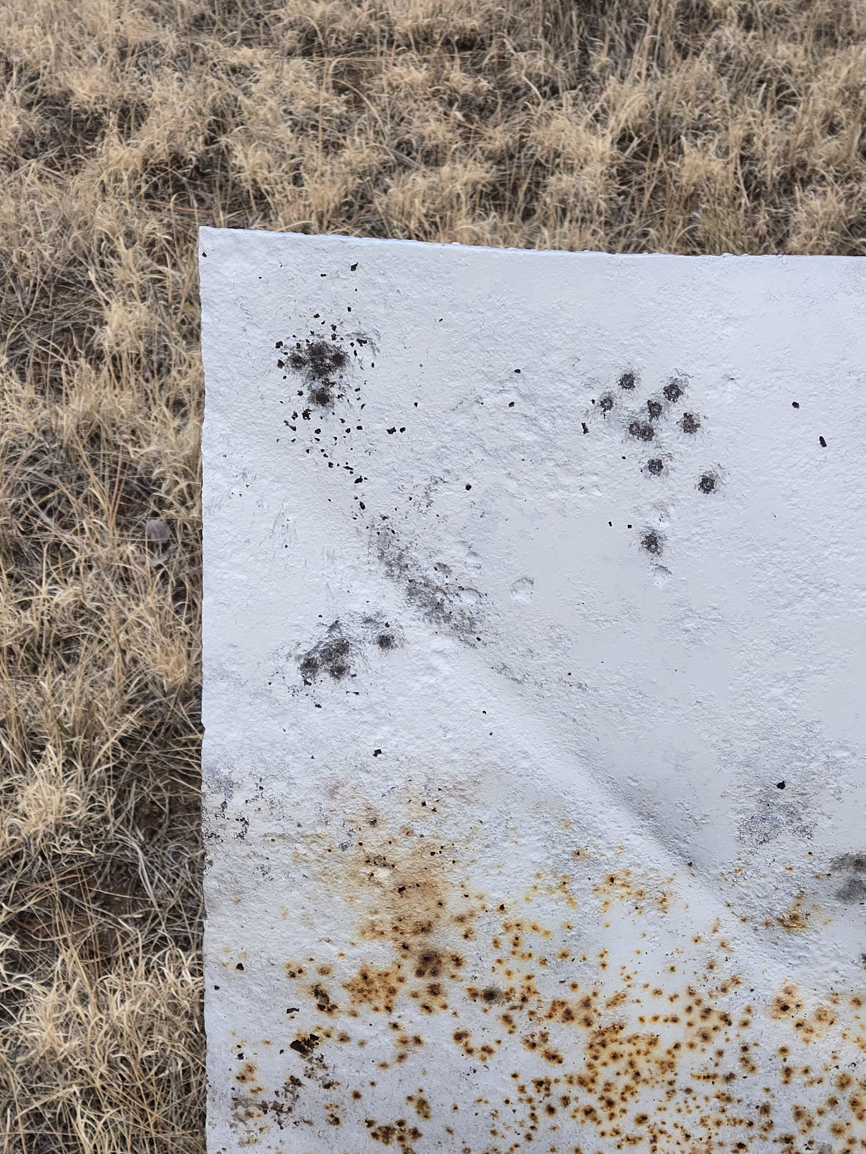

Even though I've shot each one separately at 100Y before lately I wanted to see how these different guns and slugs stacked up in groups against each other. Actual distance was 102Y and the wind was 2-5 mph full value on 2nd day try.

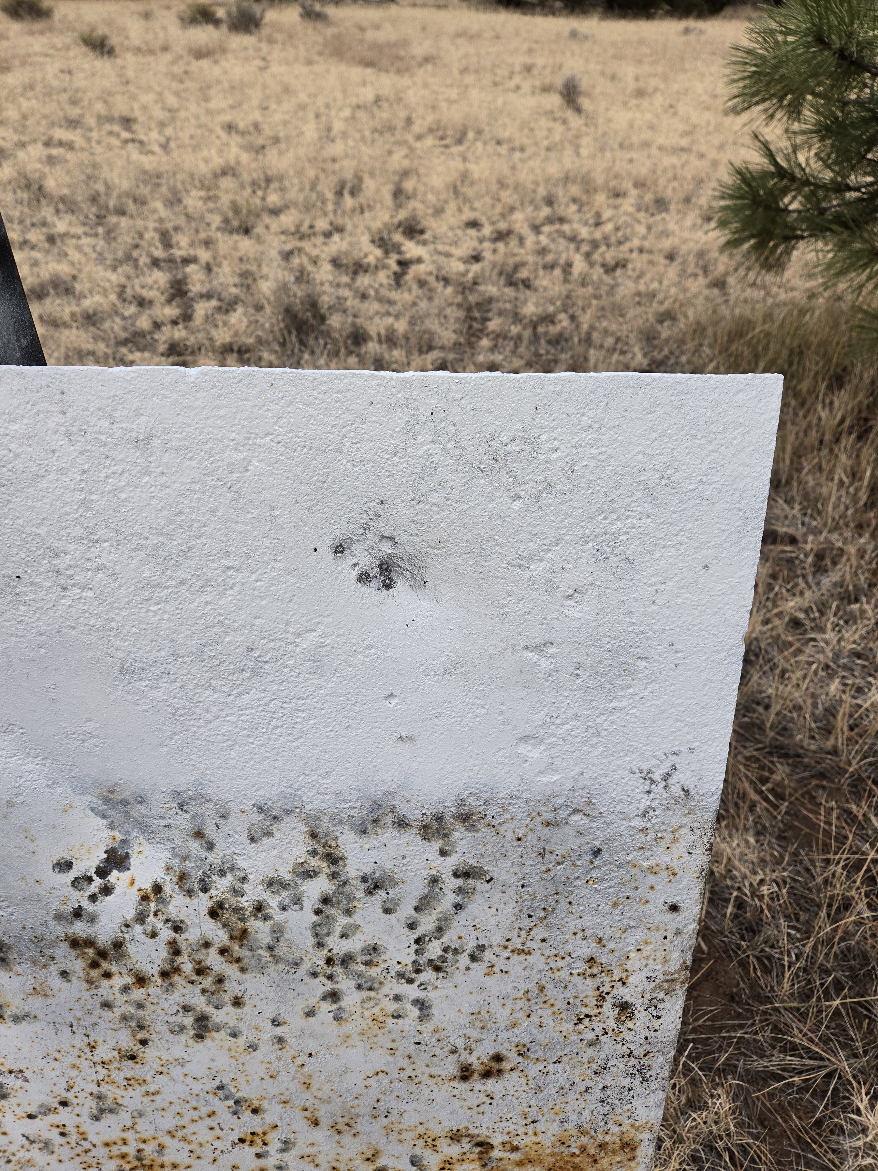

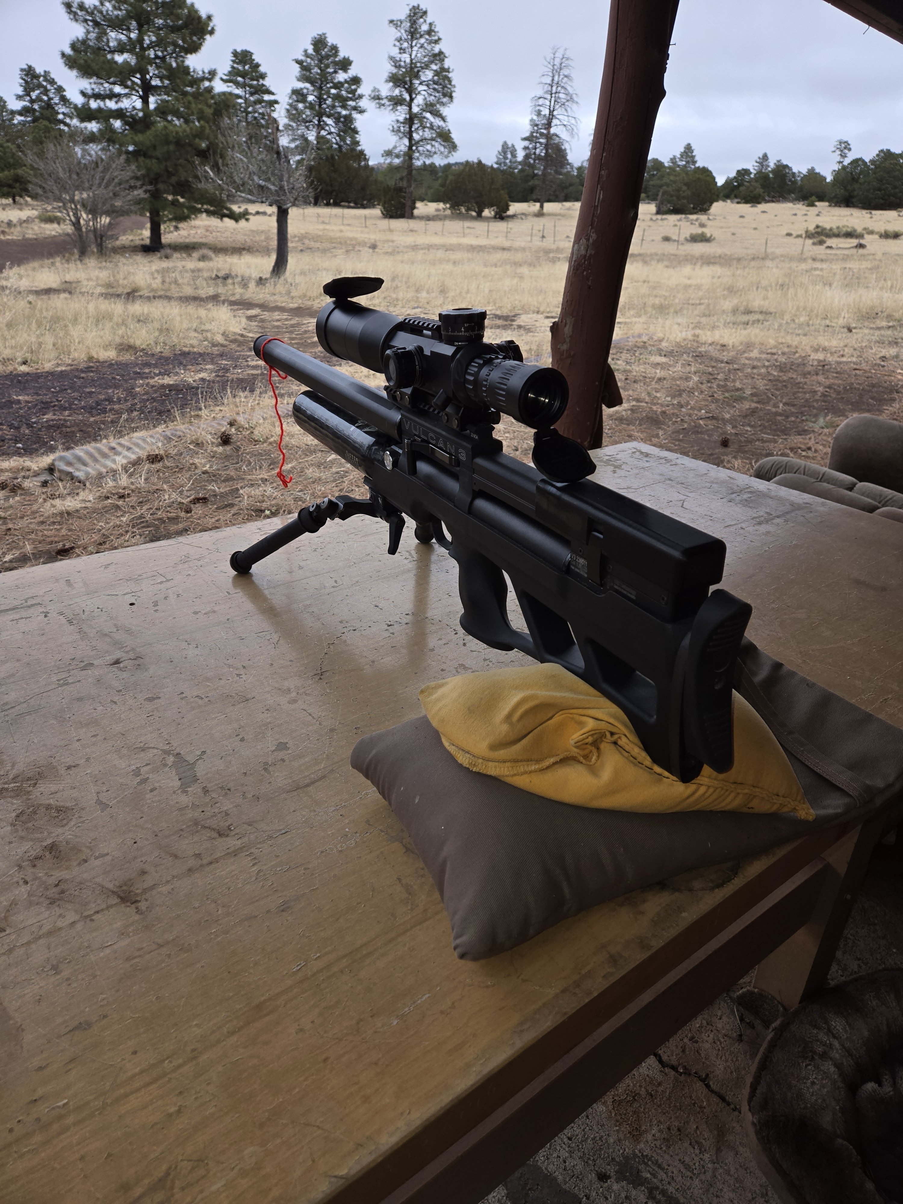

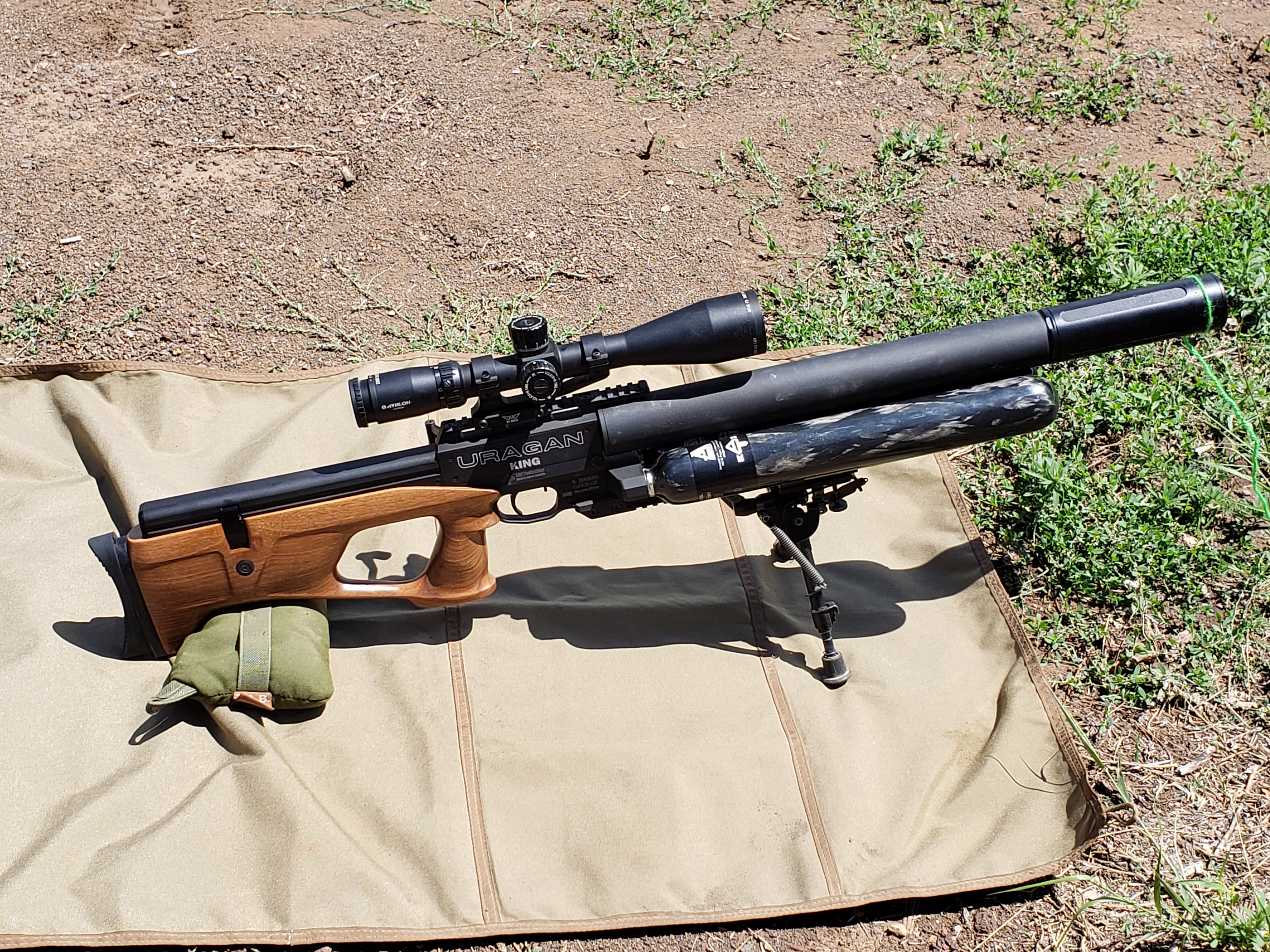

Upper right groups were out of my Uragan King 25 caliber using 29gr NSA slugs/.075 G1 BC at 870 fps/48.75 fpe. Recently I reduced the power down from 925 fps for a different match format requiring sub 50fpe. Looks like I have some reg creep because the first shot would hit way low on day one and day two. The larger group was the day before and twice the wind. Just previous to the smaller 5 shot group on day two I shot a few shots lower into the steel to see how it'd do without them included. I wish this gun shot like the Vulcan 3 does all the time.
I like the King because it's a repeater and it'll do a hundred shots or so without having to refill. I think I better have it get new orings, reg rebuilt, and tuned. I'm considering trying it for a FullMonty 72 shot course at UFT.

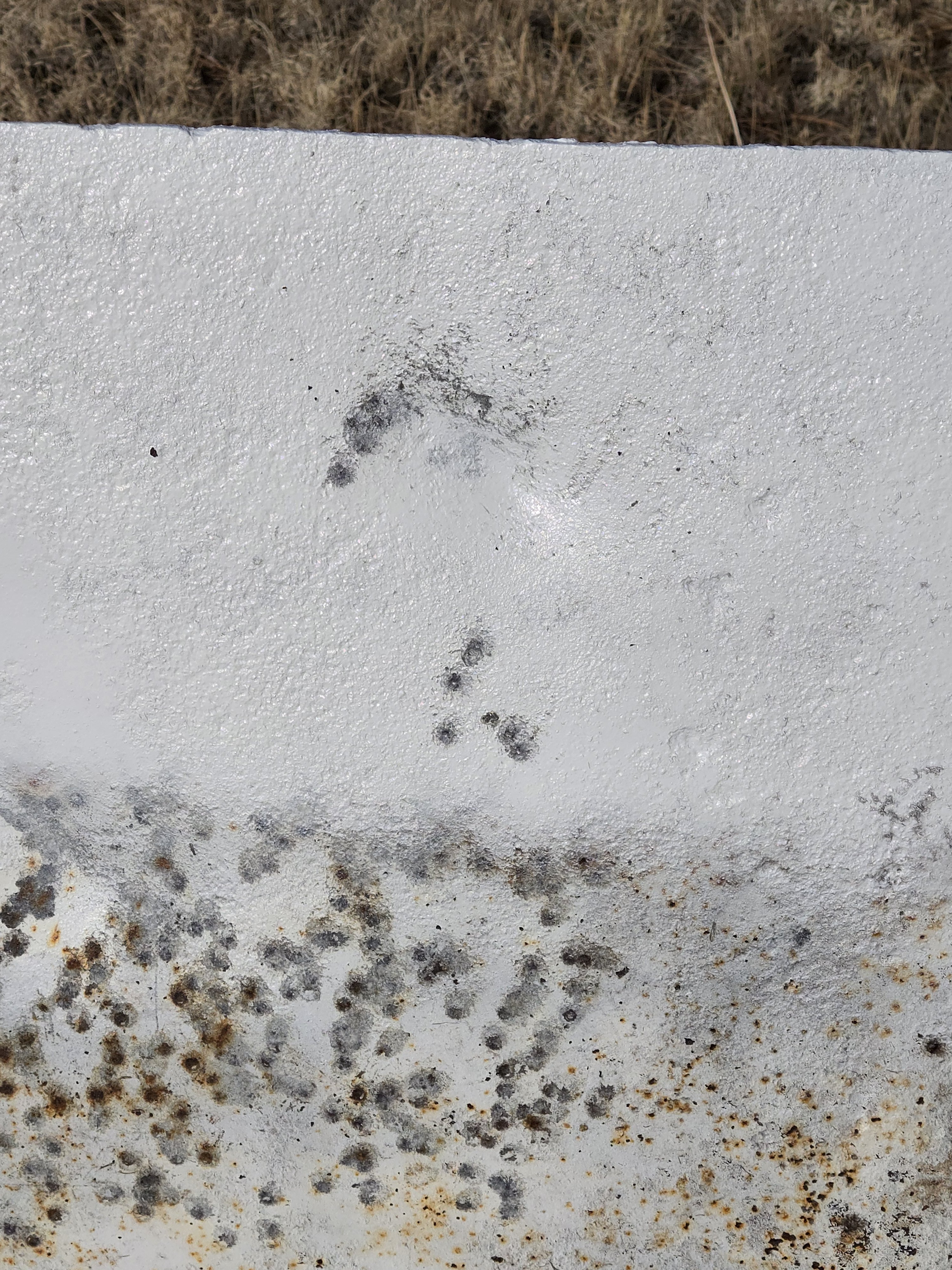

The Vulcan 3 .25 caliber has always been a great shooting gun using Altaros 60gr Queen with G1 BC of .245 at 862 fps/99 fpe. Derrick Wall of Tenacious Airguns tuned it for me and he's a expert. It did the two left groups at approx 1". It pretty consistently does this. Only problem is I have to use this slug in the gun as a single shot only. I've won a few UFT matches in slug division with it. BC, BC, BC and man it knocks down those steel targets hard!!!

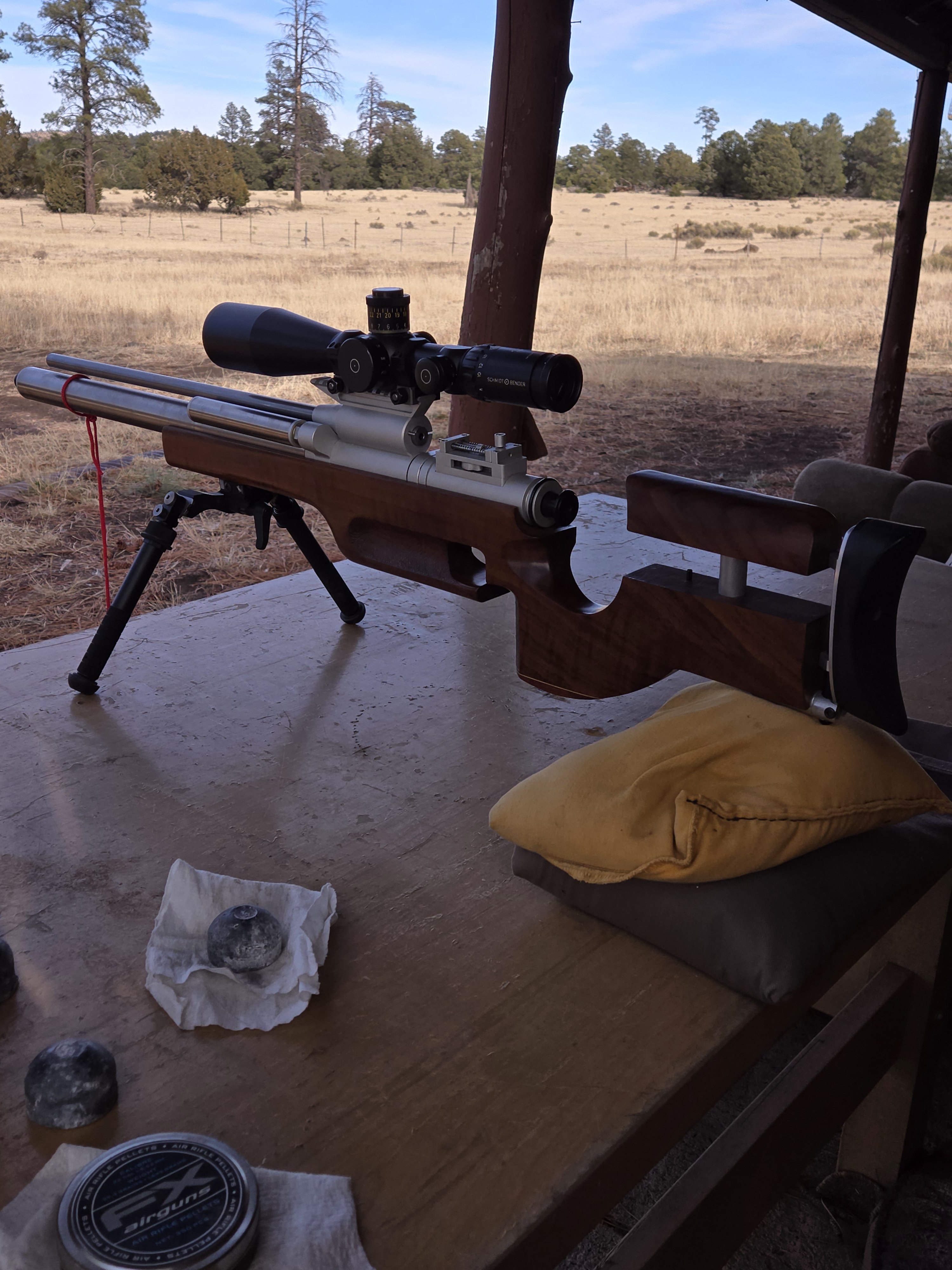

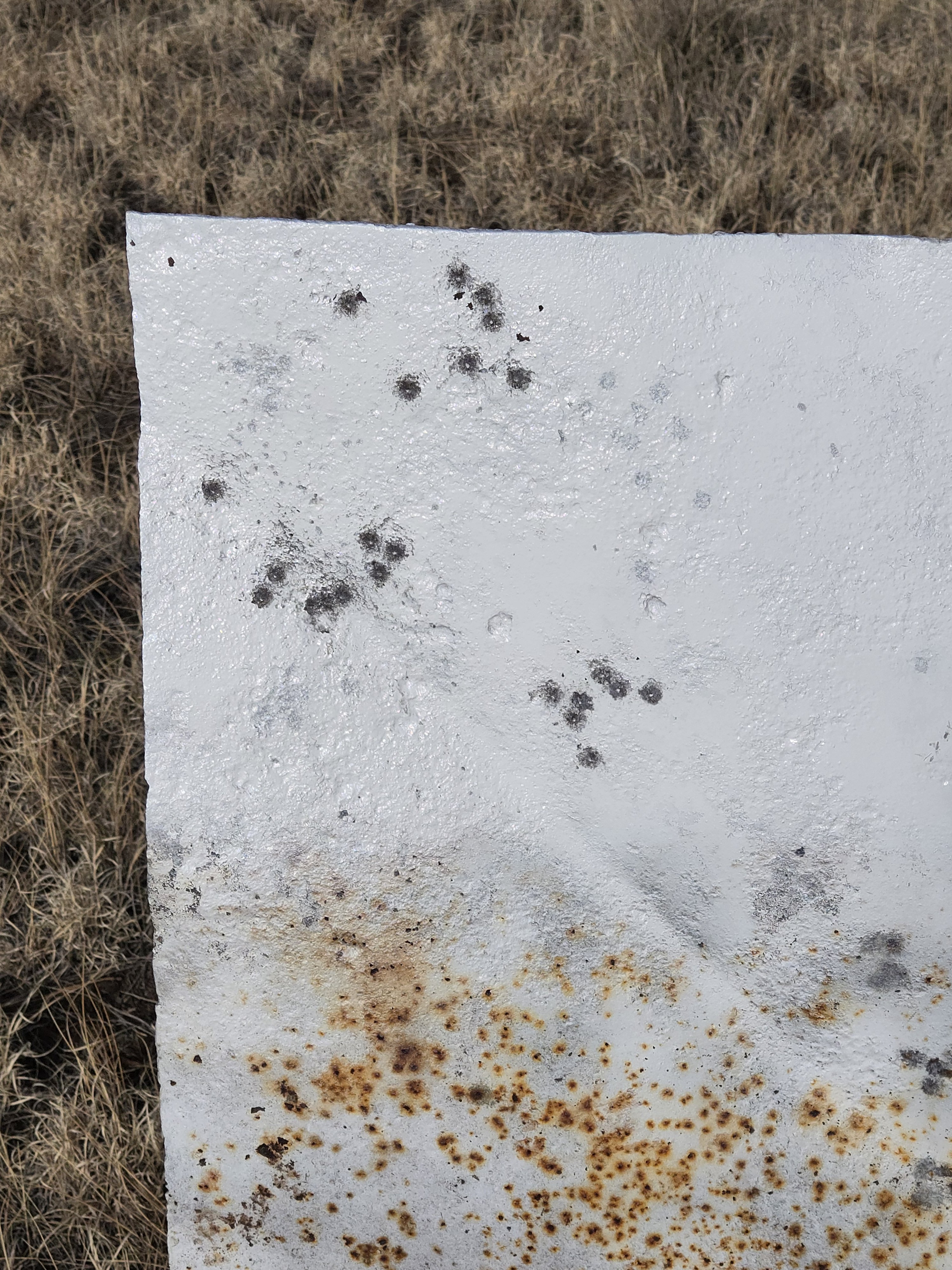

This is my 22 caliber Thomas HPX which was turned down from 880 fps to 818 fps using Altaros 32.3gr Smooth slugs/.18 G1 BC, to meet the sub 50fpe requirement for the UFT FullMonty match. It has a heavy hammer and spring so when shortening restriction screws it's been challenging to get the velocity and the right tune optimal. The gun seemed to shoot more precisely at 880 fps, and was pretty good at 839 fps, but that is slightly over 50 fpe. I'll try different HS settings to look for improvement.
I noticed that the rubber feet on the bipod would slip forward during the shot sometimes and I could see the reticle jump up as well as the POI of that shot go up. I'll try putting a piece of carpet under the bipod this week to see if it helps grouping.
Compared to the other guns this is the heaviest, has the best feeling erogos for me, as well as the best feeling trigger. It's single shot and I hope it could shoot these slugs a bit better with some tuning.
Worth mentioning is this latter shipment of Altaros slugs doesn't fit as snuggly in the chamber as the last batch did???
Anyway now I know why I missed more on the longer targets than I did at last months UFT match when I used the previous batch of slugs at 839 fps.

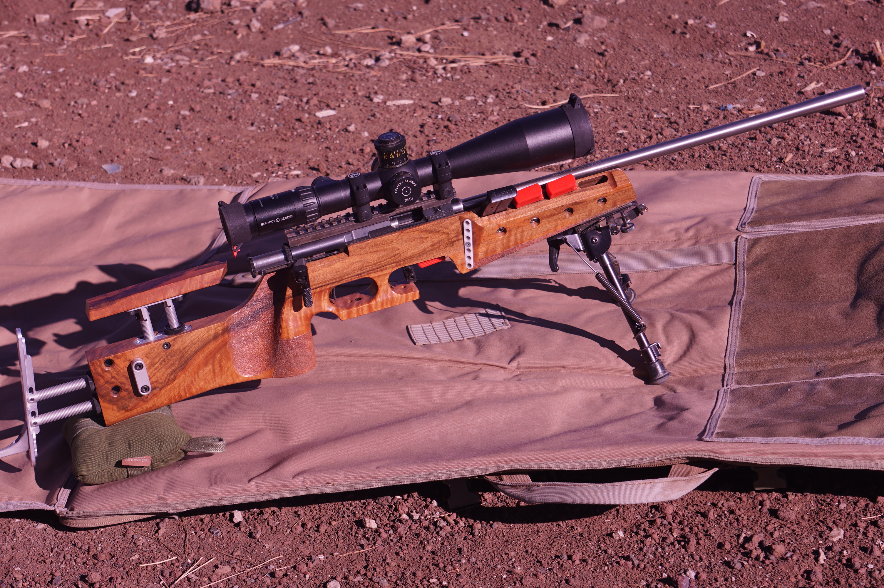

This is my Anschutz 1827F Biathlon 22rf repeater. I used Eley Club at 1065 fps. It's a lightweight gun and not a great BR gun at that but shoots pretty good in spite of using a Harris bipod. The lot# tested Lapua Polar ammo I ran out of shot really well in it but this other ammo works OK for me and it doesn't hurt I got a couple cases of it for a 1/4th price from a old friend. I don't shoot NRL22 matches with it anymore but have shot 10 or so UFT matches with it. It's darn hard for the pcp's to compete with rimfire in UFT.

The lot# of Polar I selected, that was tested at the Lapua facility through my 1827F, shot .9" at 100M for 10 shots. This was done in a funky jig with the gun snugged into a rubber housing sitting in a vise, because they didn't have the actual jig to fit my action, which I though was very unprofessional.
This Eley club isn't as precise as the Polar was however I don't want to spend $20 a box of 50 case price. My premium ammo days are over I suppose.
