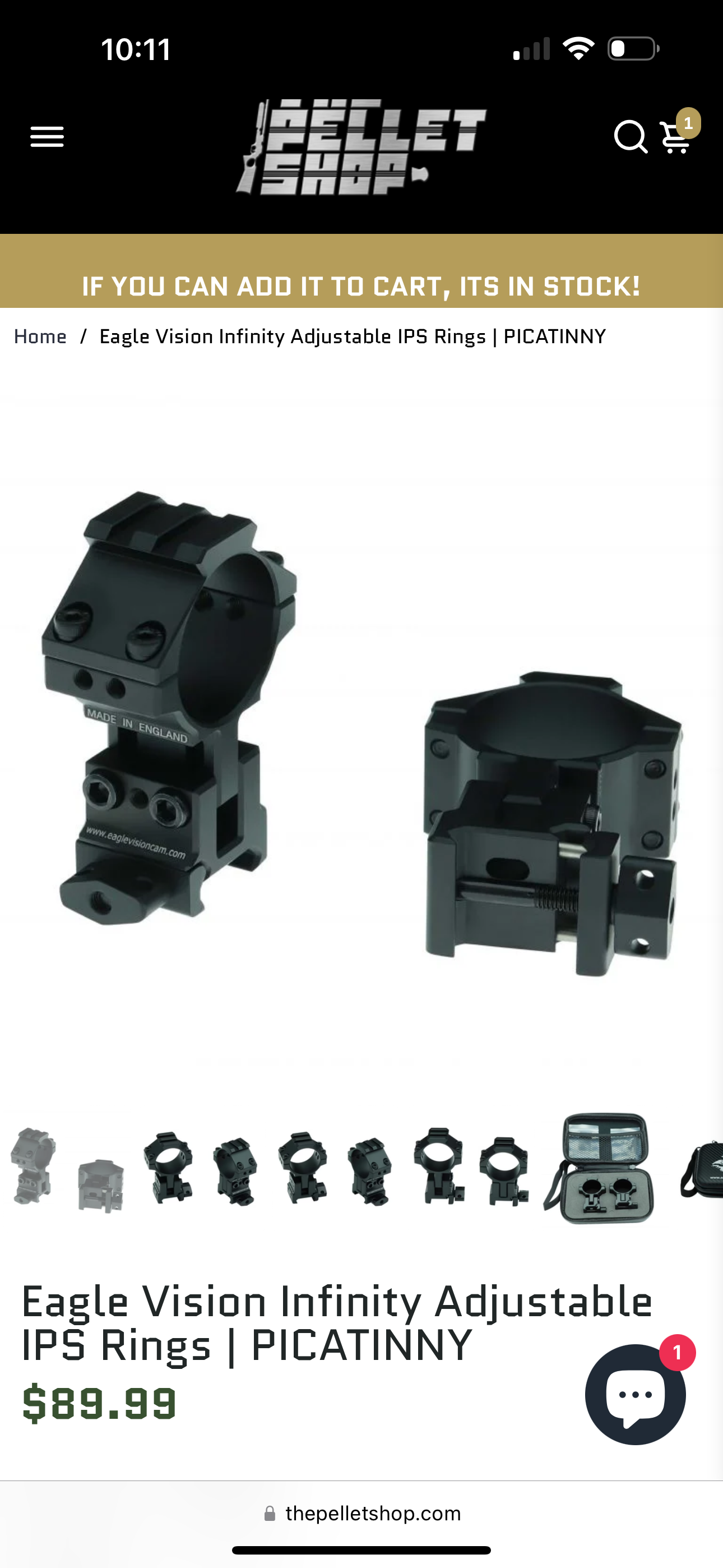

I use this, they are adjustable.
Eagle Vision Infinity Adjustable IPS Rings | PICATINNY​
