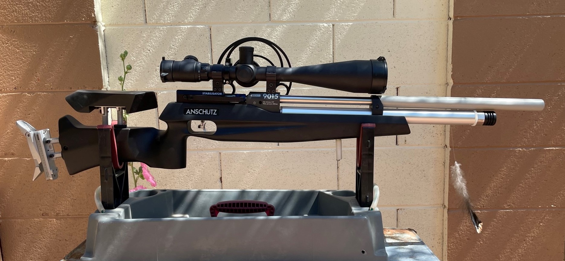

Quietest I've ever heard was an Anschutz owned by @SAZ. It had been hopped up to 12 fpe and full length custom shroud added by Allen Z. Sounded like snapping your fingers.
I fully agree @Franklink as I have an Anschutz 8002 pushed to 16 ftlbs by AZ and it’s only a click and a pffft.
