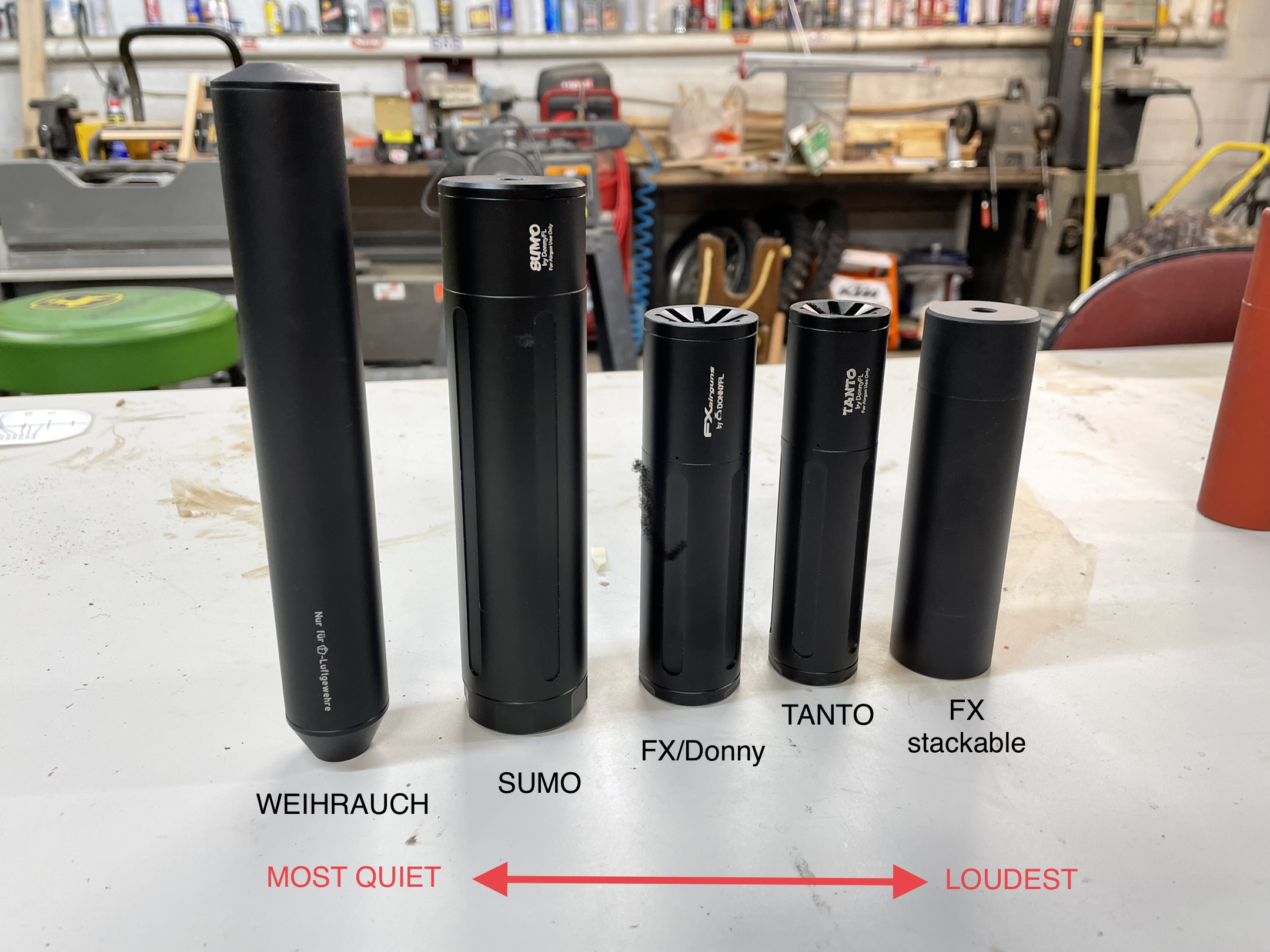

This was a test I did the other night With my my Dreamline classic shooting .177 @ 880fps. The Weihrauch was hands down the winner.
