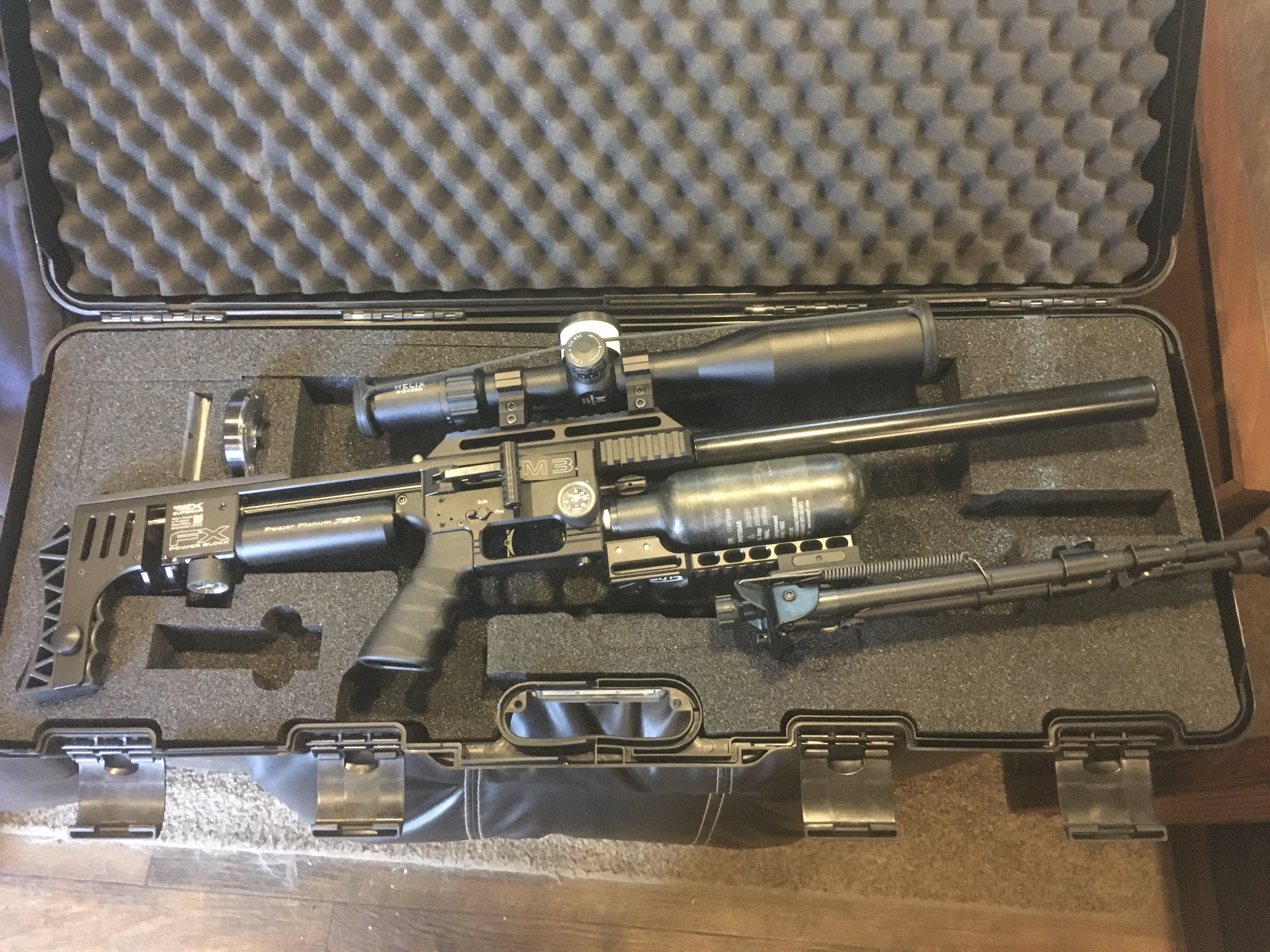

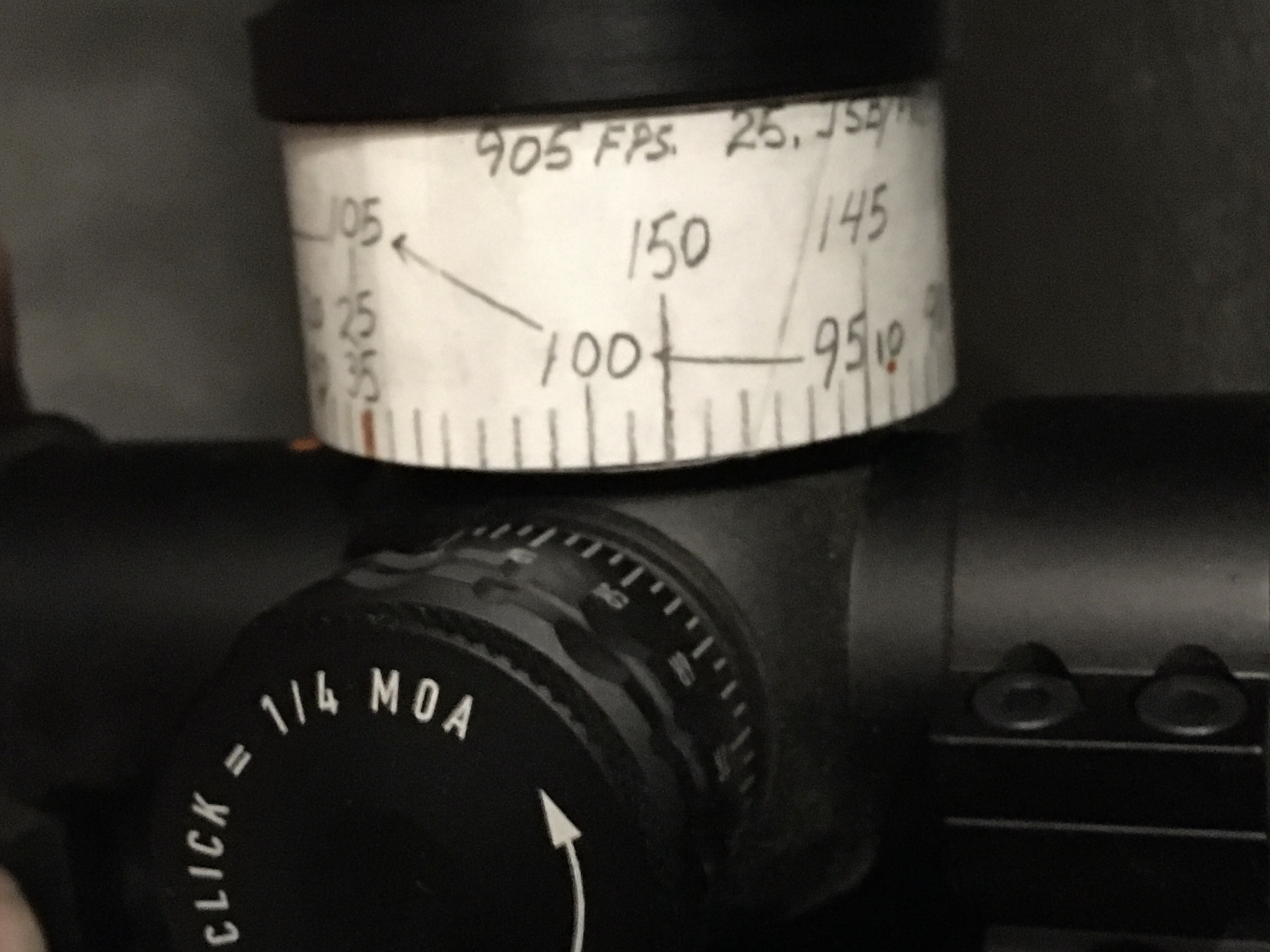

If you want quite. Reach out to Allen Zasadny. You can find his number through the FX dealer listing. He is in northern Idaho. But your going to need to send him the gun so he can build you one. He doesn’t mass produce them. Each one is custom built to each gun and how it’s tuned. Along with the pellets or slug your shooting. It’s going to take time so don’t be in a hurry. He is one of the best out there at age 70. He does most of his work during the winter because he is building a house. He built and tuned my FX. He also did a full ballistics dial for death on it.

My gun took a year for him to build and tune. He completely tears it down and fixes all the issues that come out of the factory. Adjusts the trigger to what ever like. Single or duel stage. I like my duel stage with about 3.5 Oz. The thing is. If he sets it up for a certain pellet. You can never change it or the ballistics will be off.
