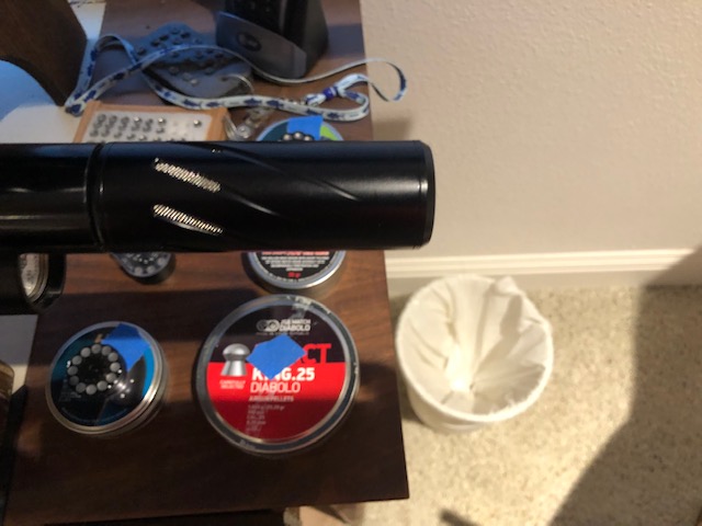

I had a Sumo on a .22 Taipan Mutant. It was quiet but looked like a soup can hanging on the end. I also had a Ronin on a .25 Veteran. Also quiet but way bigger than the Sumo. A friend stopped by to shoot and let me try his Huggett Atom on my guns. The Atom is 3 1/3" long and 1.22" n diameter, almost the exact same size as the Taipan shrouds. You would have to look close to know it was on the shroud. To my surprise, the Atom was noticeably quieter than the Sumo. Was it a fluke? I put it on the .25 and again, it was noticeably quieter. So, there goes the theory that says you need massive volume to keep the noise down. There's no need to ask what's on my guns now.
