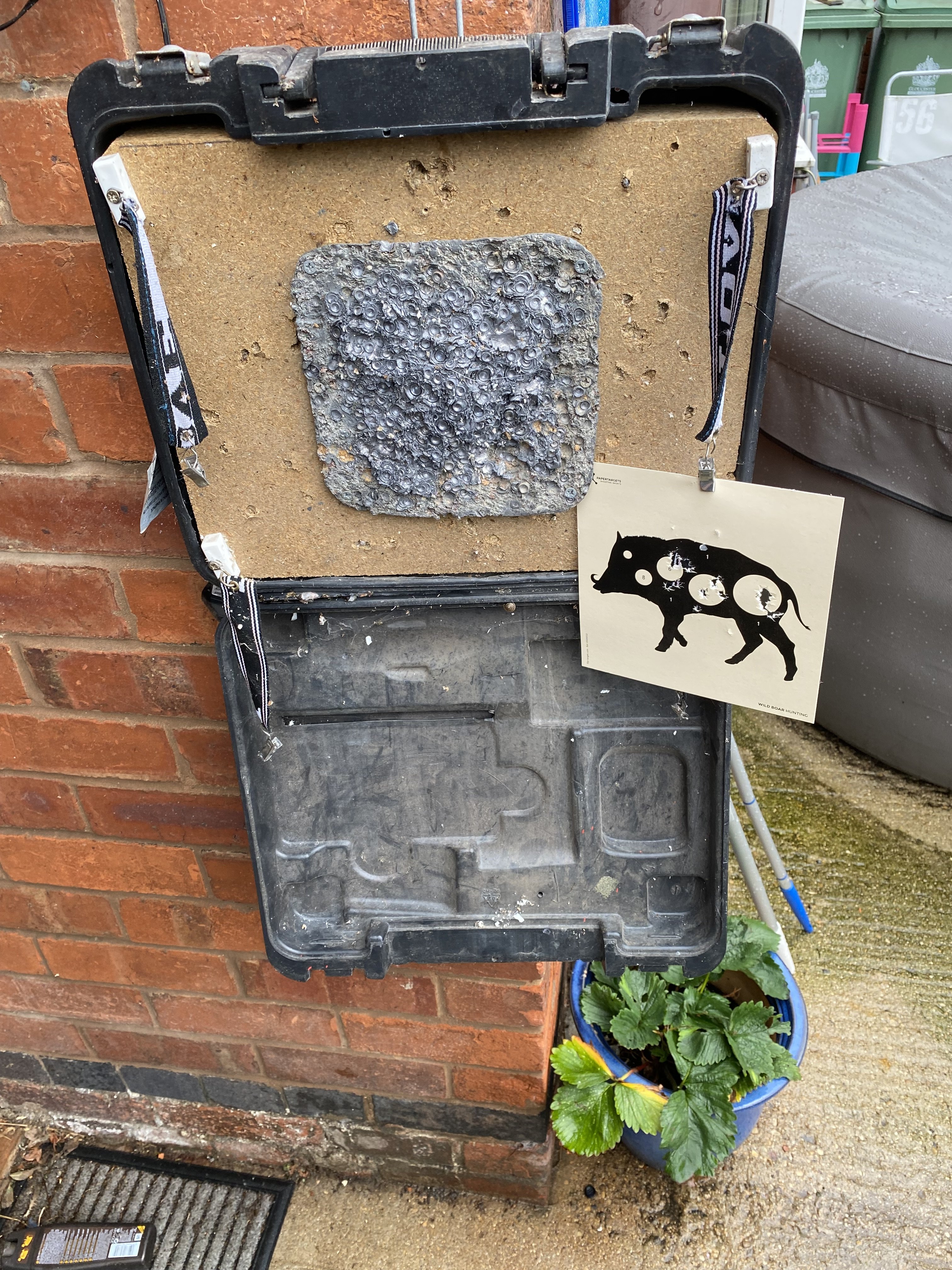

Melt some lead in an old pan (outside please) over a camping stove into a quarter inch sheet and screw it on to your backplate. Quiet as you like and 99% of pellets sticking on impact. When the lead ‘’flowers” build up to a level that they are impinging on your target paper simply melt the whole thing flat again. No waste, no fuss. After a while of slinging pellets at it you will have enough for another lead backplate.
100% recycling. Silent as it gets. No mess. I built mine into old power tool cases.
Genuinely, if you screw a lead plate to a thick bit of ply then your issues are sorted. I can take photos if you wish.

Lead does not ‘ring’ so a dull thud only. Not as quiet as paper (but what is behind the paper?). I can 100% guarantee no ricochets and next to no mess (unlike digging around in a box full of rags) and a lead backstop just self perpetuates and breeds the more you shoot at it. Genuinely the best solution. It’s a bit like a fly hitting an oil tanker.

never thought of it. can you show some pics?
Apologies- bare minimum photo (and target was dialling in a new scope) my lead is in an old tool case. No effort, no muss. No need to listen to an old sod either. It just works. Much like I do.

Honestly look at at my photo above. Lead sheet on a thick square of blockboard is as quiet as you can get. A dull impact thud. Even at high FPE I have never seen a ricochet or pass through. All you get is more lead to make more backstops. It sticks 99% of the time, and any paper fragments that are trapped burn out in re-melting. I’ve used the pictured backstop for many years - have three others now from remelts. Nothing else comes close.
