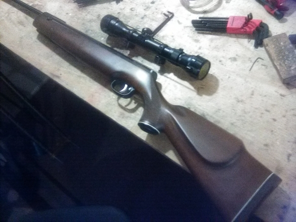

i'm slowly as possible, rebuilding a minty .20 caliber beeman r1 combo that has been laserized. i just want to take it all in and gain every chunk of atrophied piston seal, every dehydrated morsel of the other-worldy lube, and every custom part, into the essence of my being......this is majik.
