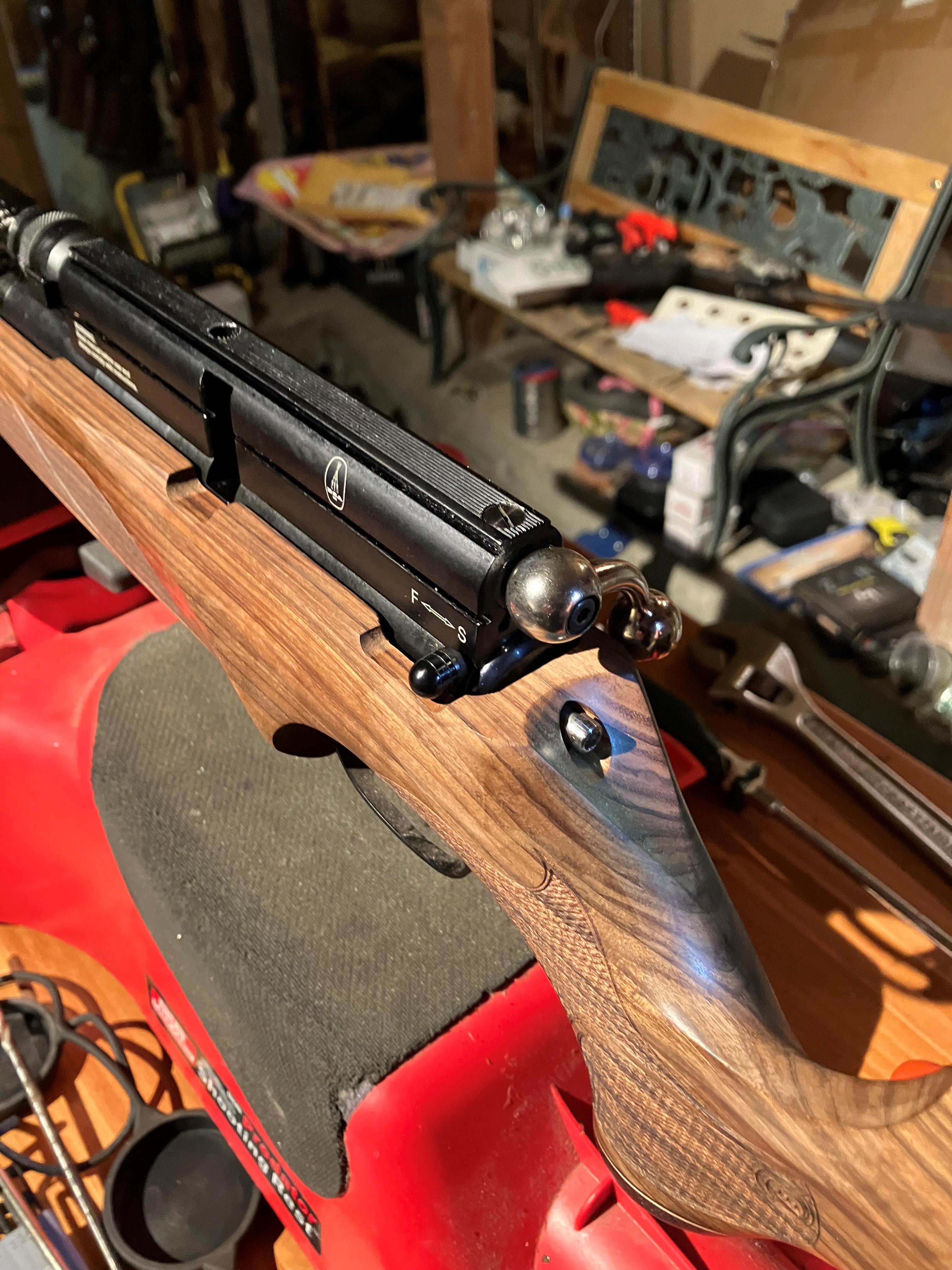

Just got back into the gun after having it sit for 3+ year with a leak - that ended with the bottle breaking off the gun.
After my OEM bottle recently broke off the gun (moisture rot) I purchased a 280CC bottle w/SS connection, made a SSG and new LDC.
