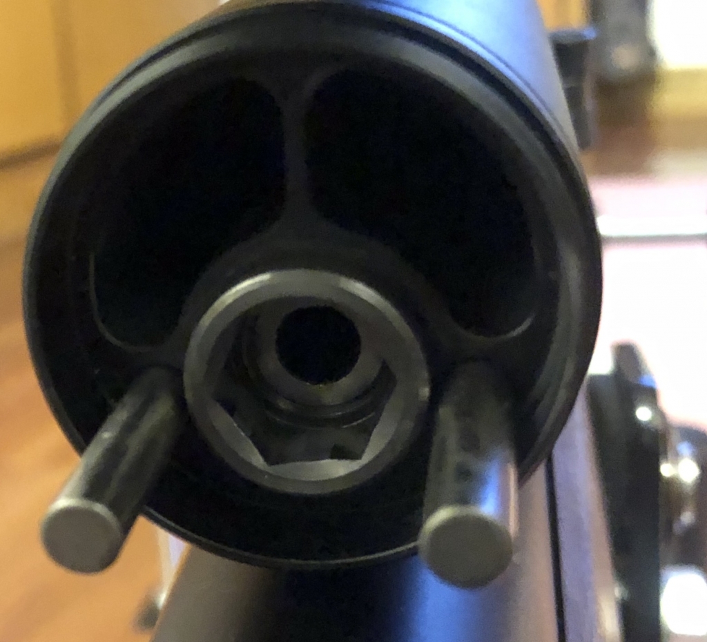

Aloha,
take a picture of the crown, you’ll have to remove the shroud and it’s the end of the barrel.
Aloha,
Keone

hi Keone, which side of the barrel end? you mean the nut side of shround? i mean where the pellets out?
@ JJ,
The crown is the very end of the barrels transition spot. The muzzle. The last thing that the pellets touch when they leave the barrel. It needs to be at correct angle, smooth, no burr or lead build up.
Instead of the 25.39 long ones get the 25.43 Kings and try at exact same setting. I personally don’t think the ones you’re having problems with work as well as Kings. You could just have a lead build up.
Just checked the alignment of the barrel, it's perfect as what i aligned last week, no change, there is no burr what we called crown, and very smooth...
maybe a deep clean of barrel?
Can't see the ends of the rifling of the barrel in that photo. Can you remove the silencer?
