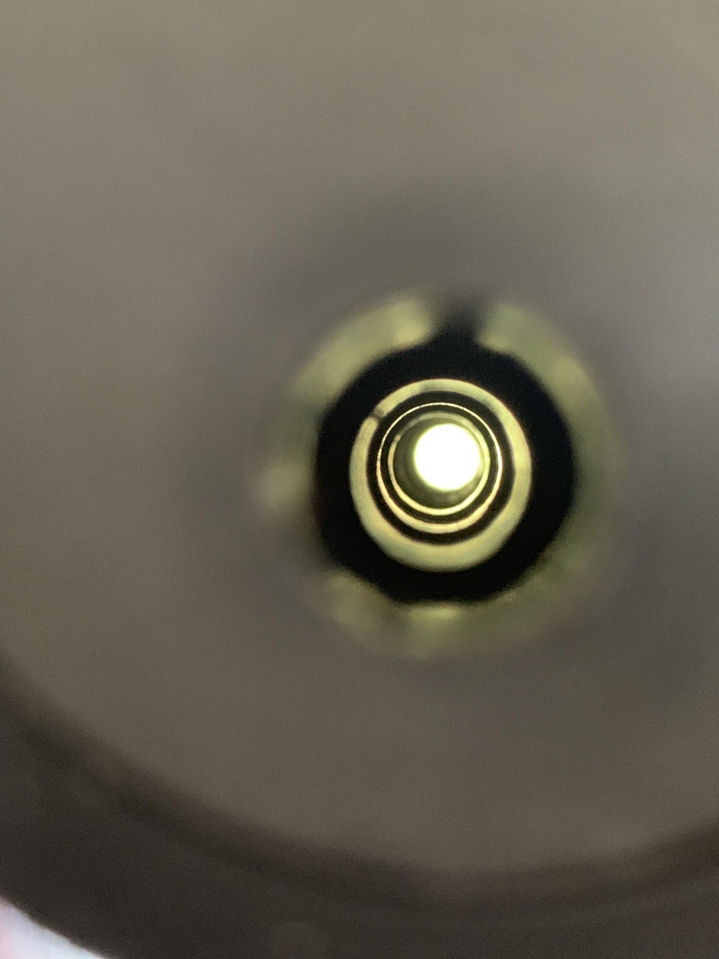

It sounds like clipping to me, I’ve recently had the same issue with my R5M in .22 std. I loosened the 12mm barrel nut and aligned the barrel with two 5.5mm drill rods in the shroud holes. There is a good thread for the process on the forum, I did however end up getting the Bat mod for it, $150 bones, aluminum baffle stack is nice and it’s very quite, the anodizing on the long tube it comes with isn’t as good as the factory baffle tube though, not a big deal but still for the money it should be better. Attached is a picture of my misaligned barrel with factory baffles.

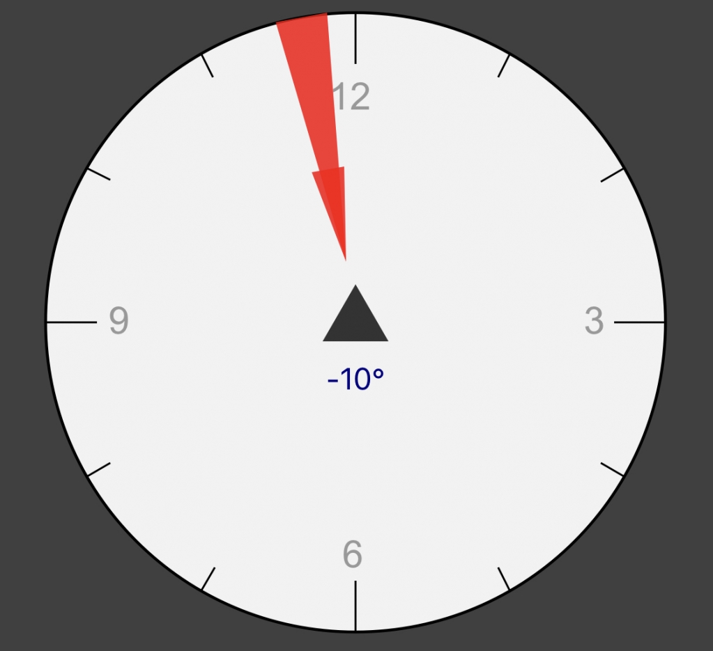

I just checked the barrel alignment, it rotated about 10 degrees to the left, show as the pic,
i suppose this caused the POI shift by reinstalling the baffle stack, because of the small movement of the plastic stack, there will be a light slapping between pellets and the stack, this will not only cause POI shift, but also the accuracy at long range, because the shape of pellet should be changed after the slapping, i will try the procedure to align, and thanks guys.
