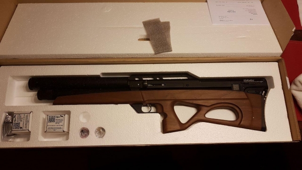

Hi again, I finally got my R5M !!!!!!!!!
But I need your knowledge and experience to try to get the sweet spot on it, the Edgun representative here in Chile is going to install the Huna reg and my intentions are tunning it to shoot the JSB 34 grains.
As I looked above in the thread JWilson's last setup was reg pressure on 125 and 3 clicks away from peak on the HST right ?
How is everything right now any new discovery or pics with group sizes anyone ?
I'll wait for your coments and thoughts, thanks
Leave you some pics of my new beauty !!!
