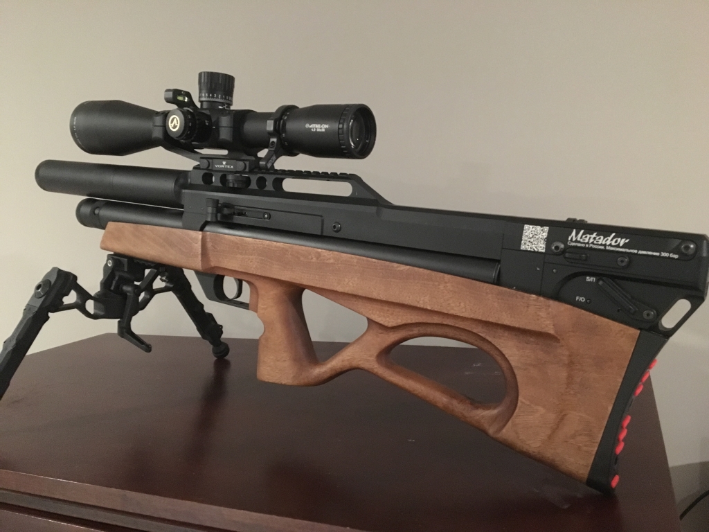

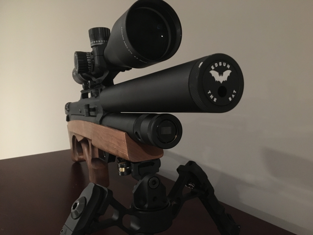

My .22 cal New glass, New BAT mod, tuned for 22 gr VK and FX slugs (.217 is best is you want to shoot NSAs) at 940 fps.
These are very tunable guns, and you can throw in a Huma reg for a power upgrade. Trigger can be tuned to less than 1 lbs...
Ridiculous quiet with the BAT. Very accurate. Pic of groups at 50 yrds with the FX hybrids. It will do this all day long.
Easy to install a rail for bipod... Edgun West has a Jig and will do it for 30 bucks.
Scope Athlon Ares ETR 4.5-30 x 56....
