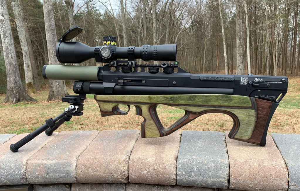

I own both the R5M 22 long and R5M 25 standard as well as an R5 30 and Lelya 25.
The R5M Long feels at home on a bench or shot from some sort of rested position. If you’ll be plinking a majority of the time, the long is the way to go. The long isn’t as comfortable or maneuverable for off hand shooting as the standard.
I prefer my standard for hunting. I prefer my long for bench shooting.
The long offers higher velocities right out of the box. Mine was shooting the 18’s at 1180 fps before backing down on the HST. It’s more than capable at shooting slugs in this configuration.
The trigger can be adjusted to have no creep. You aren't going to make it a super match grade, break at 12 ounces or under trigger. I've found if you try that it is not reliable and can be dangerous as it can be bump discharged. With that said, I've gotten them to 1 pound pulls that are safe and reliable. This is fine for me.
I agree (in my experience) it is a hunting trigger. I played around with mine for a long time and the trigger can easily be made dangerous, going off with a bump. It is not a match grade trigger by any stretch of the imagination. I finally got mine safely down to about 1.5 pounds with 2 stages. Long first stage and a clear crisp break with very little creep on the second stage. Once I got it there I put nail polish on it to keep the screws from backing out or moving in any way and it has held for about a year. How Steve came to the conclusion in his review that it was a match grade trigger, I have no earthly idea. Hunting trigger yes … match grade, not in reality. If Ed were to make this a true match grade trigger, he would NEVER be able to make enough guns to keep up with demand
The gun is capable of pretty good accuracy with the norm being approximately .5" at 50 yards. I did have trouble with the accuracy for a long time until I was informed by several members of this forum that the 12mm barrel tension lug … easily accessed by taking the moderator off … played a huge role in the accuracy department. My tension lug was so tight that it was pulling the shroud down almost to the point of touching the air tube. I backed it off to about 10 lbs of torque and the accuracy dramatically improved at once.
I love my gun, the looks, the feel, the accuracy, the ruggedness, the ease with which it can be worked on, the simplicity of the design, the accuracy of the EDMU, the shot count … the gun has a lot going for it, however the trigger IMHO is the only element that could be worked on to make this the best gun in your arsenal

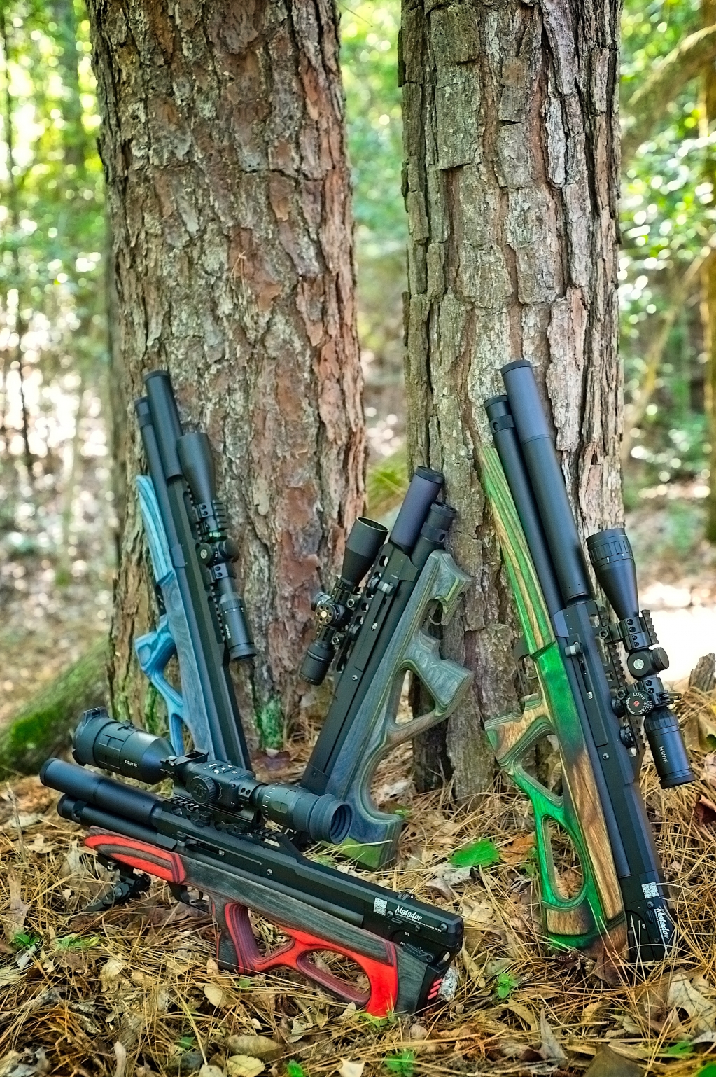

Here are my edguns , I my self bought all long models and I am a hunter , I also wanted the longs for extra shot count and extra power , I feel they have more to offer and if you shoot at a lower power you will have alot more shot count in the longer models .
R5M LONG .22 cal
R5 long 25 cal single shot
R5 super long .30 caliber
LELYA2.0 .25 caliber
LESHIY 350mm barrel ,22 cal
P/S If I had none and was starting to buy now , I would still buy the long versions , I find also with longs if you shoot at lower powers there is 0 harmonics , I seen people talking about the triggers , When I got my first one it was hard to use but now I love the trigger and yes it is a HUNTING trigger , , They are durable guns and alot of power and shoot most any ammo well , in 22

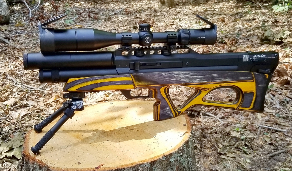

I was lucky enough to get one of the laminate stock versions, the last yellow and black one from EDgun West. It's an R5M standard in .25. I wanted to have the short overall length bullpup for easy/quick handling in the EDgun padded green soft bag storage bag and in the field hunting.
The shorter length makes it a bit more wobbly when shooting offhand, requiring good technique or an object to brace against. Brian at EDgun West can install a short picatinny rail on the forearm very inexpensively to which you can attach a bipod that adds mass to the frame to smooth out some of the wobble and of course for shooting from braced/ rested positions.
It's a hunting trigger as already thoroughly described, I made several adjustments until I was happy enough with it. Have not tried polishing the sear engagement surfaces - that may come sometime in the future. I have been satisfied with it as it is.
The smaller reservoir of the standard is relatively easy to top off with a Hill MK IV hand pump, which was important since I do not want or own an electric compressor at this point. My companion Leshiy (.22, 350mm barrel-awesome with JSB 14.3 BTW) is even quicker to fill with a hand pump.
The stock comes off quickly with 2 screws for HST adjustment. The hammer spring adjustment screw is detented, allowing you to count clicks for reliable power changes. Be sure to keep notes on how yours is set or you can use a chronograph for repeat adjustments. The rear bolt block removes easily with one extra screw to allow barrel cleaning and polishing. I had to do some careful filing and fitting of some folded metal on the bushing of the rear bolt block to allow it to slide on and off the breech without tapping. The moderator unscrews from the muzzle end very quickly and conveniently for the same purposes.
I had a little trouble with the electronic gauge at first. The battery had run down and I had to replace that, then reset it a couple of times after installing a new battery. I don't find the advanced electronic functions helpful at all, I just tap it every now and then to read the pressure in BARS.
I mounted a vortex diamondback 6 to 24 by 50 ffp scope with moa reticle and adjustments. Very nice setup.
Some other nice features include slots for storing 3 magazines inside the scope rail and the lugged stock which makes a nice upside down carry handle.
