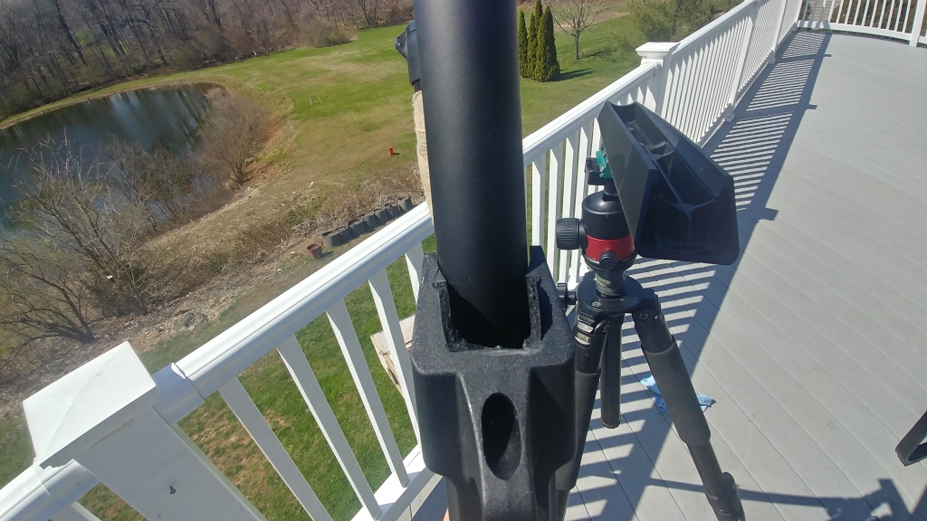

HI today went out shooting some HN 30 gr slugs with My R5M first group 75 yards second group 150 yards , all shooting done with out holding for wind , and this was done with a Second focal plane scope ,I am trying out ,Swarovski Z8i 4wl reticle , when I went to snap pictures of targets , Gun was on ground while stock was in tripod still , it just fell apart , time to email Edgun west . ugg , luckily scope did not get damaged , boy this is accurate gun , tomarrow I will post more groups LOU

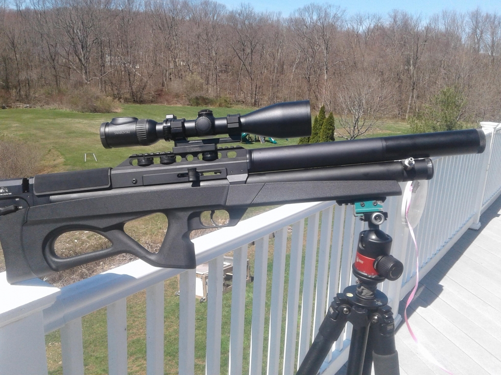

scope reticle and mounted on gun
I support all my guns on a tripod no it should not fail , it is only balancing gun , no force , ed did a Video of them running over gun and his friends jumping on the stock , so no it must be a defect , I did messege Brian at edgun west , to see what He says LOU
These were EDs Videos , they could not break one trying to , mine broke balancing on tripod ,I know ED builds strong stuff this one must of had a flaw when molded look here

IDK. Was the gun left suspended..IE the butt-stock not resting on anything..just hanging? You are putting a lot of pressure on the stock joint..not sure how large the connecting pieces in the stock are, but I would doubt they were designed to support a 12lb-15lb hanging weight. Even if it wasn't "hanging" at the time of failure, carrying or manipulating the gun with the weight of the tripod would put a lot of torque stress on the joint, too. Not criticizing..just an observation.

well gun only weighs 7 pounds and scope I had was only 24 ounces so under 9 pounds total ,it was just balancing with barrel to sky when I got back from target , the forum of stock was in tripod and the gun and back part of stock and scope were on ground ,
MTN Ghost , I was soo happy EDgun came out with Synthetic stock for same reason as I am a hunter , maybe this is a fluke , we see what Ed and Brain say , I really prefer the Synthetic stock my self , So I am hoping he says it is defective , You see , I never used a Tripod in my life , Until , I started having issues with my hands , I had a few surgeries and they still not good , so for me to shoot I need to use my tripod now , so it is either use tripod or dont shoot so I use tripod ,

I think that was awfully nice of Brian to warranty the stock. I am sure that the post on the forum may have helped influenced his decision to do so. I think he’s right/fair to only offer it once.
The only stock material I would trust to not fail on your method of set up is a cnc or forged aluminum chassis, and possibly a carbon stock. Come to think of it, you would benefit by removing a mm or two and laying up carbon fiber, or fiberglass in the tube channel.
Regardless if it’s an Edgun or Evanix, the tripod support is stressing a small and vulnerable area to cantilevered stressors. The material in that area of the forearm is very thin. Even if the stock had a void created in the manufacturing process, I would think it could happen over and over again.
