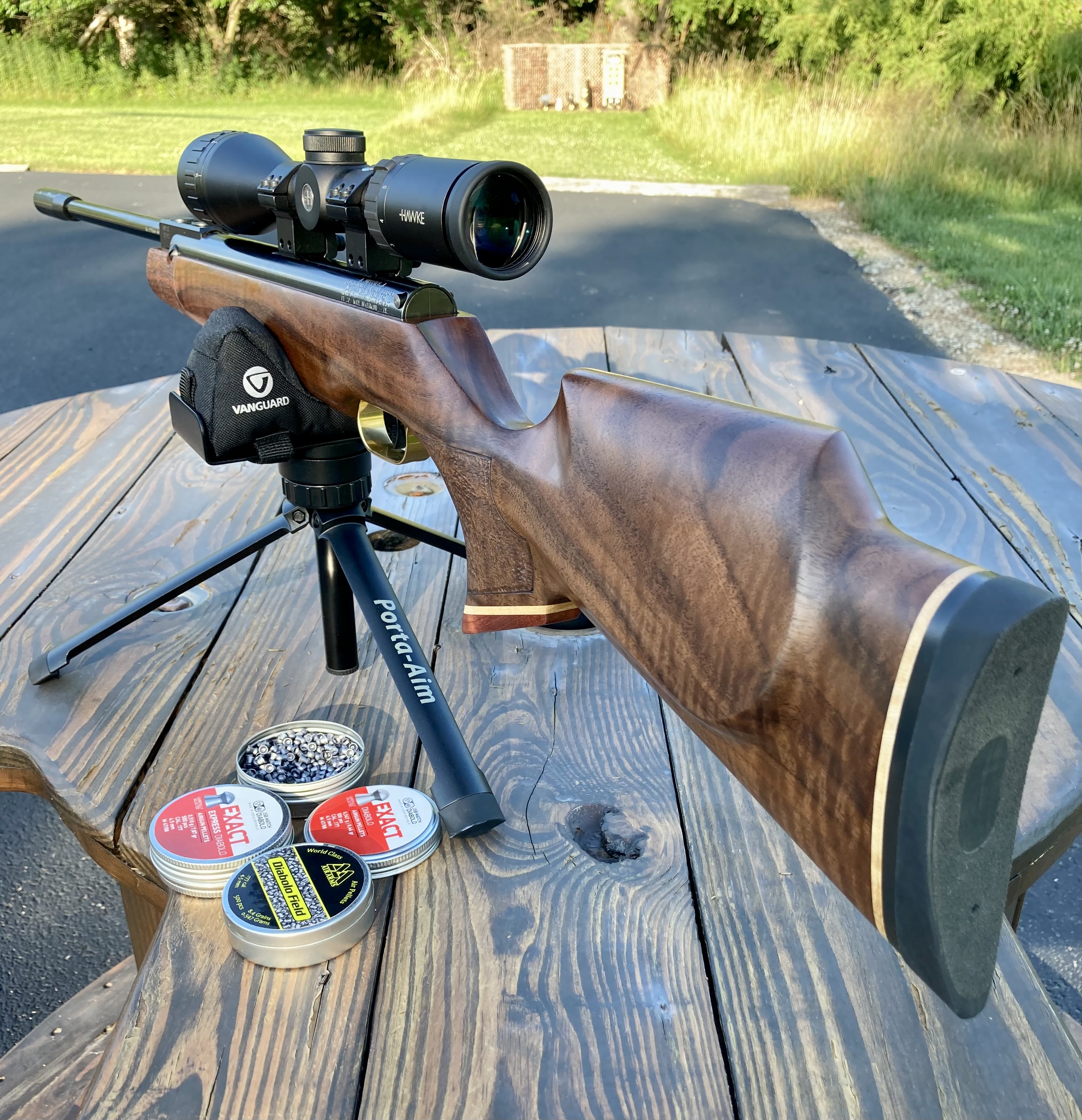

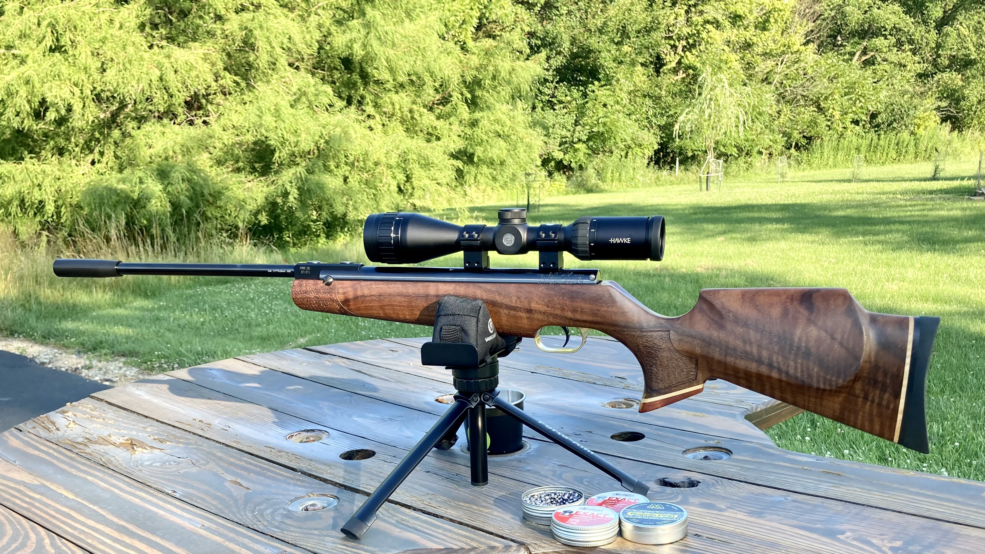

So I finally got around to installing a Vortek PG4 kit in my .177 R7 that's been sitting on my desk for way too long.
Here's the results. String 1 are Crosman CPHP 7.9's and String 2 are JSB Diabolo Exact 7.33's
When I pulled what I presumed to be the original spring and seal, my shot strings had extreme spreads in the low 60's FPS and standard deviations 16-19 FPS.
The shot cycle is very much improved with a quick thud and that's about it, along with much improved accuracy and grouping. Not to mention this little rifle is now an 8-8.5 ft. lb gun after the spring kit.
