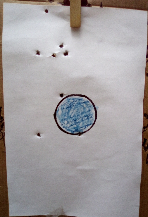

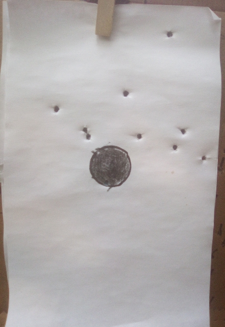

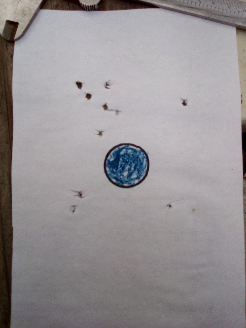

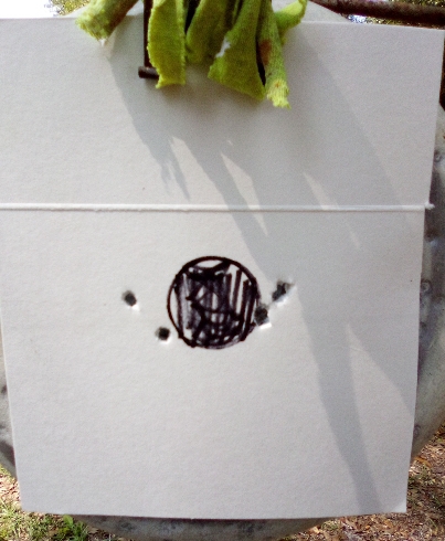

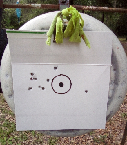

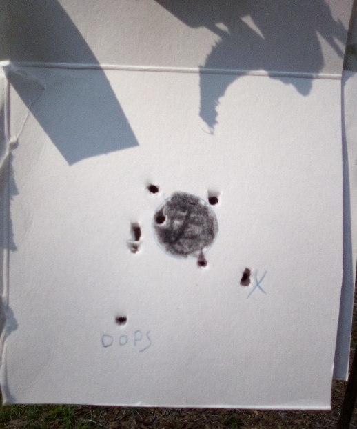

Have had a number of those days....as I get older, they come more often !! Just shows you are a human !!Day not improving woth thunderstorms / flash floods , but figured may as well do somthing so a quick 100&75y
Seems i could not get things " right" today

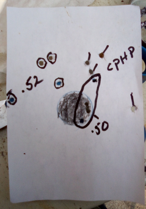

R9 , 75 & 100y , talos @8x, .177 cphp.
75
100
I try , i fail... Always tomorrow.
