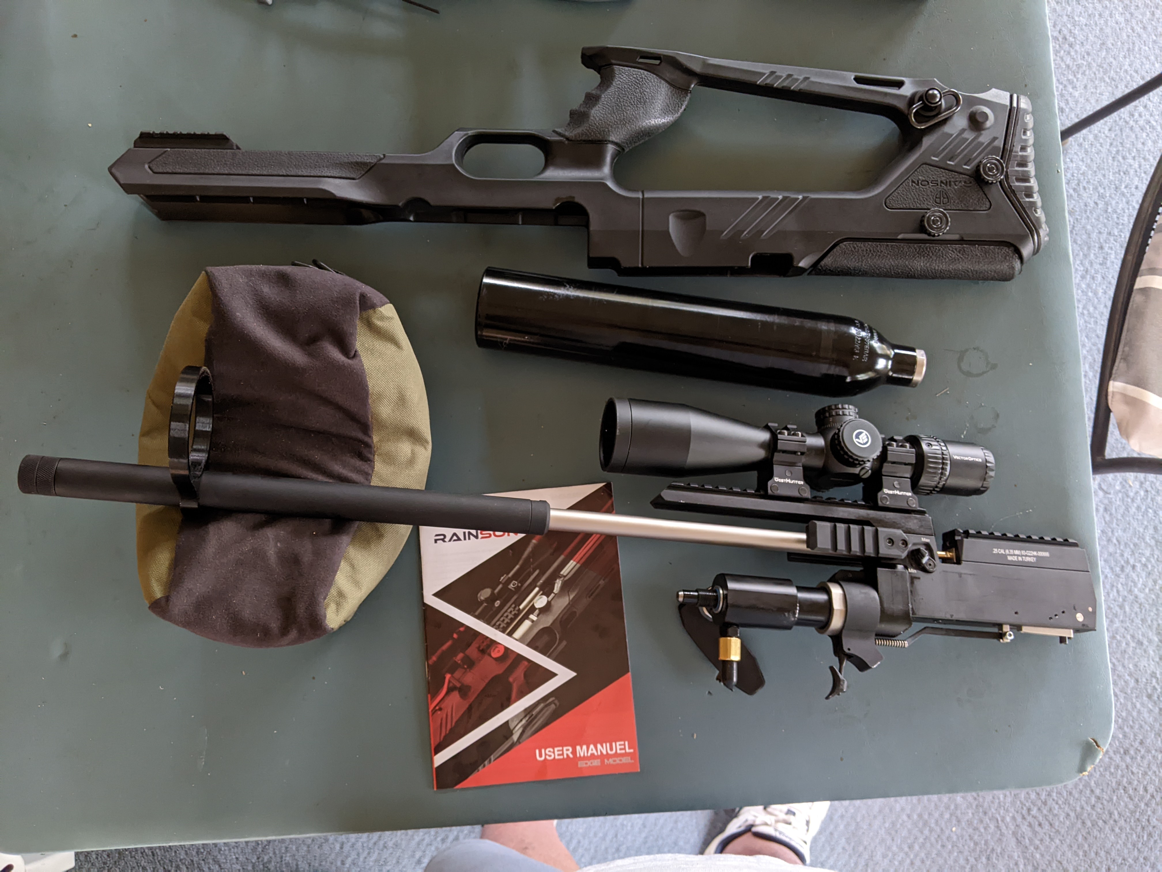

The gun, disassembled. Note: 'User Manuel'.

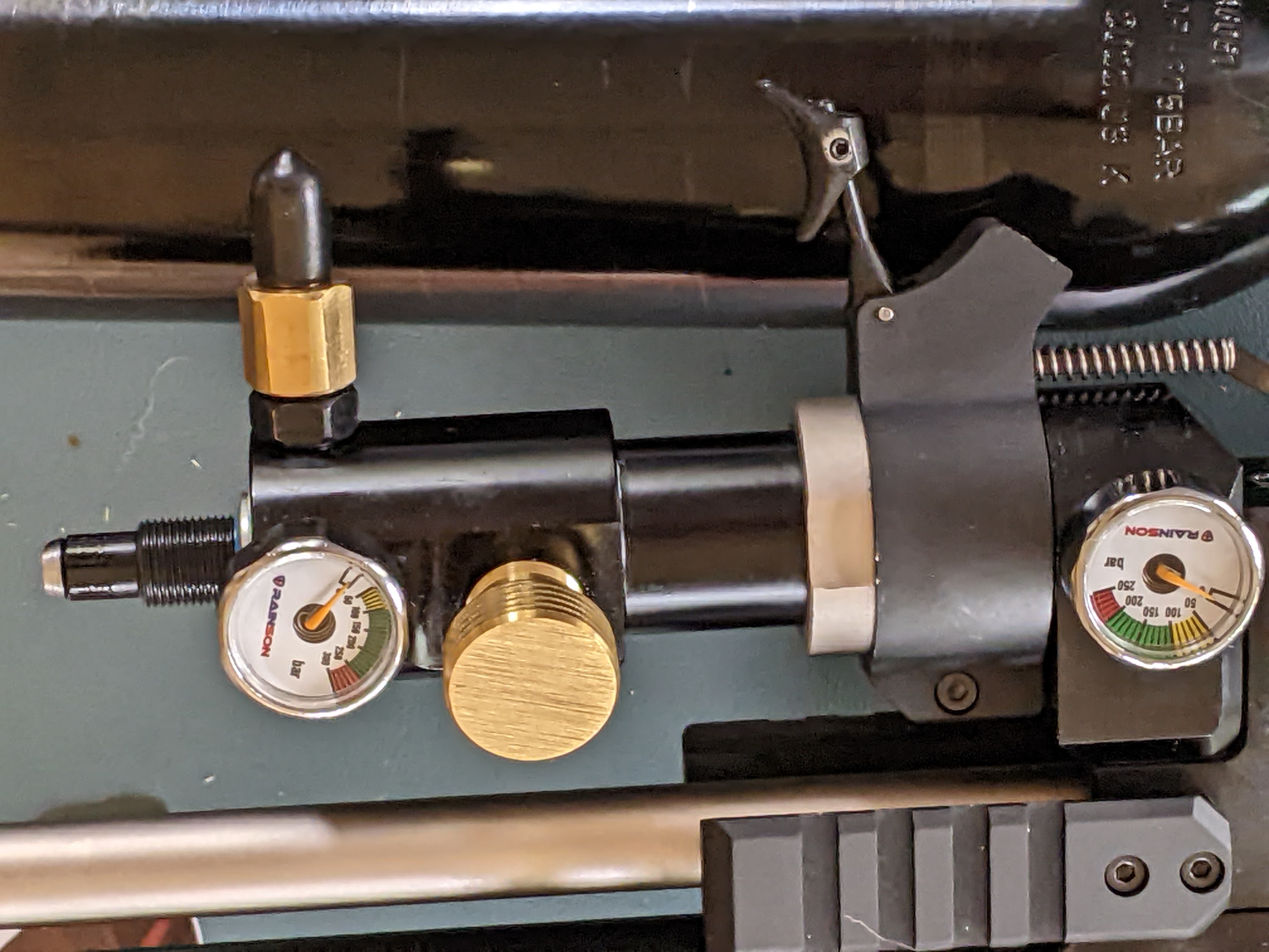

The plenum and regulator, The brass knob is the regulator adjuster.

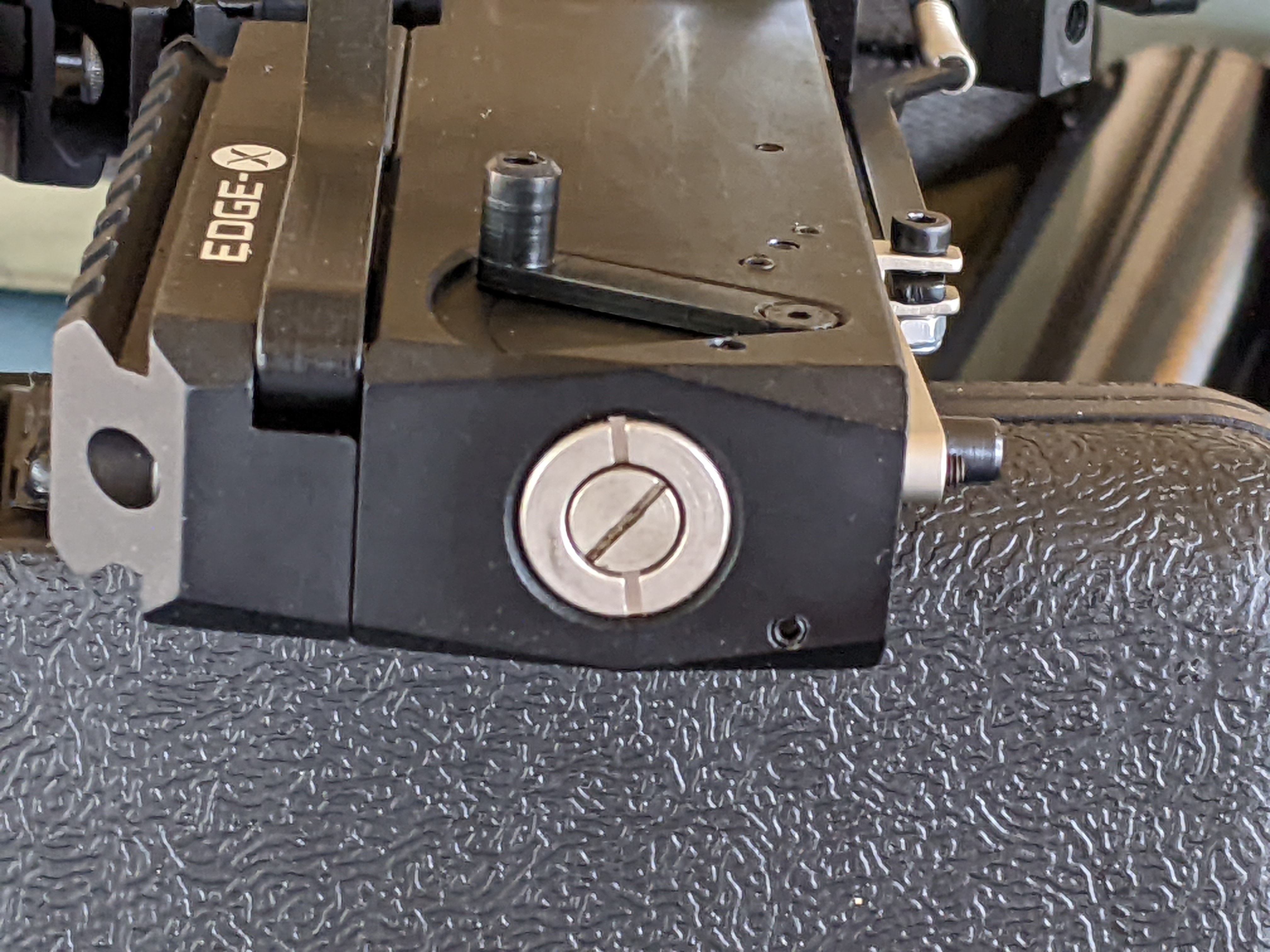

The hammer spring adjuster. I had it as low as possible, but it's a strong spring.

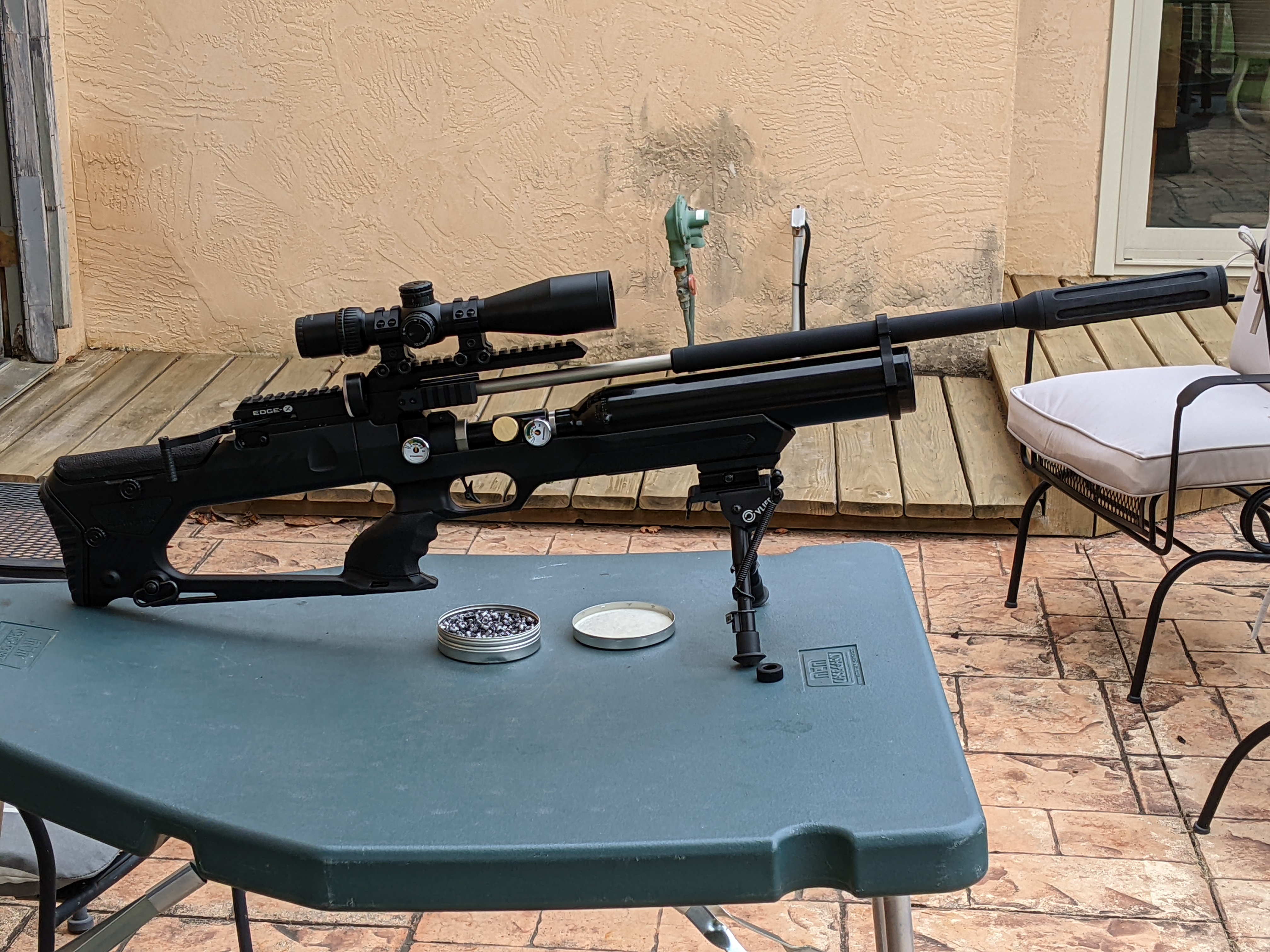

The gun, assembled and with moderator attached.

I let the air out of the gun by removing the air bottle and cracking the regulated pressure gauge to let the air out of the plenum. That did take the pressure off the external regulator knob, and made it easy to lower the regulator's set point. I turned it 1/8 of a turn, and that lowered the regulator's setpoint from 150 to 125 (ish). In turn, that lowered it to 885 fps, wide open. Close enough.
The hammer spring was backed out almost all of the way, right out of the box. There was about an 1/8 of a turn out before it stopped. Starlingassn has directions on how to get to the hammer spring. For .22 target shooting I think it might be a little too much spring.

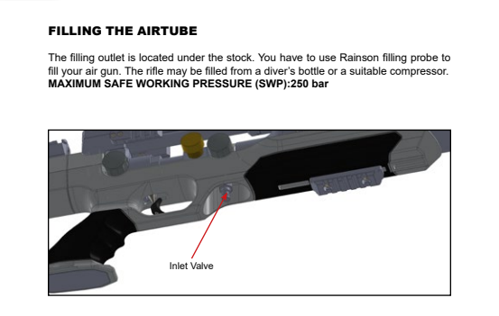

The gun's max pressure is 250 bar. The bottle side gauge has that max pressure marked.

you said your gun fills to 250bar,
and i see the gauge showing it as the fill pressure.
but mine shows a 200bar fill pressure.
hmmmmm,ill have to call ares and ask them what's up.
I bet they stuck a regulator gauge on at the factory by mistake. Manual says 250.
ahhhhh,mine says 250bar in the "user manuel" also.
