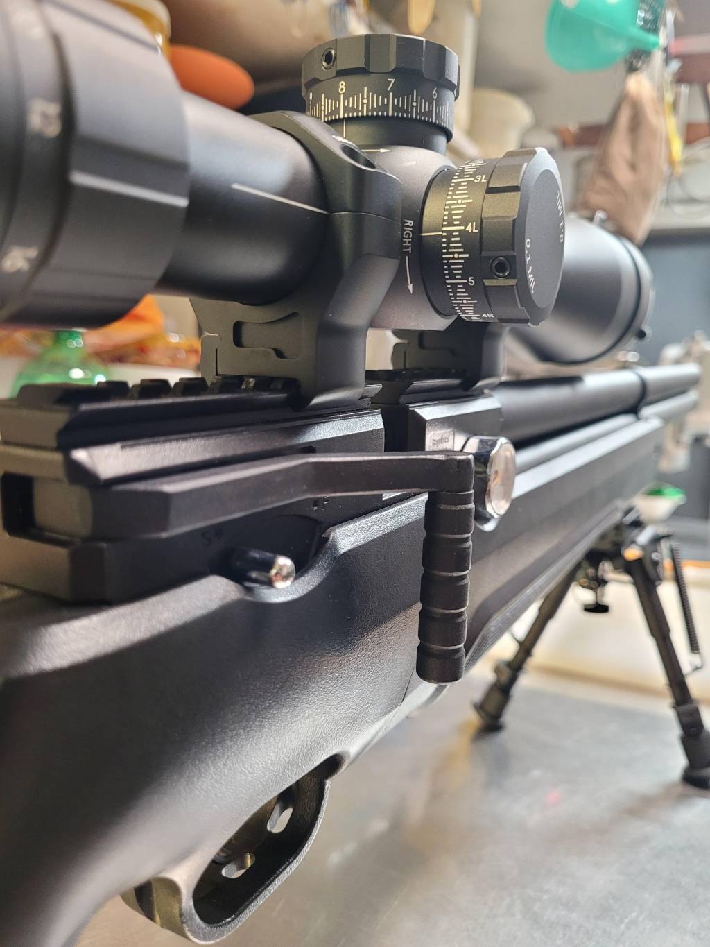

Somebody else just posted the same problem about an avenger doing the same thing.Yes You will need adjustable scope mounts.Some people even Shim their scopes. But sometimes you can dent the scope tube by doing that. I’ve personally had mixed results with shimming. Another thing you want to check for is to see if the scope mounts are leaning to one side. Some of them will do that. And if they do just flip them around and remount them. That worked for me on a gun One time.
Usually, people run out of elevation adjustments but you shouldn't be running out of windage adjustments. That's mostly a sign of the scope rail not being true to the receiver and barrel. Get adjustable rings or get a new gun of higher quality.
Some others here reported finding "flashing" under the picatinny rail which mis-aligned the rail itself...Flashing I think is sloopy finish work on part of the manufacturer...this one owner sanded the flashing off and all was well. I chose to shim my rear mount because I have done so in the past with success.. this was before I learned about the "flashing".

So there are several different things which might be going on:
1) Scope mounting rail not true/centered on barrel;
2) Scope rings themselves not true;
3) Scope rings not attaching to rail in a centered fashion.
One quick thing you may try is to reverse the scope rings from how you have them now - Move front ring to back and back ring to front. You can also try reversing how the scope rings are mounted to the rail (if the mounting bolt head(s) are currently on the right side of the rail, turn them around so that the bolts are on the left side of the rail).
Try these quick things and you may find:
1) No difference whatsoever (then the rail is not true, or how the rings mount to the rail isn't true - maybe due to flashing as called out above);
2) Run out of windage adjustment in the opposite direction - bad rings; or
3 Maybe reversing some things centers the scope better.

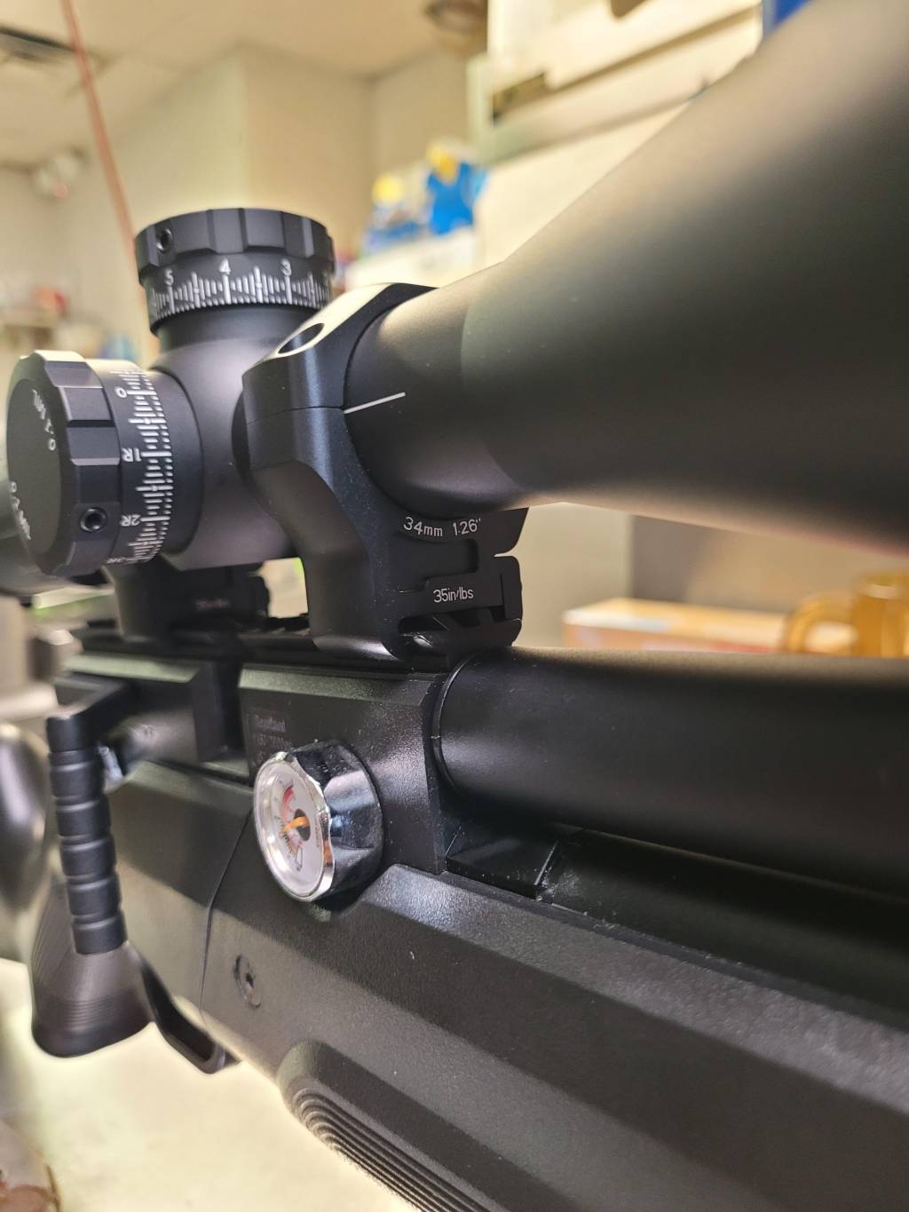

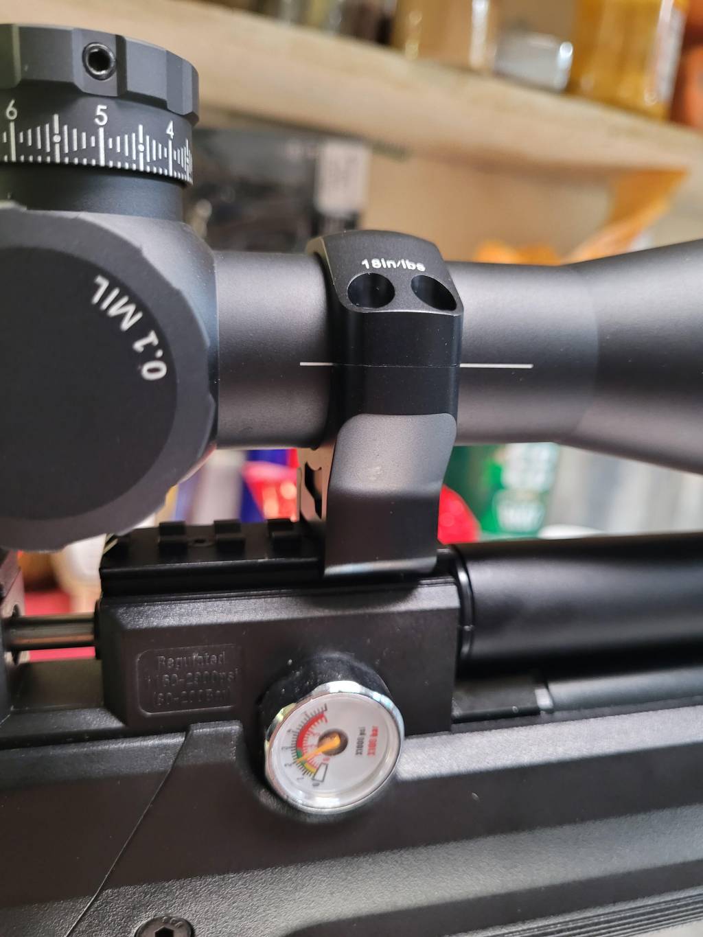

TNP, what torque did you stop at when tightening the rings? It seems suspect that you have no gap at all between the top and bottom halves (at least from what I can see in the pictures.) I'm wondering if you may have over-tightened the rings and damaged your scope.
-Clayton
I noticed that too. I’ve mounted many scopes for Over 45 years and always had at least a little bit of gap.
-Clayton
My Hawke scope mounts I had prior to these had the gap on both sides when screwed in to the right torque but both my arken mounts have barely to no gap when screwed to the recommended torque. The zeroing issue did not occur during the last plinking session with this exact setup so I'm almost 100% sure the scope is fine.
